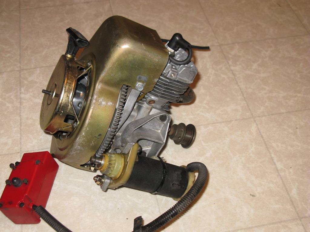

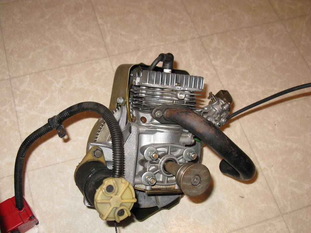

I have an 85cc engine from a snow thrower. It is heavy but I think in the end would be lighter than some 2 cylinder engines. The present set up dictates that the straight shaft end with the key way be used. Any ideas? Pictures of the actual engine then what the short block would look like.

Is that a two or four stroke and how does it get oil? Looks interesting.

Its 2 stroke. And I was wondering what model Walbro carb would work for it.

I would guess any of the "big bore" Walbro carbs. like 13mm. but you really have to experiment. What carb. was/is on it?

The carb on it is a Tecumseh I believe. But some of those were actualy Lawson (lauson) units I think.

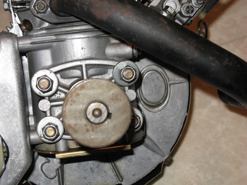

I have access to most any thing needed and can build it. Going to look into the bigger engines for carb info. Here are some pictures of the current one.

Looks like it might be a Tillotson carb on it. It doesn't appear to have a float chamber, so why not use the carb that's on it??

Tecumseh used that carb on the their four stroke lawn mowers, edgers, etc as far back as I can remember. I began working at my uncle's lawn mower shop starting around 1965 and they were using it at that point. It works essentially the same as the Walbro but has NO pump. It simply uses gravity feed to provide fuel to regulating side of the carb. All of the ones I have worked on in my career had a metering needle in the center of the carb body actuated by the diaphragm. The Walbro uses a rocker to transfer the diaphragm motion to the needle but that's about the only difference in the metering. I would think one could use a separate pump with this carb and have the same results as a walbro. Best of luck with the conversion and Happy Flying.
