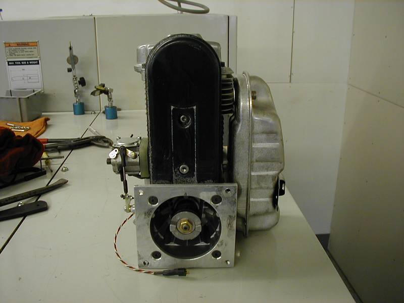

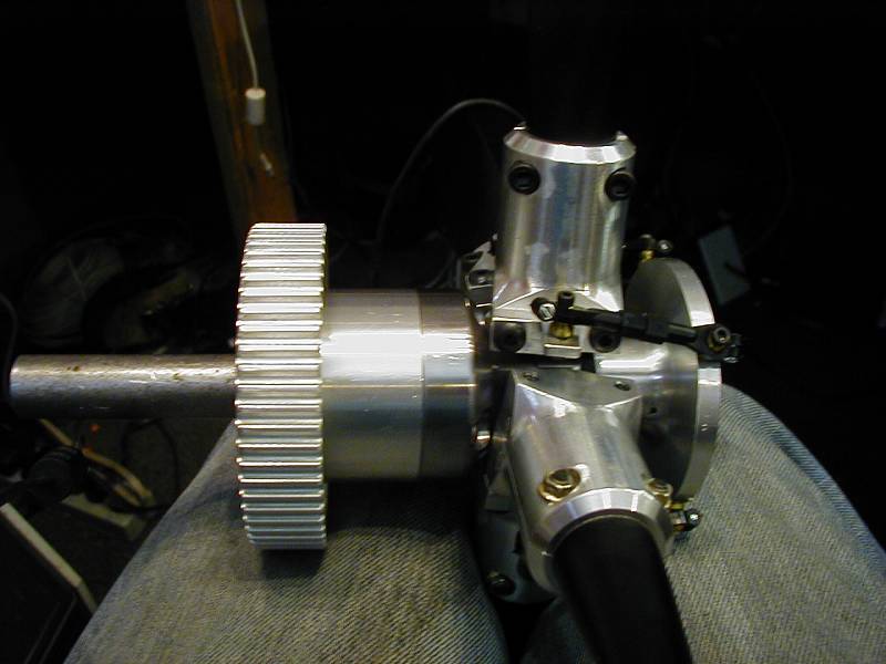

Posts: 14
From: Germantown, OH
Default RE: Shindaiwa 80
OK, here's a couple of photos of the beast.
Excellent work by Ralph, I can hardly wait to get this on the test stand and coupled up to the variable pitch prop system. I know it's off topic, but attached are a couple of snaps of that as well. Gotta run, will update with performance data when I get it!

Very easy conversion, the mounting plate bolts on where the pull starter was, the crank taper is the same as a G62, the G62 carb works fine...The casting was left on the front in case a mount was needed for the variable pitch prop mechanism...Ignition is C&H syncro spark, the sensor is in a ring pressed on the front of the case...
