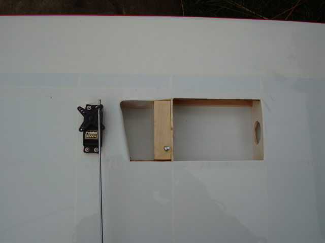

bombay door.

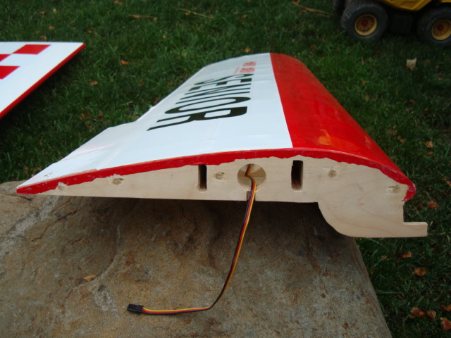

Scrapped the rubber band idea and made a wing joiner setup. worked out great.

I'll try to get some good photos of the wing system I did and get them posted. I know a picture speaks a thousand words. but I'll try to explain. As far as reinenforcing the wings, all I did was made a profile of the wing rib shape then added a tonge that sticks out the front. I made two of these. I made them out of 1/4 ply. Then I doubled the thickness on the windshield side of the fues and made a recieving hole for the tonge to slip into. on the back I did another 1/4 piece of ply across the fues and drilled and taped for wing bolts.

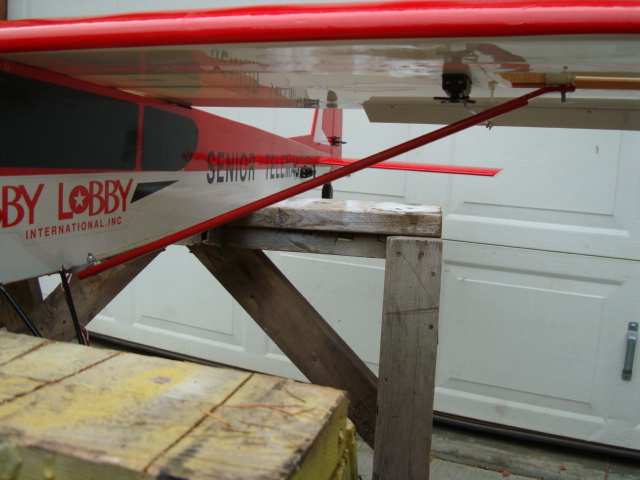

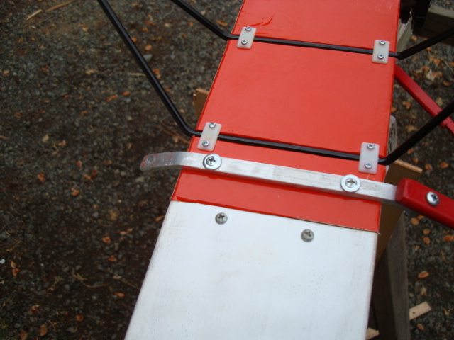

Yes I did wing struts, I didn't like the factory strut setup. It seemed to week so I took a piece of scrap aluminium 3/16 x 3/16 and fit it across the bottom of the entire fues, bent up the outside edges to match where I was mounting the strut to the wing, As far as the little block of wood that is inserted in the wing from the factory I had one split out on me the last time I flew. So now I cut the covering away to expose the little block and removed them. I replaced both little 1" square blocks with a piece of pine that spans between the ribs. It should be much stronger. they measure right at 3/4 thick 1" wide and 2/12 long. glued in on three sides. I'll get some photos of that to. I haven't recovered it yet.

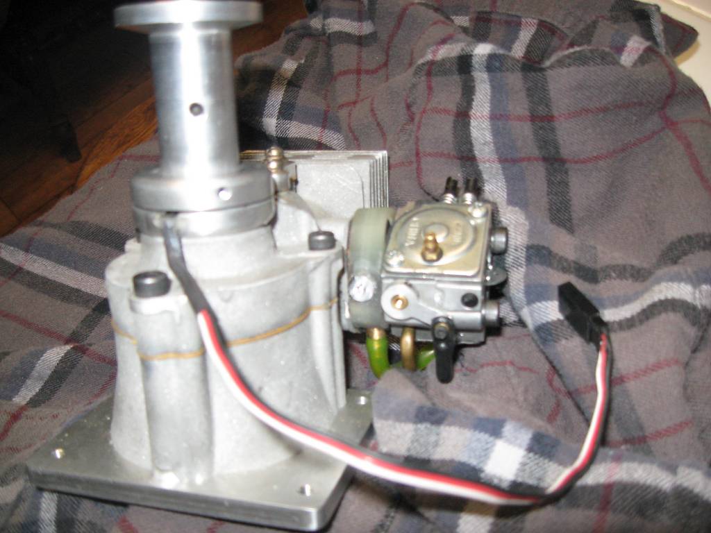

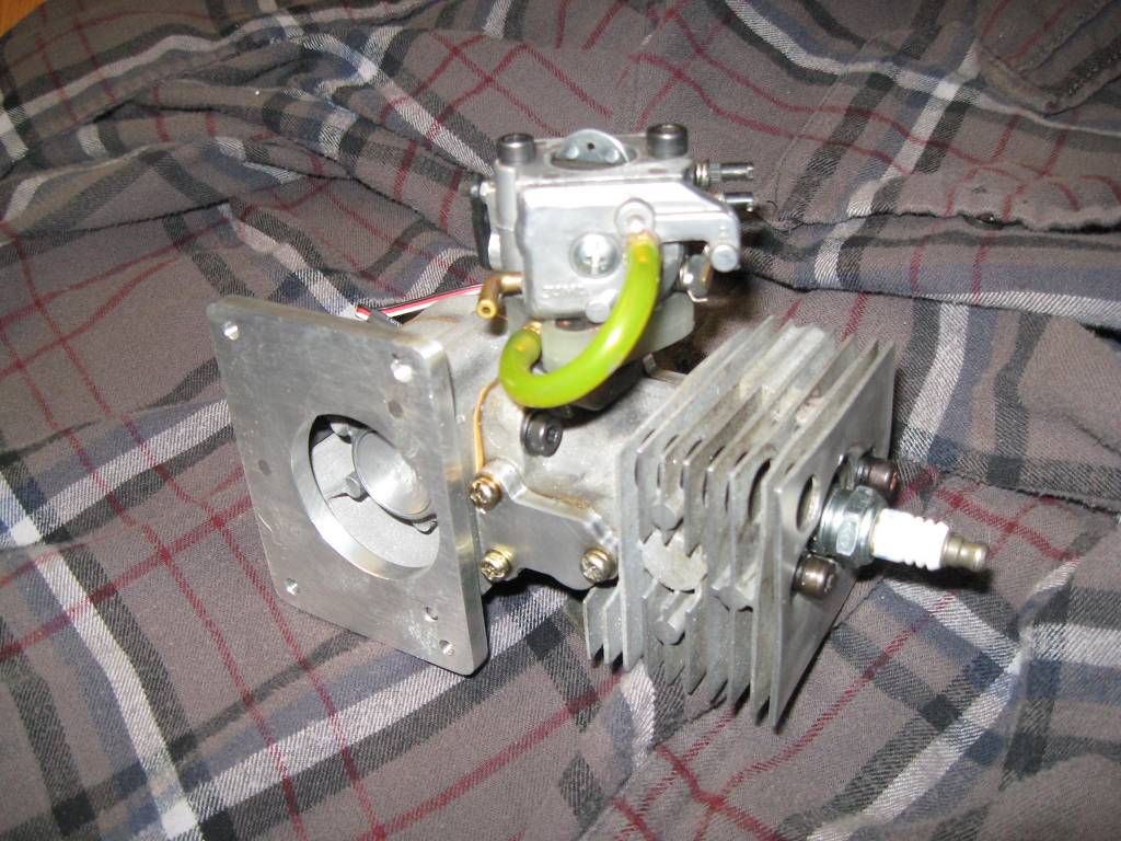

Your using the stock carb?
Are you still using the rubber hoses and the side ports to?
Here is mine.

Yes, so far I haven't modified anything on the motor. I am using the 2bbl carb and side ports. If I change carbs it looks like you just blocked off the 2 side ports?

That's what I've done.
I don't have any video of it running, but as I've said it runs very well.

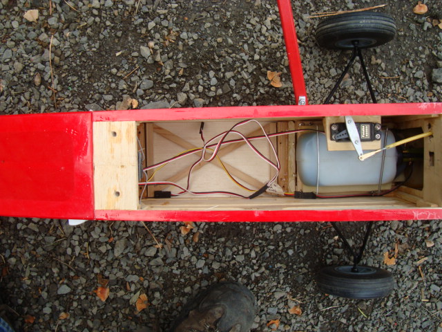

here are the pics flathead asked for

here are pics of the strut setup

Try this .... Make 2 gaskets for the side ports with out holes for the port.
See if that makes a difference.
To run as is you may need the stock muffler and air cleaner.
That is what the Carb. is set up for.
There was a Toro forum on here where all the ins and outs were discussed.
