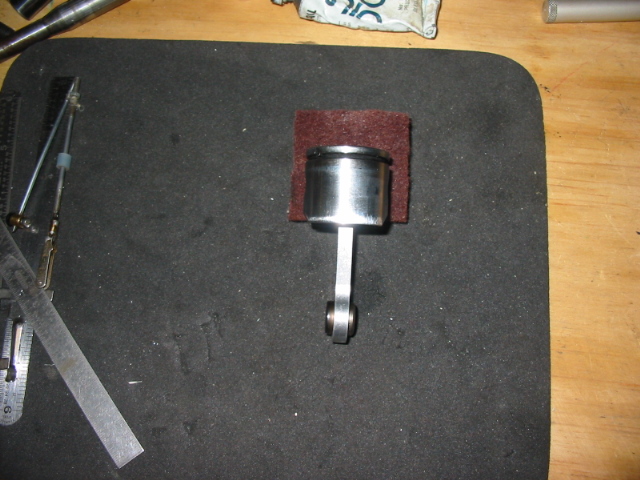

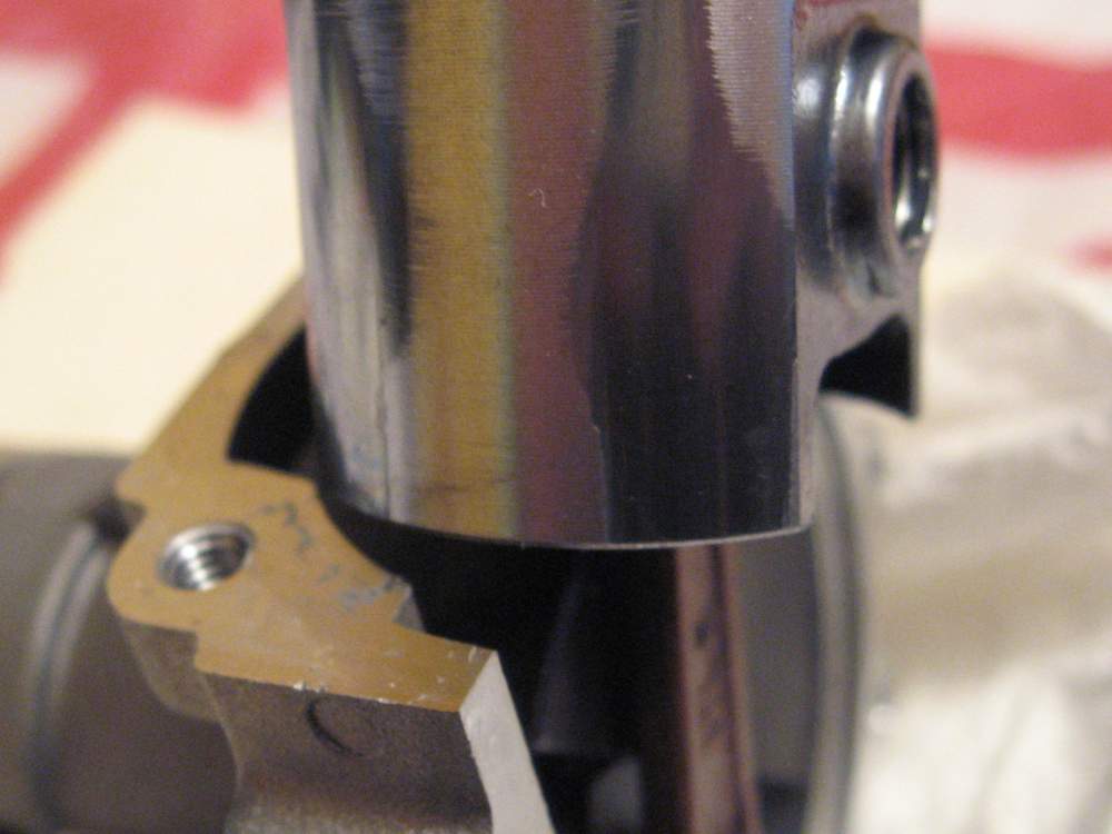

HI Guys: I was wondering about this piston I posted a photo of a DLE30 piston(not my engine) below. How may used engines have you found with this (SPS) shiny piston syndrone condition. On same piston seems like some galling or whatever. This is a DLE30cc piston with not very much run time at all. I myself have not found anything quite like it. I did find scratches in bore & on piston from hard carbon and maybe a broken ring. I know some of you guys have seen many pistons since you do engine conversions. let us know what you have seen or come up with. Thanks Capt,n
I have seen thousands of pistons...I worked at Continental Motors for 34 1/2 years. I want to hear your take on the manufacturing process. Also worked in the engine experimental Lab. In fact as a hobby I worked on about every kind of small engine you can think of, because I like em. Capt,n

The machine marks have been worn right off, seen that on a lot of high milage lawn tool engines, not on something that is supposed to be low hours.

So how did your bore measure out? Measure the piston to see how things look. Is the shiny surface wear or is it a dud forging where the unmachined areas got polished in the deburring tumbler? You'd probably get more response from the Gas forum.

this is the gas forum.
shiny surface is from too tight clearance, either bore or piston or running in a plain bore thats tight
btw glow liners should be tighter at the top than the bottom so your engine is probably shot or your measuring equipment is shot

I was wondering why you took a new engine apart?
I believe glass beading the piston would do the trick.
It would give a surface that would hold oil.
If the piston was too tight in the cylinder you could lightly sand it and then glass bead it.

Hi Ralph. It was not my engine that was took apart. I posted the photo (of another piston) to see if anyone else seen a piston like it. I was tinking of just pulling the jug up a little off the case just to see the total piston. It is running to good, so I decided not to take it apart. Capt,n
With the original piston picture, your assuming that they knew what they were doing in the first place
. To me it looks like the piston was small enough in diameter(bad casting) that the lathe could not clean it up, so they polished out the other imperfections like casting flash.

thats not the case, they wear like like that.

Who knows what really happened with the piston shown without having the entire engine to inspect and measure, but most often times wear (and sometimes seizures) at the four locations such as can be seen in this picture is due to revving an engine before it has had a chance to warm up. Pistons aren't machined round; they get that way after they have reached operating temperature. (Hopefully.) When an engine is revved up and/or loaded before it has warmed up and the clearances have optimized, they experience wear in abnormal ways and locations, and usually fail "before their time"....

Some pistons are machined round, and some are cam ground & I am sure there are other ways. Basic pistons are turned on a machine just for that size & type.....and round. Pistons for a very tight clearance (ABC Glow engines) are sometimes finished ground. Pistons are sometimes made out of round,so when they warm up the fit in bore will be better. Capt,n
