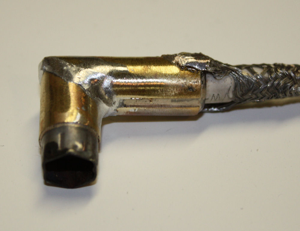

For this Saito gas conversion, I ordered from Paragon a 1/4-32 spark plug boot and shroud. (see pic). In this kit, they supply some solder. Paragon doesn't know what kind of solder it is, but I assume it's low melt silver soldera little stronger than regular 60/40 tin-lead. Anyway, no matter what I tried, I could not get this, or any solder to flow the two 45 deg chamfered shroud pieces to flow. Hi heat, low head, medium heat, flux, didn't matter. The solder would melt against the steel shroud, but would not flow. It would just drip off. Very frustrating. If I try even more heat, the silicone boot starts expanding and outgassing, ruining the joint by causing the two pieces to pull apart under pressure from the expanding boot inside. Paragon says I'm the first one to have a problem. Yeah yeah, I've heard that one before.
Anyway, here is my solution that worked fine: Sheath the steel with brass. Find some K&Sbrass tubing (that I KNOW will flow solder), cut a slot so it'll stretch over the existing steel, and braze it on. This works because the silicone boot is not present at this time. Sand and clean it, then sand down the extra protruding brass to reestablish the original 45 deg angle.
Now, just reassemble the whole thing according to the original intent, but now I'm soldering a favorable material - brass. Flow is no problem anymore. Here's some pictures:

I've experienced your problem too.
There's no way to make a nice solder joint across the two original pieces. All you can do is have a couple gobs of solder on it.
Your solution is nice

stainless steel requires a special flux, it must also be spotless clean and a fresh surface (sanded).

After I read your post, I took a magnet to the steel plug shield provided by Paragon. The metal is NON MAGNETIC, confirming that it is a 300 series stainless steel. Very little, if any, iron, and lots of chrome & nickel. I'd have never dreampt this part would be stainless steel. Talk about overkill.
You're quite right, it takes s special flux to make this work. It probably would have been sufficient for RCEXLto use nickel or tin-plated carbon steel, thus providing corrosion resistance along with solderability. That combo works for the shields for the larger plugs, so why do something different for the 1/4-32 plugs????
The worst part is the Paragon kit contains no instructions, and no mention of special flux. Research indicates the flux should contain hydrochloric acid, zinc chloride, and ammonium chloride. This is indeed a powerful mix. It's not hard to get, it's just silly for RCEXL, the makers of this kit marketed by Paragon, to not fully inform their customers.
TKG thanks VERYMUCH for your information!<font color="#292526" size="3" face="Arial"><font color="#292526" size="3" face="Arial"><font color="#292526" size="3" face="Arial"><p align="left"></p></font></font></font>

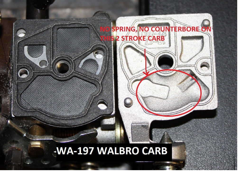

Does anyone out there have a good photo of the WT-456 carb, with the diaphragm cover off, showing the exact position of the 98-3226 spring?And the inside surfaceof the cover? And perhaps the carb body? The Walbro diagrams are so bad that it's hard to tell how the spring installs. Their diagram makes it appear as if the springassembles around the center screw,but that seems dumb.
It's quite clear that the carb shown on this Saito conversion (see previous photos)won't accept the spring at all. I have some other carbs in the drawer into which this spring might install, but it's not clear if the body or the coverneeds to bechanged to accomodate the spring.
In checking Walbro, there are a variety of diaphragm covers, all which looks the same (in their exploded views)yet have different part numbers. There could be a wide variety of differences, some of which may be there to accept that spring.
With a lot of money, one could just by a bunch of carbs and become a degreed expert. The next best thing is to use the forum. Thanks.

I have a Walbro WYD four stroke carb and it does not have the center screw on the pump cover. The screws are on the side like on the regulator cover

The WT-456-1 arrived, and it's new in the box. Clearly never been used. For those interested in an Ebaywalbro sellerwho is responsive, his Ebay name is captneversail. Give him a try.
Besides getting my Saito conversion running correctly, another goal has been to understand (IN DETAIL) what Walbro did to their existing designsto marketthe intake-pulse-only carbs for 4 strokes. This 98-3226 spring is obviously a design mod rather than a clean sheet 4 stroke design.That opens the potential for budget conscious modellers to convert existing carbs to 4 stroke. The carb is $37. The spring is47 cents. Duh. It looks like the only difference is the diaphragm cover, and it only differs by the machining of the little flat bottom counterbore (see photo). The 4 stroke cover on the parts listis obsolete, but there's a replacement for $2.50. To save time or money, one could machine the old cover. The counterboreis .380" diameter, and it's .045" deep as measured from the cover mounting surface. (not the gasket ridge, but the surface just outside of that). I think this could be done on a drill press if one clamps everything tightly. Just grind the angle off the tip of a SHORT3/8 drill. It should be short to keep the drill from chattering. Grind a clearance angle behind the two cutting edges on the drill.
In the two photos below, one is a non spring-assisted 2 stroke carb, and the other is a known 4-stroke carb, the WT-456. This was used on RyobiAC trimmers. This isa line of 4 stroke products called "Air Clean" to address mounting critisizm from the greenies about 2 stroke pollution. They even made their engine designs open source forothers to copy,ostensibly toforestall government regulation. I'm showing both carbsto illustrate where the parts are common, and where they differ. And also to show how the WT-456 4 stroke spring assembles. Maybe there are other differences, but I can't find them if they exist. I add that as a caveat to innoculate myself against anyone yelling at me for an incomplete analysis.
