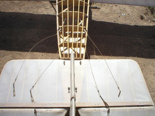

Removable tail,can also be adjusted for trim.

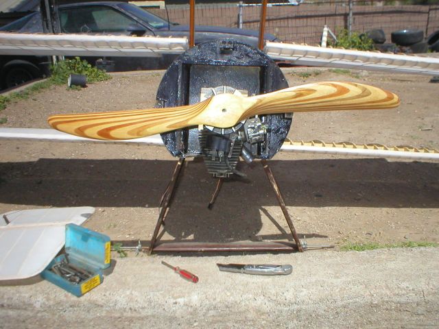

Quadra 35.
Display wood prop.

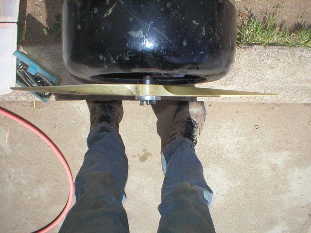

One pic shows how close prop is to cowl.
Setup for Pull/pull on elevater is a straight rod,then a piece(horn) soldered on to rod,then another small horn soldered on for rod to servo.

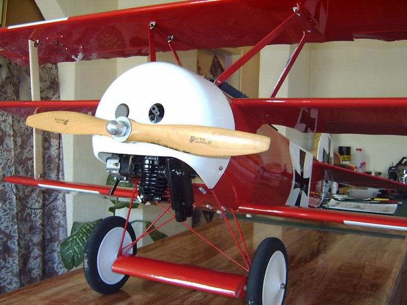

Wow!! Very cool, and a lot of very nice work. I never knew that the Sopwith Tripe had ailerons on all three wings before. That's cool, but I bet there is going to be a ton of adverse yaw. Nothing some good rudder work and/or rudder mixing couldn't take care of though... Keep us posted please!!
Time to get my "Red Baron" Fokker Dr1 tripe out and dust it off, check the tank, carb, etc. It has an Echo 23.6cc engine on Gas/Glow, and flies great. It has been greatly neglected and sitting like a "hangar queen" for a couple of years however...

Actually, I have a nearly stock 23.6cc Echo in my Fokker Triplane. It turns a big old wide blade Top Flite 18 x 6 at around 7500 rpms, which is perfect for the plane. The souped up 23.6cc is in my Katana. Turns an APC 16 x 8 at well over 9000 rpms.
