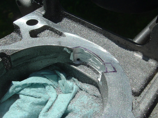

I tore down the engine to match the transfer ports to the crankcase and change the timing on the exhaust port.
One thing comes to mind about grinding the exhaust port. Isn't the cyl. chrome lined and won't grinding the port cause the chrome cyl. to chip and peal as the engine runs?

Ooops!! Anybody looking to match the crankcase to the transfer port look out! In the front port the case material is very thin at one spot. Before I knew it I had ground a hole in the crankcase. I hope JB weld will fix it. Next time I will fill the depression with JB on the front of the case first.

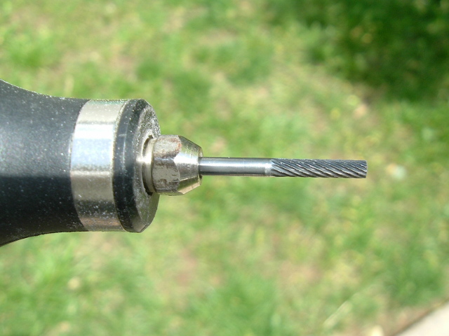

I am going to heed strong advise and add a second outlet to the muffler. I had to purchase another muffler though, because adding a second outlet to my existing one wouldn't be the right configuration for the test stand or a plane. My intent is to install an 11mm carb on an enlarged intake and message the cyl. port to match as well. So everything should be up to the task.
Just so I'm crystal clear, because now I'm real nervous about grinding on the exhaust port, after goofing up the case. Is the cutter pictured the type of carbide cutter to use on the port?
#60
Yeah, that looks fine and similar to the one I use. Just use a light touch as it will remove material quickly. By the way, where did you get that one? Mine is about due to be replaced and I've had it so long I can't remember where I got it.
