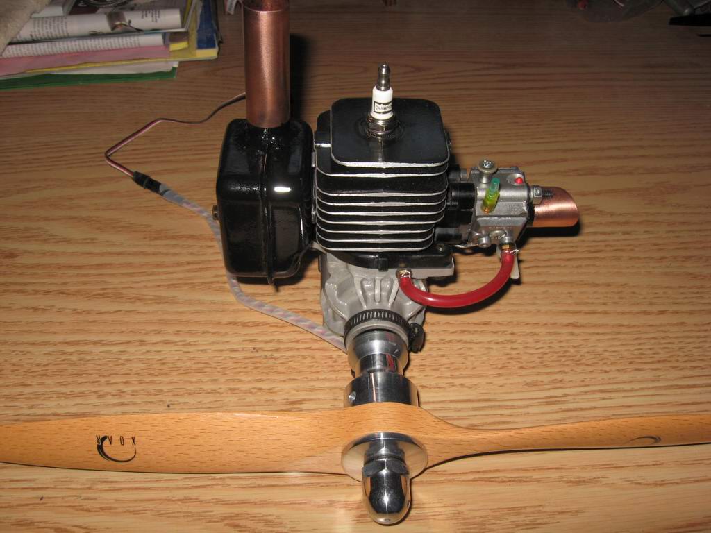

Finished up the new Homelite 30cc. It has the newer cylinder with larger transfer ports, plus I did a bunch of hopping up. (Porting, etc.) But I kept the port timing fairly reasonable this time. It will be interesting to see how it runs. Won't have time now to test run; maybe in about a week.
It came out kind of nice looking I think.
AV8TOR
