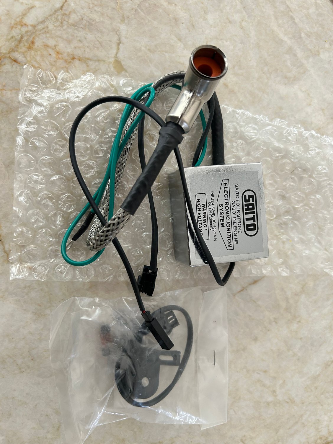

Bernett 04-03-2026 04:49 AM
The CDI that I use is from Stirlingkit. It’s light weight and only $20. It doesn’t have a timing curve. I have used it for converting weed wacker motors and in planes with those motors and never had a problem with their reliability.
I also have three Saito CDI systems that are two wire systems. They use an inducer to signal the CDI not a hall sensor. I’m trying to sell them on EBay and nobody wants them so I took a crack at converting the unit to a hall sensor. It didn’t work but that was probably because I don’t know what I’m doing. I was following AIs instructions and will need to try again.
I appreciate the suggestion to use something other than the esp32. My brother is familiar with that and should be able to build something that can retard the spark at certain rpm’s.

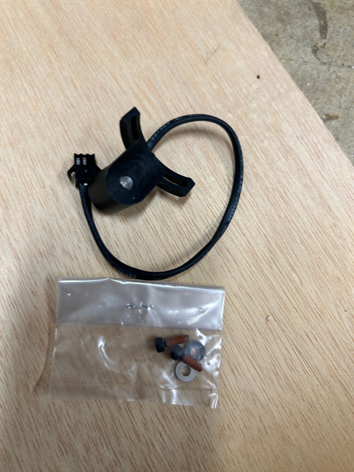

cmulder 04-03-2026 02:51 PM
could you post images of the saito cdi?
Originally Posted by Bernett (Post 12832176)
I also have three Saito CDI systems that are two wire systems. They use an inducer to signal the CDI not a hall sensor. I’m trying to sell them on EBay and nobody wants them so I took a crack at converting the unit to a hall sensor. It didn’t work but that was probably because I don’t know what I’m doing. I was following AIs instructions and will need to try again..
Could you post close ups of the cdi and the sensors ? Depending on the parts used it might be possible to guess what signal the cdii expects to fire.
Bernett 04-03-2026 04:06 PM
https://cimg3.ibsrv.net/gimg/www.rcu...d300af142.jpeg
https://cimg4.ibsrv.net/gimg/www.rcu...1fdc8e704.jpeg
https://cimg5.ibsrv.net/gimg/www.rcu...162b0773b.jpeg
Here are the photos. This is a two wire trigger mechanism. I understand it to be an induction type trigger. Hall sensors are three wire triggers.

cmulder 04-04-2026 02:49 AM
Do you have a multi meter?
DO you have (or can borrow) a multi meter?
Use the continuity test(beeper sometimes combined with diode test) to do some checks.
The metal spark plug cap, the braiding and the ring at the end of the green wire all should be connected with each other.
So the meter should show beep when the lead "probes" are touching any combination of those 3 but the most important is from the cap to the ring.
Then next is to confirm the pickup probe ; the 2 contacts should also show continuity and if they do also do a resistance check.
If you can bribe a assistant then another test is possible.
One person holds the lead probes on the 2 contacts on the connector and another moves a magnet quickly past the sensor.
With the multi meter set to its lowest voltage setting (direct current is best) then it should show a voltage the moment the magnet passes the sensor.
That would confirm it is in fact a coil and that the coil is working.
Connecting a 3 wire hall sensor to this system would not work because a hall sensor needs power to work.
This is usually the red wire and that is missing here.
Once conformed it are coils and they are working AND the cap, braiding and ring make contact you could try to make a spark-plug spark outside of a engine.
Before you power the cdi measure if the outside of the plug, cap ect make contact and then power the cdi and move a magnet past the sensor to see if that triggers the cdi to fire,
That way you know at least that the system is working as designed,
After it should be possible to design a "in between" circuit that takes a hall sensor signal and then generate a voltage like a coil would do.
Also these saito sensors look like the os sensors that are designed to be mounted in the backplate and use the passing crankpin as signal.

I have tested the Saito CDI and it generates a spark. I did try a circuit with a hall sensor and transistor but it didn’t work. I may have messed up my hall sensor but I have lots of them. I’m going to try again and do a better job of setting up the proposed hall sensor circuit. Thanks for the suggestions.

To convert a 3-wire Hall sensor to work with a 2-wire inductive (Variable Reluctance/VR) input on a CDI, you must transform a digital square wave into an analog-style pulse. This is significantly more complex than the reverse because most 2-wire CDIs (like older Saito units) expect an AC signal that crosses zero volts to trigger the ignition.
Conversion Options
1. Professional Signal Converter (Recommended)
The most reliable method is to use a dedicated signal converter designed for motorsport. These units are built to take a Hall effect signal and output a simulated inductive pulse that your CDI can understand.
  • KMS Hall & Inductive Converter: This device from Kronenburg Management Systems (KMS) is specifically designed to convert Hall sensor signals into inductive signals for ECUs and ignition systems.
  • Speedway / Motorsport Converters: Look for "Hall-to-VR" or "Digital-to-Analog tachometer converters" from specialized retailers like Summit Racing.
2. The Capacitor Coupling Method (DIY)
If you want to build a simple interface, you can try "AC coupling" the Hall signal. This tricks the CDI by turning the Hall sensor's 0-5V square wave into a brief positive and negative spike.
Components needed:
  • 10k \(\Omega \) Resistor: Pull-up for the Hall sensor.
  • 0.1µF to 1µF Capacitor (Non-polarized): Blocks DC and passes only the "edges" of the signal.
Wiring:
  1. Hall Sensor Power: Connect Red to +5V and Black to Ground.
  2. Pull-up: Connect the 10k \(\Omega \) resistor between +5V and the Hall Signal wire (White/Yellow).
  3. The Converter: Connect one leg of the Capacitor to the Hall Signal wire.
  4. To CDI:
    • Connect the other leg of the capacitor to one of the CDI's trigger inputs.
    • Connect the other CDI trigger input to Common Ground.
3. Important Considerations
  • Signal Strength: Some 2-wire CDIs require a high-voltage pulse (several volts) to trigger. A 5V Hall signal through a capacitor might be too weak. If it doesn't fire, you may need a small transformer or an op-amp circuit to boost the spike.
  • Timing Shift: Converting signals can introduce a tiny delay or shift the trigger point (rising edge vs. falling edge). Always re-check your ignition timing with a strobe light after making this conversion.
  • Polarity: If the engine doesn't start, swap the two wires going into the CDI trigger input. Inductive inputs are sensitive to the direction of
This is a AI suggestion. It is not the same one I got earlier. I need to investigate this further.
xanaphyst 04-04-2026 06:37 PM
Wouldn’t you just use a unipolar hall sensor so it’s expecting a single magnetic pole for the high / low ??

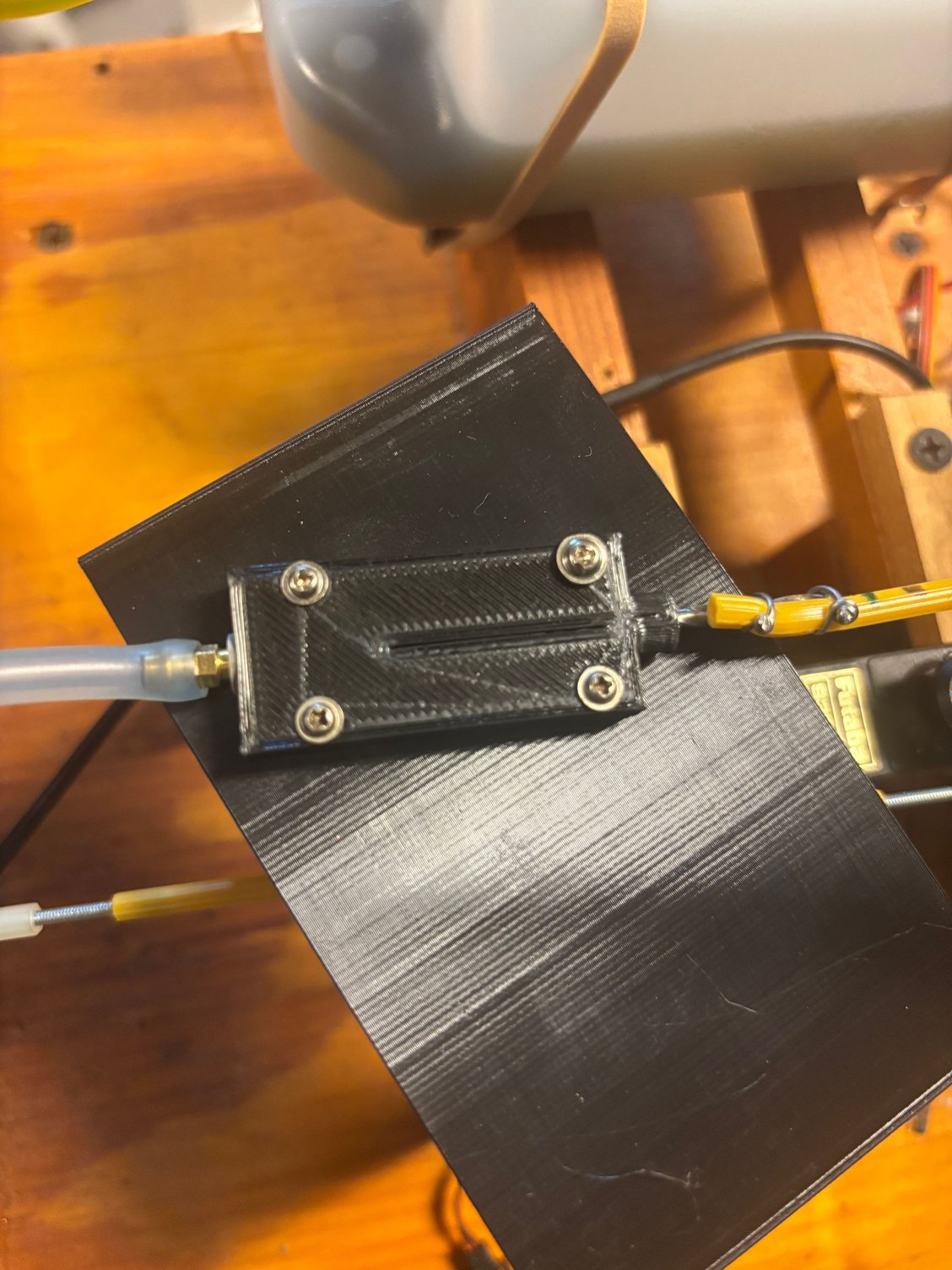

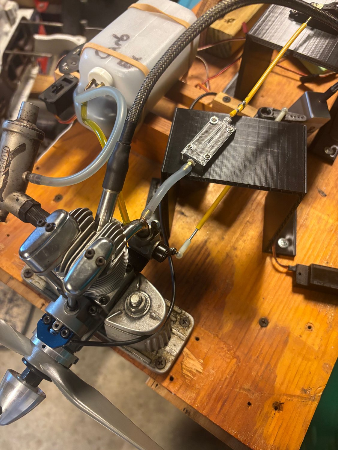

I’m not having much luck getting my Saito 72 dialed in on gas with an external air valve. I can’t seem to get any consistency at all.
