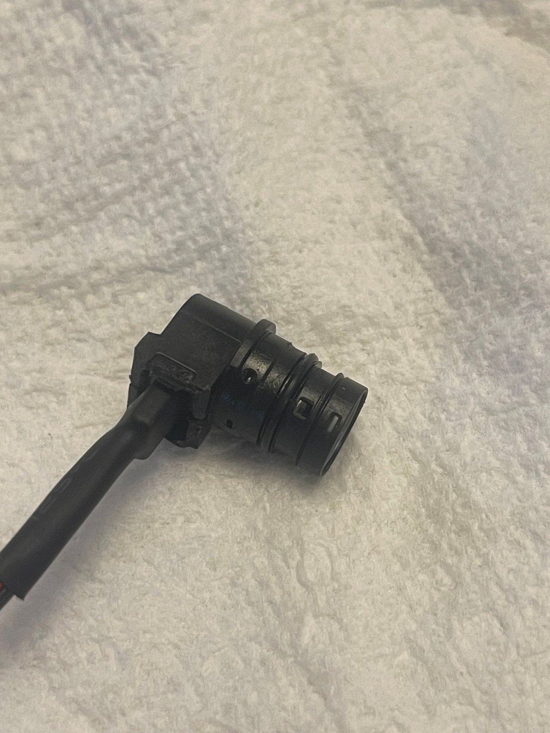

Here is a video of my printed solenoid holder bubbling away on the .15 LA. You will see a crank case pressure line but it is plugged and I’m just using muffler pressure. In the video the solenoid is running at 89% duty cycle, 30hz.
https://cimg9.ibsrv.net/gimg/www.rcu...984b70486.jpeg
im not sure how this is happening but i tend to blame dimensional inaccuracy of the printed part. I am going to work a bit more on this until my CNC shows up then I’m machining it if my skills allow me such a feat…
I want to make sure I understand this valve as I modify my sleeve design and such. The two lower sections are obvious. The third section though… there are little indentions near the top. What are they for? Could this be a source of air getting into my system? This is right next to the spot where my supports hold the part to the print bed so dimensional accuracy is worst here. I can orient the part differently and try again but I want to ask if those holes are anything more than snap points for assembling the solenoid.

It looks to me, that what you see is normal cavitation caused by the valve. leakage usually tends to produce larger bubbles directly at the spot of ingress. That has to do with surface tension: Bubbles need to reach a certain size before buoyancy overcomes the surface tension and the bubble rises upwards.
Cavitation bubbles form IN the liquid and can be (and usually are) much smaller, like we see here. The reason it shows up so clearly, and how it collects close to the inlet of the carb, is most likely a combination of unfavourable conditions:
-Your engine has a very low fuel consumption.
-The piece of fuel tubing between solenoid and carb is fairly long. those two factors combined, my estimate, given engine size and RPM, is that fuel spends at least 5, maybe 10 seconds in that piece of tubing.
- that piece of tubing also is vertical.
The low fuel consumption combined with the rather long piece of tubing, and its vertical position allows the minute bubbles formed in the fuel to collate (cling together), gain in buoyancy, gain in vertical velocity, promoting further collating. and due to the low flow of the liquid, collect in the top and remain stagnant there.
I think you will allready see a significant improvement if you shorten the tubing between valve and carb to "as short as reasonably possible" and route it as horizontal as possible.
If you can find it, use the smallest inner diameter in order to minimize the time fuel spends in the line, and to improve the ability of fuel to carry the bubbles along.
I noticed you are running glow? Keep in mind, you will have much less control over ignition timing, and the little you have, comes from mixture strength, meaning the exhaust residue will be rather dirty, which is an issue if you do not use an effective craptrap in the muffler pressure line.
1967brutus 11-01-2024 06:40 AM
Forgot to adress this... The upper "chamber" above the O-ring has no real function other than provide the propere depth for the needs of a Stihl M-tronic carb, and can be ignored.
The holes most likely have to do with assembly or manufacturing, I would not know to be honest.
It is NOT a source for air: as said, IF there is a leak there, fuel should flow out with the checked crankcase pressure you applied previously.
chemnut842 11-01-2024 07:24 AM
Very interesting. Then why not mount the solenoid directly to the carb?
I won’t be able to print anything new to try until Monday as I took my resin printer to work (wet lab with fume hoods. Resin printing stinks and uses solvents and stinky resins - I didn’t want it in my house). I can link the current solenoid housing directly to the fuel jet with a 10mm or so section of tubing. It will sit vertically and be more or less connected to the carb.
also I can try this housing and solenoid on my MVVS .77 which gulps fuel compared to the .15.
hey if this is just normal cavitation then a printed housing is feasible.

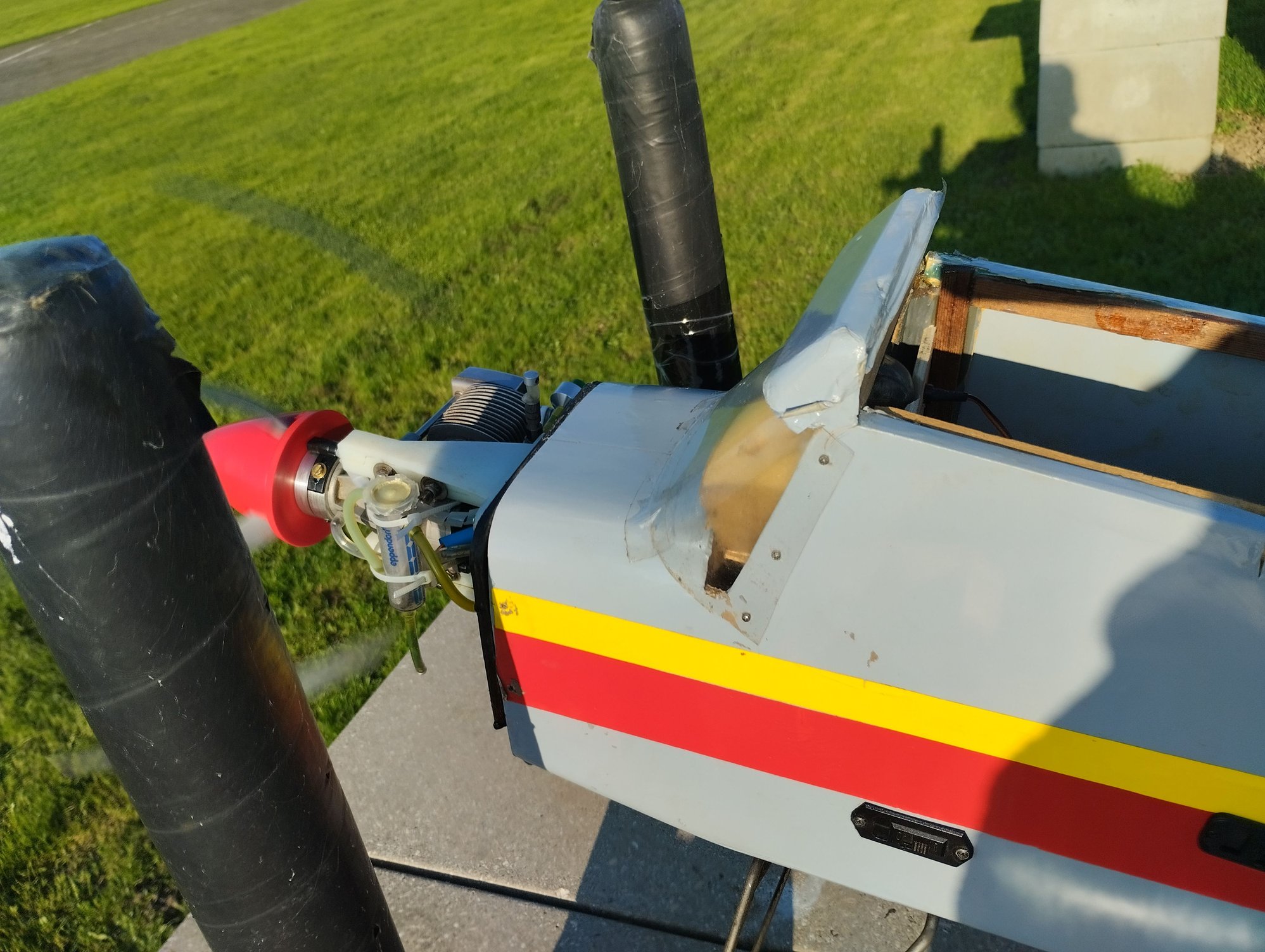

Dear all, today was a very good day for my gaser! 😁
I flew all the day with my trainer, swap from the 25LA to the 40FP, and the 40FP run so well with the solenoid (compared to 25LA where micro bubbles come from the cavitation of the solenoid and become big bubbles and kill the engine after one minute).
So, one more time thanks a lot to all guys which develop this solution!! (Berts, Raleighcopter, and all other)
One question, this morning my solenoid curve seems to be too rich, and this afternoon maybe a little too lean, do you observe this little change on air/fuel mix ratio during the day on your plane? Normally the BPM280 must correct this little variation, isn't it?
​​​​​See ya!!

Thunder tiger f91s. Gas efi conversion
