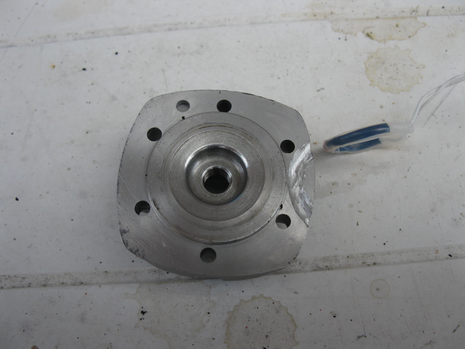

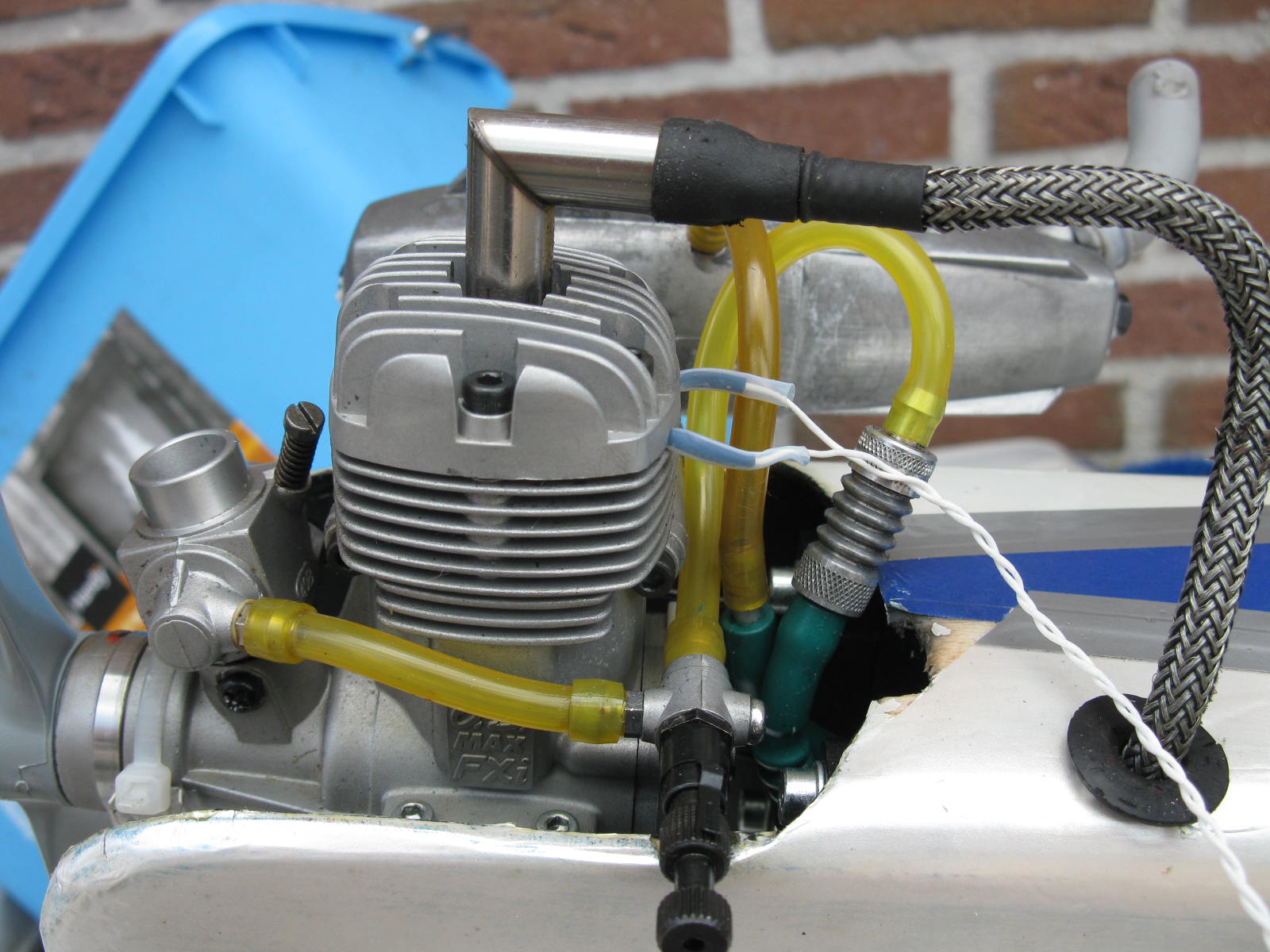

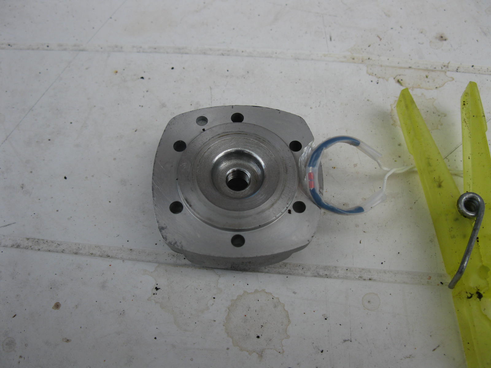

For 2-atrokes this is usually the best way to fit the temperature sensor...
Attachment 2274623
Attachment 2274624
Attachment 2274625
Nice, i have all the informations i need thanks

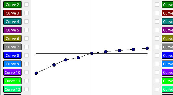

Ok, I have since realised that "play value" can be selected in the Special function that applies, most likely as activated by a logical switch..
Old man asleep at the wheel ..again! :D
I set up my curves, both fuel and throttle, to have 9 points, so each point on the curve corresponds with an index mark of the stick.
I have several times made the mistake of NOT doing that, and it makes it near impossible to set a decent curve, if you do not .............. Engine RPM, exhaust note, etc, don't change
It really pays off here .................
Why does the "smooth" box check, as below, not make that unnecessary? Any arbitrary position along the curve should be accessible and adjustable, should it not?
As I understand curves, this is the very reason "smooth" is an option. The "points" are only required to set up a actual digitally programmed curve response which functions, as it should, at any position along it's trajectory. Any of these might be between the set up "points".
While writing this, I am aware there is something fundamental I must be missing, because I have encountered this before, but never asked questions.
If so, please set me straight on this?

1967brutus 11-07-2024 04:12 AM
The smooth function only "rounds the curves". Unchecked, the curve consistst of straight lines connecting each point, cheecking the smooth box makes it a smoother line with "turns" instead of "angles".
Checking the smooth box does NOT allow for setting any arbitrary position inbetween points.
Glowgeek 11-07-2024 06:41 AM
Yes that's correct, Jim. You can't make adjustments between points....BUT....you can relocate the points. I group my curve points such that they are closer together where needed....eg in the bottom half of the curve, where throttle transition is more problematic. So for a 9 point curve I would have 5 points between idle and just below 1/2 throttle, and four points above half throttle. Alternatively, you can simply use more points eg 12 points.

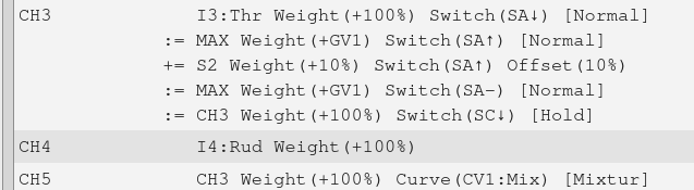

However, a resulting question arises in my mind, which is more of an OpenTx question than anything else.
If I use Raleighcopters "Gemini" model set up as an example, how does the output position of channel 5 determine when and if a OTX set up point is effectively selected for adjustment purposes via S2?

Glowgeek 11-07-2024 01:52 PM
Originally Posted by Jim.Thompson (Post 12809535)
Ok, I've got that now.
That explains a lot.......... I expect that I will be asking more questions about that later. Thanks.
https://cimg7.ibsrv.net/gimg/www.rcu...88909667a9.png
I haven't messed with OTX in two years, due to circumstances here. I also have not looked at Raleighcopter's code for his Gemini twin, however, that kind of looks like programming for a choke/fuel enrichment function? Not sure. We would need to know what GV1 (global variable) is set to.

Originally Posted by Glowgeek (Post 12809536)
.................. We would need to know what GV1 (global variable) is set to...........
It is set to -100. As per his full .otx file here: https://www.rcgroups.com/forums/show...&postcount=618
To answer your question about how to tell if the throttle is at a set point......you view that in the curve mix (CVx) on the curve channel page. ...........
What, do that while you are flying?
I suspect that I have been asking the wrong questions, as we appear to be talking past each other.
I will attempt to re-phrase my question:
The curve points selected in an OTX capable transmitter such as a Taranis et. al. are adjusted in the curves page.
How does the position of the throttle stick combined with the setting of S2 adjust one of the selected "points" on the smoothed curve in the curves page?
Can the adjusted (moved) point in question then be seen to be at a slightly different position when viewed in the curves page? (Page 7/12 in OTX/Taranis).
Should I move this question over to the OpenTx dedicated thread over on rcgroups.com?

Originally Posted by Jim.Thompson (Post 12809542)
The points selected in an OTX capable transmitter such as a Taranis et. al. are adjusted in the curves page.
Jim.
That indeed is a miscommunication, the throttle stick position in itself has nothing to do with the actual adjustment of any point in the curve.
The points on the curve are adjusted by moving the cursor to the value you want to adjust, and push the + and - buttons. Stickposition, or S2 both have NOTHING to do with that.
In order to set the curve at the points 1-9 (-100, -75, -50 etc etc up to +100), the engine has to be operated at these points as accurately as possible.
When doing a testrun (testflight) in order to judge engine behaviour or to determine which point needs correction, "approximately midstick", or "approximately 1/4 throttle" are not good enough, I cannot stress this enough, being inaccurate here causes one to achieve different results from the same order of magnitude corrections, and you'll be chasing your own tail forever.
I don't know how to further explain this. All I can say is, that I HAVE been chasing my own tail quite a bit at times...
Jim.Thompson 11-08-2024 02:39 AM
Originally Posted by 1967brutus (Post 12809552)
That indeed is a miscommunication, the throttle stick position in itself has nothing to do with the actual adjustment of any point in the curve...........
I am much relieved to now know that I had understood it all incorrectly.........strange to say!
.............. S2 both have NOTHING to do with that............
Ok, understood.
But.....what function does S2 provide?
When doing a testrun (testflight) in order to judge engine behaviour or to determine which point needs correction, ....................
Ok. So then, assessment is only done during flight, then adjustment is only made when the plane is on the ground. (via S2?) Is this correct?
Thanks for sticking with me on this...it must appear that I am a bit obtuse......which is probably correct!
Jim.
