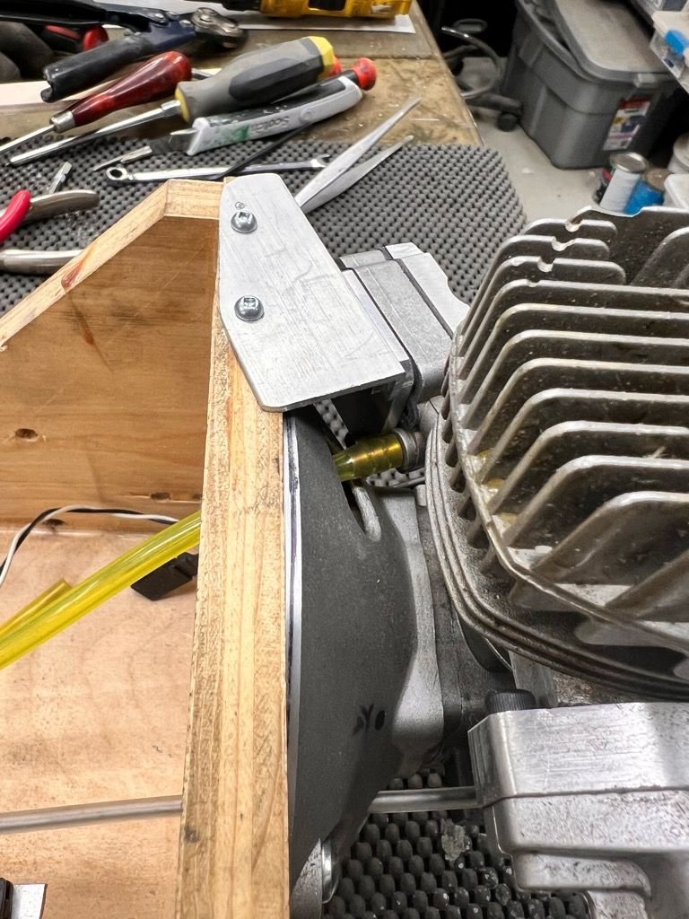

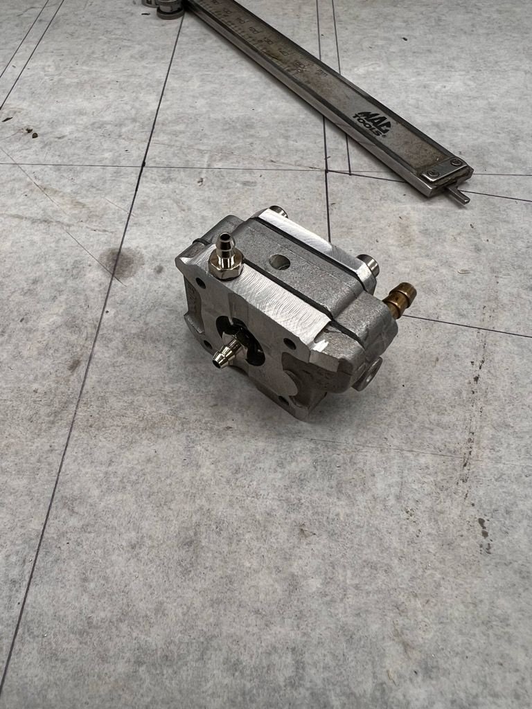

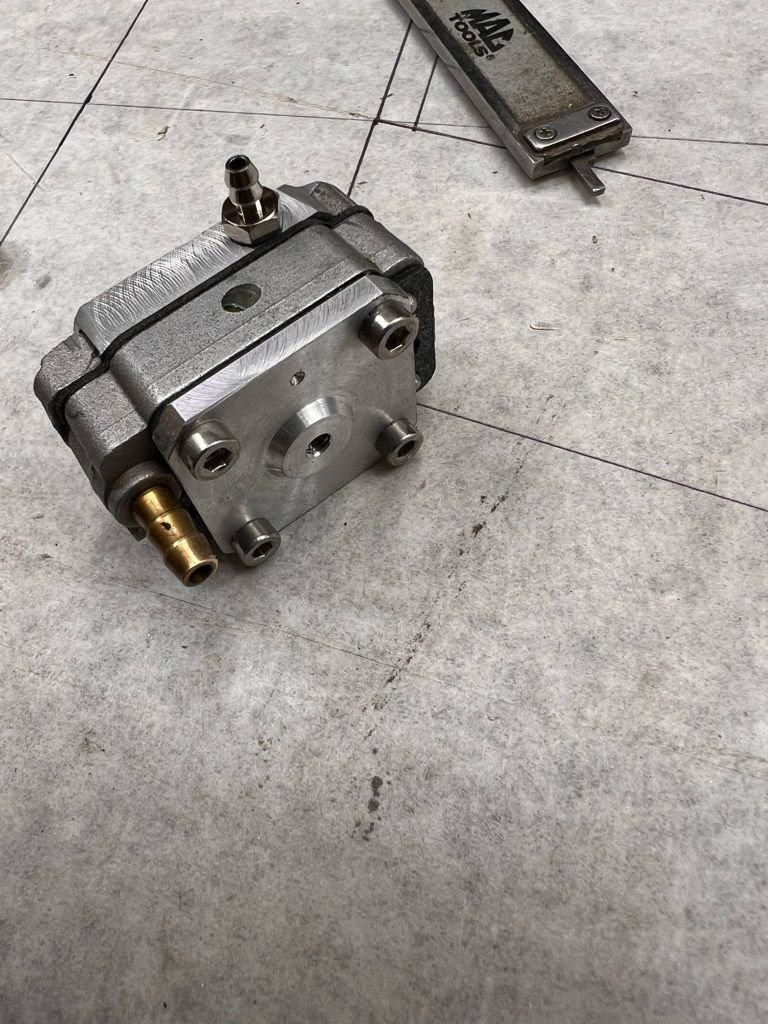

Some of you might remember back ways I was working on an idea to try a "walbro" style pump and regulator with our solenoid setup and I had started machining a unit.. lots of complicated machining.
I recently discovered that the WYL rotary carbs could be had on amazon for about $20 as a clone. Bought one and an extra gasket set try a little experiment. By Machining off the "extras" and a bit of ingenuity I have a test model with very little work. I ended up using an actual Walbro WYL I had for parts as the Chinese clone has a "high speed" needle and is not "fixed" like the original WYL's and I might try a few other experiments with it.
Here is the result . Planning on getting my original 25cc super tiger conversion back on the stand to try this out. This will feed into the "no Needle" carb and be modulated by the solenoid as per normal process.
Chris

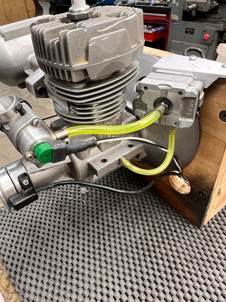

Cat 1 11-10-2024 07:53 PM
Mounted up….
https://cimg0.ibsrv.net/gimg/www.rcu...a12879b48.jpeg
https://cimg1.ibsrv.net/gimg/www.rcu...2d160641d.jpeg

So basically, you made a pump-regulator unit to combine with your Throttle Body set-up?
Should work like a charm, allowing for free location of ful tank, but doubtful if the actual engine performance will change much, given that the regulator only allows fuel in at atmospheric pressure (AKA still depending on intake vacuum for actual fuel delivery).
It would be interesting to see if you can set the regulator up for an offset positive pressure (say, 0,1 bar) and run a larger intake Throttle body and increas performance that way?
Cat 1 11-11-2024 05:35 AM
Yes Bert, Exactly... The configuration of the WYL carb makes this was as they are both stacked on the same side of the carb.
should work like a charm, allowing for free location of fuel tank, but doubtful if the actual engine performance will change much, given that the regulator only allows fuel in at atmospheric pressure (AKA still depending on intake vacuum for actual fuel delivery).
Installing on a known "good running" setup to be able to start experimenting with the setup - Your correct that it will be "atmospheric" feed but a small spring load on the diaphragm could change that. My custom made regulator cover has provisions already for an adjustable setup.
Thoughts are this would allow for flexibility in tank location as stated, and no need for muffler pressure or a Crap trap. Will keep you all posted.
The "Clone" WYL's have a high speed needle valve that's in the right place in the system (and casting body ) to possibly allow of the install of a "relatively easy" solenoid adapter. That might be my next project. the rotary design would allow for adapting to many engines.

Cat 1 11-11-2024 12:20 PM
Well.... It Works....
Very quick run to see if I had everything hooked up right - Very quick tune and can tell the fuel pressure is down from the muffler pressure setup as the top end is leaner than before. Will start playing now with the setup. Fuel feed is solid with the pump.
Short clip as my hands were cold and my receiver battery was giving up - Dead and cold...
