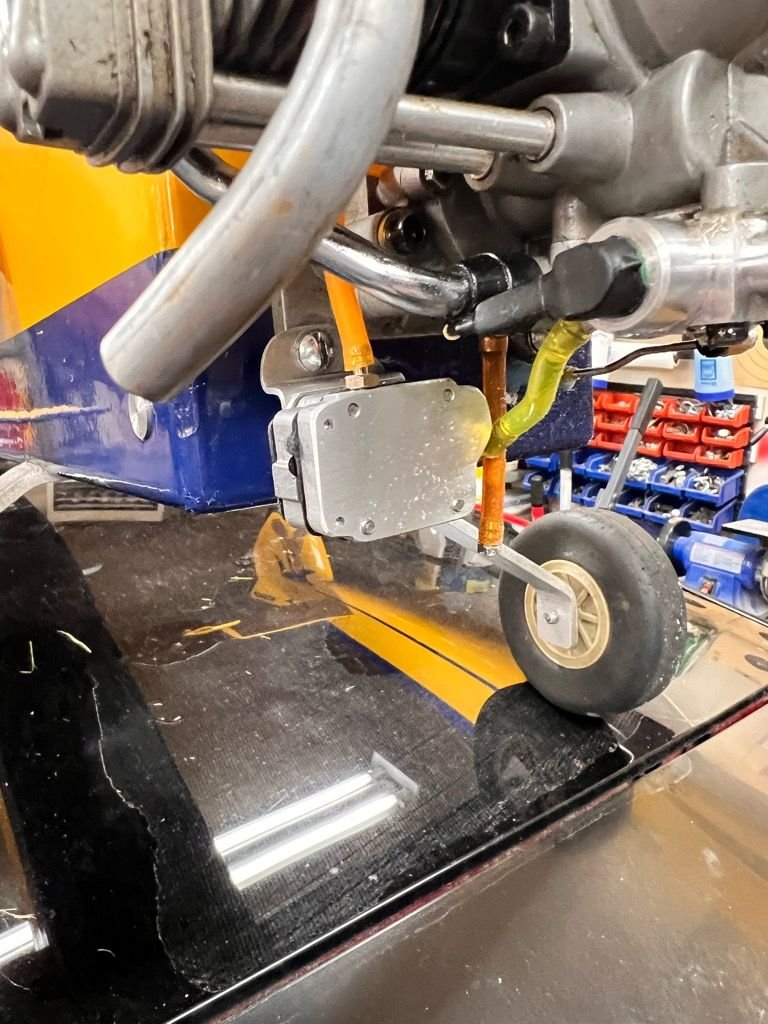

Got to run the Pressure fed setup today - works great on a quick bench test setup curve - Curve is very linear.
I did lower the feed pressure from .8 to .4 PSI as the curve was very low - 0.4 seems to work well
I did have an issue with idle as I couldn't lean it fully - Found it was my "green" solenoid that was leaking by a small amount - Changed out for a white one and all's well - Was able to program a "Fuel Cutoff" that shuts the engine off at any speed.
assembling another "pump" and plan to try it on some other conversions to see if the System can "scale".

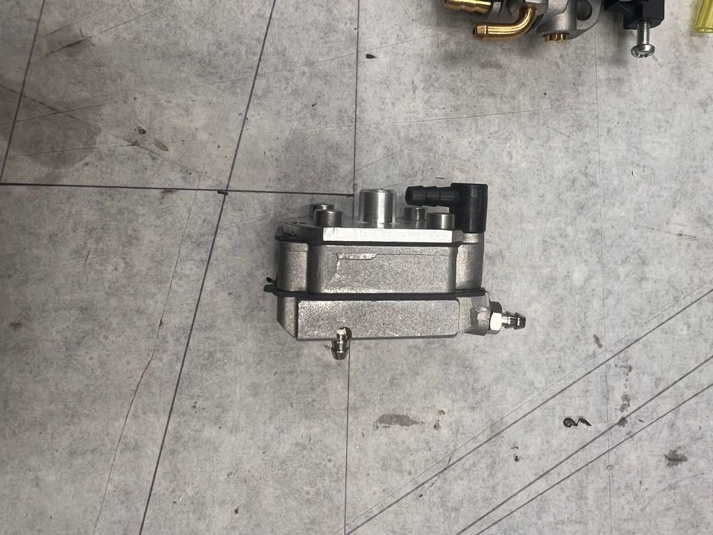

Cat 1 11-16-2024 08:08 PM
This is what you get for $17 CAD delivered. :)
https://cimg2.ibsrv.net/gimg/www.rcu...e2097c9877.jpg
Used one to make another pump setup to try on other engines - The inlet and outlet is different on this one to make it more compact. The pressure is "fixed" too and set with the spring length - This one is set for 0.35 PSI.
https://cimg1.ibsrv.net/gimg/www.rcu...2d76acf221.jpg

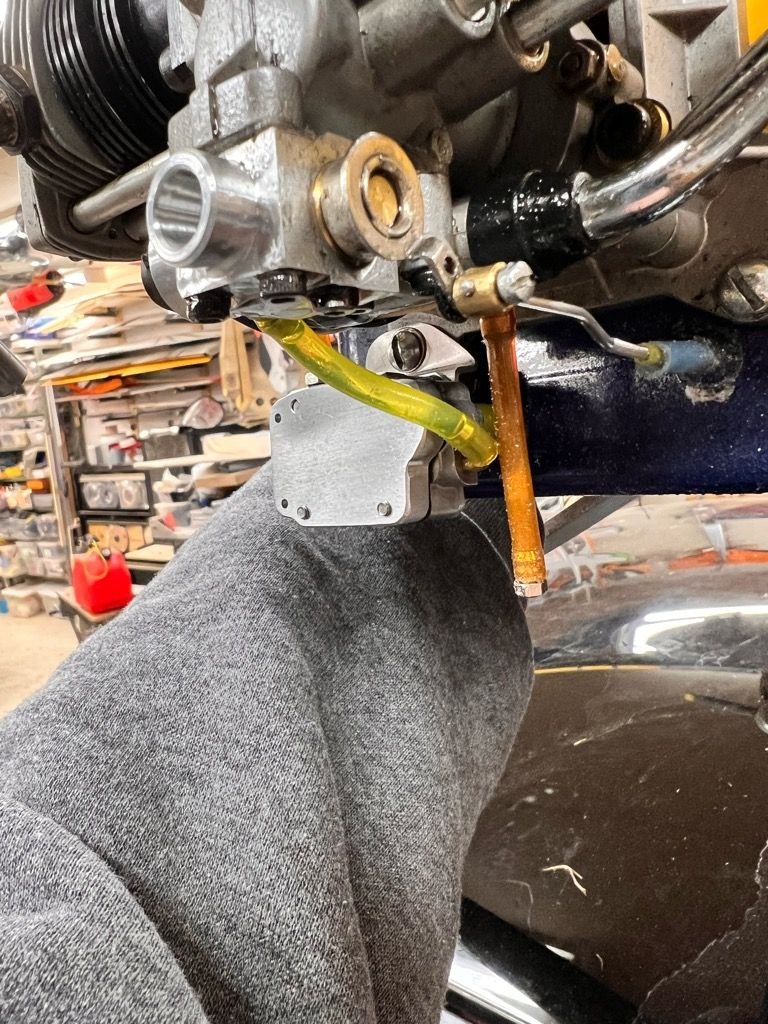

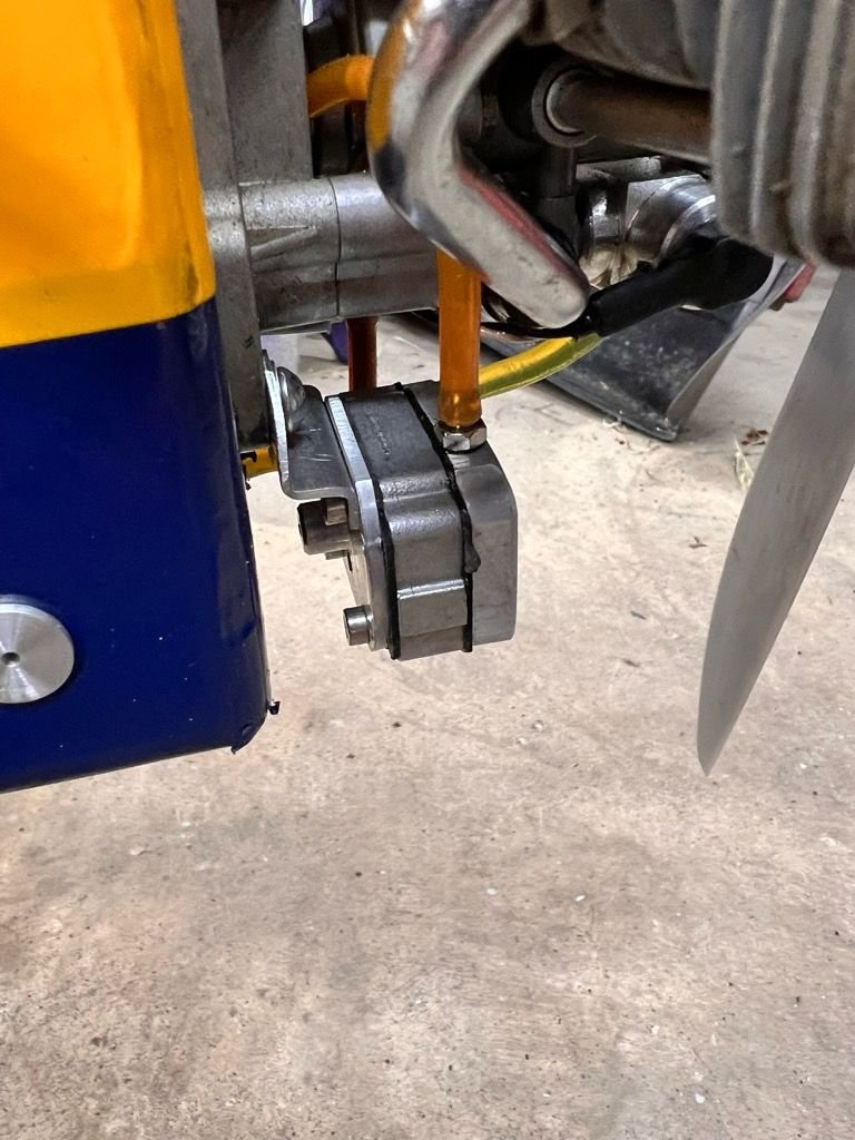

Cat 1 11-30-2024 07:04 PM
Winter has arrived in our location with "Teeth". We have already had about 12" (30cm) of Snow and backed by wind we have some impressive drifts.. Temps hit -34C last night and -40 with the breeze. Nasty.... This has prevented any real experimenting.
I did get a pump completed and run on the Boxer and It shows the same promise. Make the setup dead easy compared with my air pump setup. a lot less plumbing and fuss.
Just a run to prove it worked - Pump at 0.4 psi Enough fuel for a solid top end - No tuning done just a trial to see if it would supply fuel. No tuning tonite as it's around -30 C - Couldn't keep heat in the motor.
The pump is set up on the pressure pulse - I tapped an additional nipple into the back of the cam cover in line with the crank - Put a small restrictor in the drain line and it seems to have a solid supply pressure with fuel to the carb in a few seconds with an electric starter. I didn't want to mess around tapping into the intake anywhere.
https://cimg3.ibsrv.net/gimg/www.rcu...4b4bec1d90.jpg
https://cimg4.ibsrv.net/gimg/www.rcu...add2fac9ca.jpg
https://cimg5.ibsrv.net/gimg/www.rcu...83f4df1e2e.jpg
1967brutus 11-30-2024 07:31 PM
Both OS and ASP foresaw an alternative connection there in the backplate, not drilled out but a cast ridge for just in case. You used that for the additional tap?
I really like the idea of a pressurized fuel supply, just one remark: my set-ups basically function with the exhaust pressure rising with RPM, compensating for unloading in the air.
I would expect a setup with a fixed pressure, to need a more rich groundrun in order to lean out in the air for peak performance.
You MIGHT get better results with a set-up where for example either muffler pressure is routed to the compensation hole in your pressure regulator, or maybe as an alternative, a pitot tube connected to that compensation hole. I expect muffler pressure to be best.
Your 0,4 psi preset pressure would then get additional the muffler pressure added to it, leading to more fuel delivery if the engine unloads in the air.
