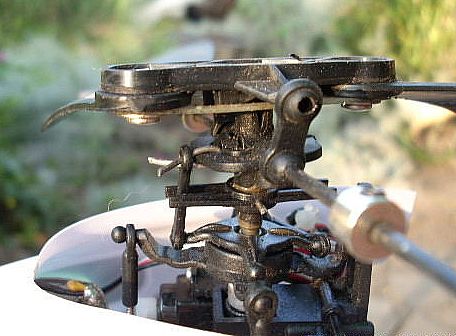

ORIGINAL: maxtheknife
It's pretty simple, really. I just take a short piece of wire and bend it around the paddle frame where the ball broke off and then slip both ends of wire through the linkage eye. Then I bend each wire horizontally (one left, one right) so the linkage eye will have plenty of up/down travel without restriction. It takes a bit to get it right the first time, but after that it's pretty easy. If the linkage is restricted, just unbend the wires a bit on each side till it moves freely.
max, wouldn't happen to have a pic would you ?? this is good info man

I would love to post a pic if I knew how KCinNC. I clicked the link at the bottom of the text window and nothing happens. Heh. It's a good pic too. I could email it to you if you'll PM me your addy. Sorry about that.
Old 08-04-2007 | 07:54 AM
  #32
Joined: Jun 2007
Posts: 34
From: Paris, AR
Default RE: Help on Honey Bee FP setup
Well, I guess I figured out that the problem was my browser. Firefox saved the day so here's that pic KCinNC.

thanks man...i copied that pic to use down the road as a reference...hope that's cool

It's absolutely cool. I hope you have the same luck I've had with that mod. It sure saves money and time. I think on the next mod I'll try bending the wires up and down and see how that goes for flexibility. That's a good pic, ain't it? my new litttle camera does macro shots real well.
