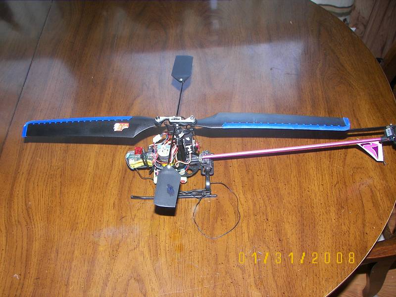

Hello all,new here and kinda new to heli's. Been toying w/a Fun Piccolo for a few months,managed to modify w/a little inginuity,but as I have been searching for a better,more equipped machine I cant help but wonder if fly bar placement has much to do with performance?For instance,I just ordered a Belt CP,and couldn't help but notice that the Belt has the flybar above the blades,as the Fun has it "even" w/the blades and most nitros are below.Whats the reasoning? Just curious. By the way,this forum has been very helpfull with my purchase of the Belt and I hope to learn a lot more from you folks. Keep up the good work and keep those birds in the air!

I read somewhere that a flybar under the main blades is more stable, but don't know why. I have moded my HBK2 with a head from a copterx 450( which is a clone of the TRex 450) and the fly bar is on the bottom. But the thing that realy helped me get to hover , was that the flybar should have almost no resistance. It should be able to flop up and down by blowing on it lightly. So I couldn't control my HBK2 befor trying to hover and a guy I met said my links were to tight and I needed to size them and make them alittle loose. So I did and now I can hover and do some forward flight and reverse flight. So I know the flybar needs to be very free in its motion. But as for the top or bottom ,I don't really know. But I can hover full packs now and am having a great time. I juts wish the weather was better.

Nice Ken,very informative,I guess there is really no "bad" design then. I ordered a Belt CP from HeliHobby a day ago,and have the jitters already. Like I mentioned,the Fun Piccolo was my first and only heli till now,and that damn thing was shelved for a year. It was like trying to fly a cinder block! A few months ago my interest was re-ignited so I blew the dust off the little turd,did a little research,and low and behold I can hover it.Mind you it cost me two bare bones kits and some parts off a cheap Hover Lite,but hey,with a little persistance and inginuity.........Anyhow heres a pic. Check out the 5.5mm knitting needle boom,the HoverLite blades and skids and the homemade head stiffener!LOL. Believe it or not,it flys!

As for flybars, performance wise, the flybar does the exact same job whether it is above the blades or below it as it rotates around the same axis. I guess personal preference is most of the issue unless you fly inverted cutting grass lol.
The only snag I've run into was when I was test fitting my custom case design. A 450 over slung flybar (when the blades are in the holder hits the top of my dual case and makes fitting the king2 in there with it impossible. With the under slung flybar, I can get both heli's in there along with the tx, batteries, tools etc so everything is all in one case. Guess it wouldn't be a big deal to have two $60 cases if I drove to the field, but I only spent $20 for my butt ugly elcheapo one and I walk to the field most days. My flying field is large but it's all 2' to 3' tall grass.. so it's 36"x36" helipad in one hand and the dual heli case in the other.
