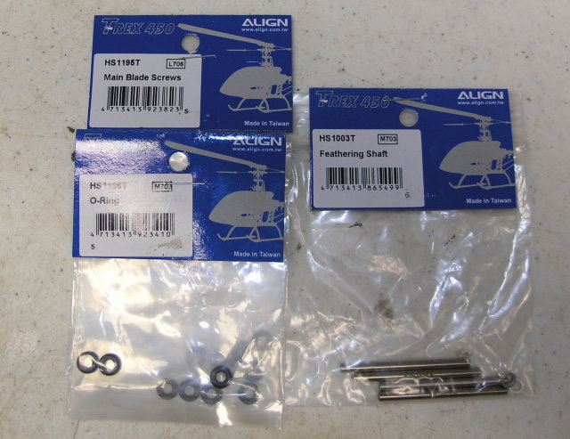

i've posted this before, but for the benefit of those who are just joining, and might not have come across the posting, here are the parts needed to convert form esky to trex spindles (hs1195, hs1186, hs1003)...use two o-ring dampers on each side...if you're not satisfied with end-play on the grips, you could add a spacer...ken

Quote: Ken, it looks like the spindle shaft and blade grips are held with screws instead of nuts on the Trex - right? Makes alot more sense, and replacement alot easier.
Yes, trex spindles use socket-head bolts (like 99% of all helis) that you fully loctite in place -- or if you fly like me, and crash frequently enough, you can omit the loctite, to make spindle-changing easier - lol...With the stock 5.5mm self-locking nut setup, there's the problem of having an even amount of threads showing between the nut and the root of the blade...I used a needle-nose plier and a 5.5mm socket to get that right...btw, I found that the hardened esky spindle was just a tad longer, causing interference with the root of my cf blades...dremel took care of that...ken

I have ask the same question in belt cp tread, I change my feathering with the trex (hollow one) and it's really to long so I add two unused bearing, one in each side before the hex screw, is this OK? I didn't add o-ring like you sugested..

since the belt cp uses the same feathering shaft as the hbk2...
http://www.rchelicoptershop.com/cata...tcp-p-258.html
i would use the trex parts that i listed in my previous post...if your hollow trex feathering shaft is too long, it must be for a newer model...the shafts that work with the hbk2 were made for the trex450xl...ken

Hs1186 is the feathering shaft , Hs 1003 is the o rings. what is hs1195? I cannot find that #
