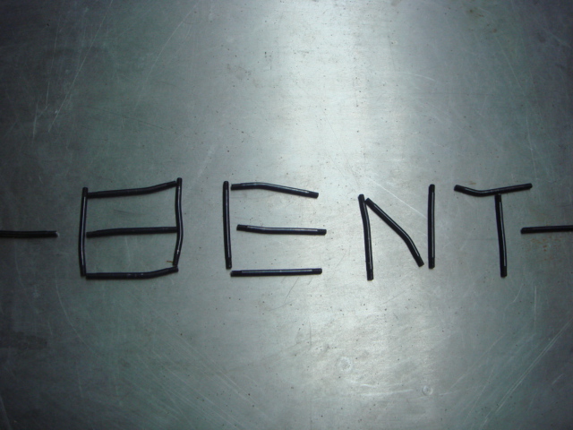

Jimmy...if you learn at a slow rate, like me, get lots of feathering shafts!
