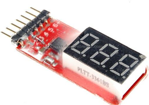

Dimension Engineering has the best BECs for the money. I run a 6 Volt one and Dynam 30 AMP ESC with no issues on stock servos and Hitec HS-81 for my tail. It was donated, otherwise I would have chosen the 5 volt version. My Dynam 30 Amp, came programed for Hard timing(Double Beep on start up) This will lessen run times and run hotter but have tons of power. I don't have much faith in the cut-off for the Dynam because mine will consinstantly run the Helo below 3 Volts per Cell ( I run an onboard monitor) Consenquently, I think I have been running my LiPos too low for about 6 months now and will need new ones soon. The onboard monitor is the ticket to avoid this. United Hobbies has one for a few dollars. I think I spent $9 for a voltmeter and onboard monitor shipped. Well worth it in my book.

your battery checker look like this? I have a box of of these I am going to sell off someday. Notice that they are only accurate to .1 volt even though they read to .01. Just round it up or down.
