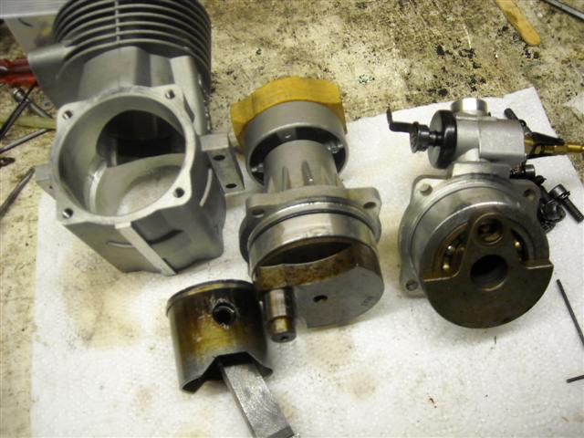

Hi Hobbsy, I am not sure you saw my question in an earlier post. If you flip the crankcase/cylinder to exhaust on the opposite side, would you be able to run the engine clockwise? That would be a great reason to buy the extra engine(s) and put it in a monster P-38 or similar.

Before I answer that let me flip mine end for end and see, that would put the long cooling fins in the front but that simply wouldn't matter that much. You would also have to rotate the rear casting one way or the other to time for reverse operations.

If I remember correctly, they have a extra hole in the rear rotary valve disc that fits on the rod. If you use the alternate hole, then it runs in reverse.
But maybe they don't as I haven't looked at one in a long time now.

Earl, here is a shot of the intake drum, it has a heavy counterweight the is phazed with the main counterweight.

Thanks I guess my memory has faded on that and it blended in some other rear intake engines rotary valves that had the dual feature on them.
