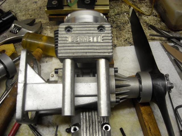

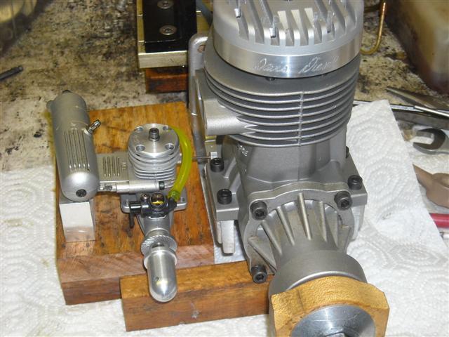

OK Deezel buds, I found a sort of suitable muffler for the 4500, its probably going to be loud even for a Diesel but at least I can run it. Should I pressure tap it, I dunno. I tried to mount the really uglyful J-Tec, but someone had enlarged the holes and the bolt spacing is a little wide also. I should get a chance to run it tomorrow.
ID:	1680401   Click image for larger version
ID:	1680402   Click image for larger version

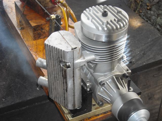

It runs, I used a Sullivan Dynatron as Dennis did, it started on about the 3rd compression stroke, as Dennis also said, it's cold natured although it required a full turn of compression from where it started so it may not be so cold natured next time. I managed to get the J-Tec muffler on it by grinding a couple of washers flat on two side, you can see one of them. It definitely needs a larger prop, I had to bury the compression screw to get 6,650. Boy is it smooth, acceleration is nearly instant even with the heavy Classic 20x10. Well, now all I need is $375 bucks for the plane, 50 bucks for a Just Engines Jen-C/Biela 21x12 prop and 54 bucks for a bisson Pitts muffler. Nothing to it, beyond a small miracle.
ID:	1680985   Click image for larger version

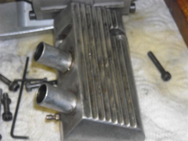

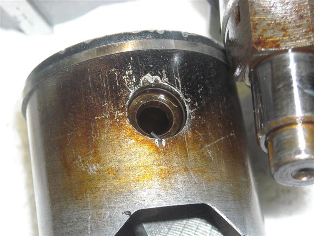

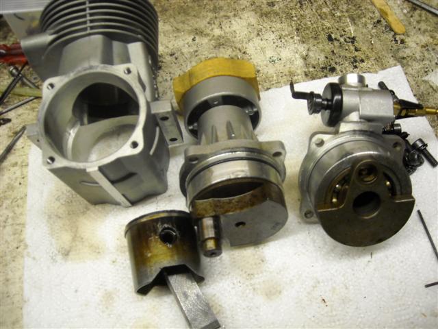

Thanks Bob and Martin, Bob that banged up piston worked well just like you said it would. I used one of your miniture file sets to straighten up the ring groove. SuperTigre 4500s have big guts. I've had new piston back ordered for 2 years now. I gues I'll cancel it.
ID:	1680997   Click image for larger version

ORIGINAL: Hobbsy
It took me a minute to figure out the parts. I realized that it is rear induction. Now, if you flip the crankcase/cylinder to exhaust on the right side, can you make it run in the opposite direction? Just curious.
