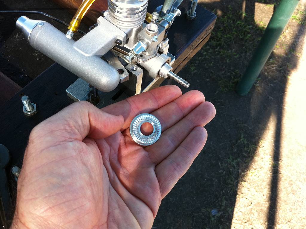

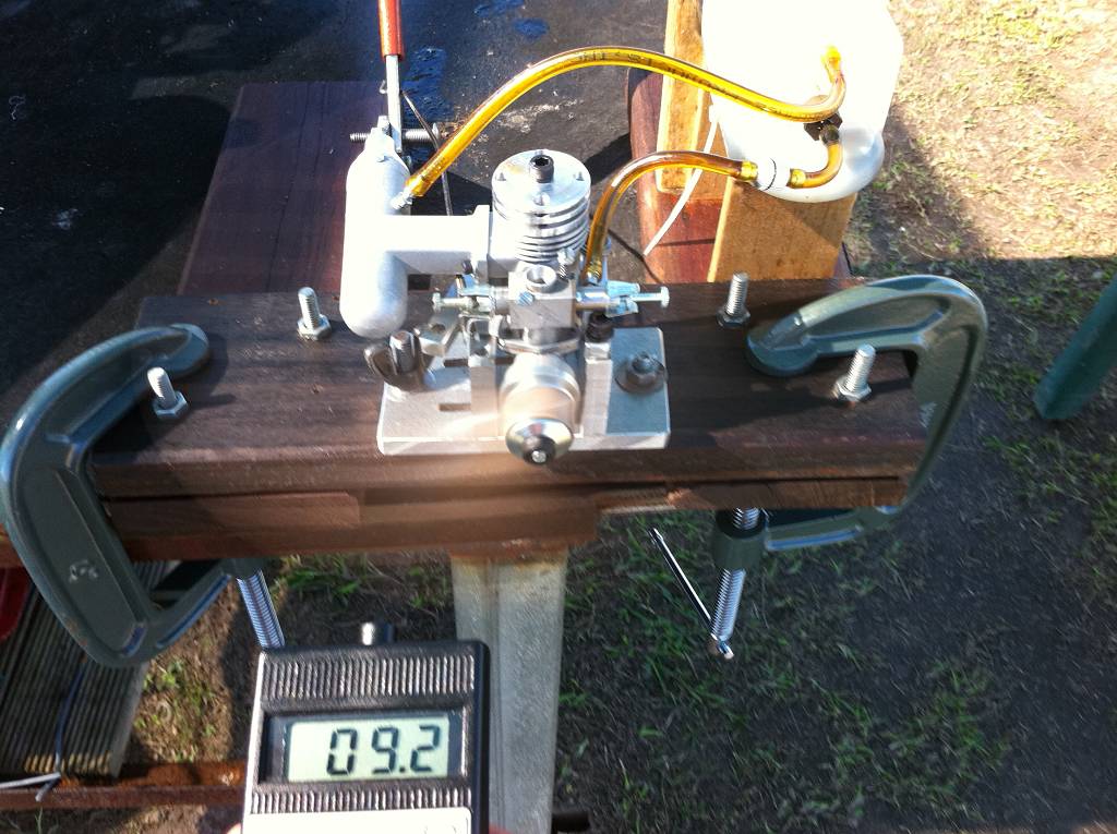

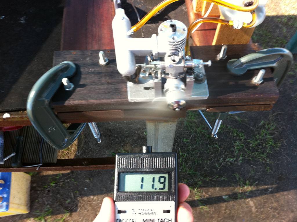

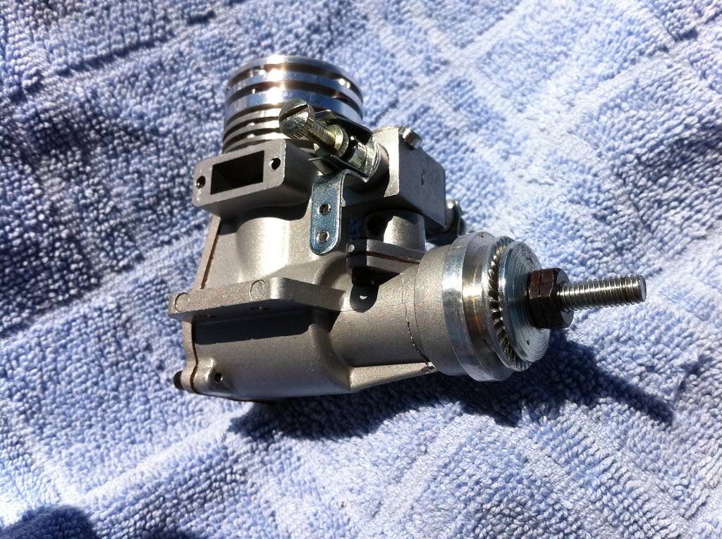

Fox .15 BB R/C with DDD head (Schneurle, iron piston in steel liner)
Date: 13th May 2012
Temp: 28 C.
Humidity: -
Elev: 400 feet ASL
Props tested
1. Master Airscrew Scimitar Profile 9x7 (US)
2. APC C-2 9x4 (US)
3 Bolly Clubman 9.5 x 7 (Australia)
4. Robbe Dynamic 9x6 (Germany)
DDD recommend to start with a 9 x 7 on .15 size engines.
Notes:
Engine run in as glow on 80:20 fuel, no nitromethane. Six five minute runs following tips from Adrian Duncan for running in iron and steel P&L diesels, described here:
http://www3.bc.sympatico.ca/dieselco...ut_diesels.htm
DDD head then installed and engine run on the fuel mix:
25 % Castor Oil
38.5% Kerosene (KCB Brand)
35 % Di-ethyl Ether
1.5% Isopropyl Nitrate
Engine was easier to hand start on diesel. Ready starts hot or cold. Instant when touched with my Sullivan Hornet 1/2 A starter.
Engine ran cool at all times, even when adjusted to maximum.
Main needle 6/8 of a turn out from closed (turned in 1/3 turn from best glow setting). L/S needle not touched from best glow setting.
No leaks from muffler. Muffler screws never came loose after inital tightening.
Excellent throttle response on glow or diesel. Twin needle carb is outstanding. Carb spigot seals without an "O" ring. It relies on it's interference fit to be airtight. Metal throttle lever, now rare, is welcome. It has a proper throttle stop screw as well, often deleted in many recent R/C glow carbs.
Main needle spring was overly tight as delivered. H/S needle spring tensioners/ratchets were opened up to reduce tension, and permit easier H/S needle adjustment.
Deep knurling on prop driver and inner face of prop washer make for serious prop security
Engine exterior casting has a bead blast finish. Nice but not exceptional.
Interior of engine clean and free of swarf as delivered.
Fit of DDD head is a very good sliding interference fit into liner. Stock glow head fit is a little loose for my taste. One head shim/gasket fitted in each case (two supplied with engine)
Very little blow-by past the contra piston sealing "O" ring in the DDD head. Slight squish band and deepish dish shape on the contra piston facing the combustion chamber. Best compression and needle setting were very easily found. No leaks from head, backplate or carb.
Peformance on diesel.
Refer to images and youtube video in following post.
Best RPM 12,000 steady WOT with APC 9 x 4. Engine would idle safely down to 3,500 rpm. Best idle unsurprisingly on the Robbe Dynamic "paddle" broad blade" prop, the heaviest of the group. No attempt made to optimise L/S needle. I overlooked it. Pick up from idle was very good as found on best glow setting with only slight hesitation after extended idling.
Operation with DDD head as simple and reliable as it can get. Engine feels engineered to take lots of work. Mounting lugs are very substantial. Split cone attaching prop driver is larger than found on most engines three times it's size. Lots of surface area.
Conclusion. The Fox .15BB with the DDD head is a sound work horse for nice smaller scale or sports model. Made from quality materials. Unfussy to run, not a highly strung show pony. DDD diesel conversion head is very nicely done. Engine and DDD head well thought out overall.
At $73.50 (at time of posting) for the engine (excluding the DDD head) great value for money. With the DDD head, a winner.

Further images.
For video of the Fox spinning an APC 9x4 click on link below:
http://www.youtube.com/watch?v=4jEoS...ature=youtu.be
And spinning a Robbe Dynamic 9x6 , click on this link
http://www.youtube.com/watch?v=xViwv...ature=youtu.be

Default RE: Fox .15 schneurle BB conversion
Thanks for sharing, there seems to be quite a lot of "knocking" to me though, have you tried with a lower compression setting?
Fiery , smooth as silk great transitions, very clean running too sounds on the money
Mr Cox I could not hear any knocking a little exhaust pop or gurgle on transition very little, maybe some background noise wind excetra
one of the smoothest running engines I have seen, and heard martin
I have 3 MVVS 15 diesels, great engines , however after seeing this, hearing runs, transistions, this one I am getting one
I have o issues setting up my MVVS 15s yes classic design contra in cylinder , but with the Davis head contra in head is easier
to set and handle, have both MVVS, PAWS in the classics , the rest various engines Davis heads
