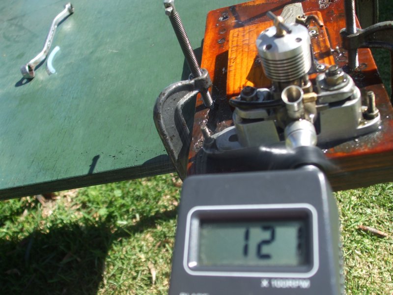

OK, here are the props I ran,
A MasterAirscrew Scimitar 9x5S rpm====12,100
A Taipan 10x4 rpm================9,200
A Graupner 10x5.5 rpm=============9,000
Idle==========================3,100
I only got a single outside photo to take, its really difficult to take them in the fall, as you can see. This one about two clicks from the peak. I don't seem to have a 10x6 of any brand. I think you can take a look at the Taipan and see why it made only 9,200 rpm but that dude makes some serious wind.

I finally found a 10x6 that I thought was a 10x8 because it was buried in a stack of props on a peg board hanger. It is a Graupner 10x6 Scimitar.
Graupner 10x6 Scimitar rpm ====9.250, the idle with this prop is a very steady 2,400. It is about 40 degrees right now and there was no idle cool down at all.

ORIGINAL: AMB
FOOD FOR THOUGHT A 10X6 IS A COMMON FOR A 40 GLOW
Too windy to fly yesterday so we ran engines. A bloke ran a c/l unmuffled Norvel 40 BB on an APC 9x7 and I tachoed it at 15200 RPM.
I ran my Oliver Tiger MOD 2.5cc on a Master 10 x 6 and got 7600 RPM consistently with a maximum of 8200 RPM. However it would
only hold the latter speed for about a minute before overheating.
It turned the full RAM 8 x 6 comfortably at 12100 RPM.
It also turns an APC 7 x 6 at 16500 and an APC 8x4 at 15400 which makes it a goodin!
Regarding the claimed Davis RPM figures my gut feeling is that they're fantasy and as far as I'm concerned the myth is busted!
A fair amount of salesmanship in the claims?
