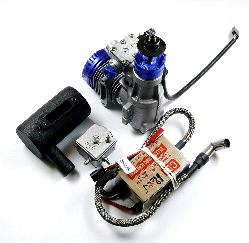

Louis-a little more reflection on your challenge reminds me that there are now some very small-and quite refined 2-stroke petrol engines recently developed specifically for model use. [People have been using converted chain saw and other small industrial engines of about 25cc and upwards in models since the late 1970s-but in the last 2 or 3 years some of the traditional model engine manufacturers have produced small spark ignition engines of modern design in sizes as small as 9cc-see attached pictures. These generally have Hall effect ignition system, run on typical 2-stroke petrol mixtures (20:1, 25:1) rather than the typical 4:1 of methanol fueled model engines and the 3:1 of model diesels.
It may be that this approach might be compatible with biodiesel............or at least a blended fuel with some biodiesel component...........
