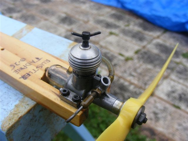

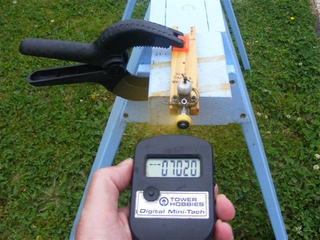

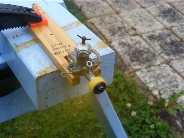

OK-one day later and I've just run it up several times on the now carefully balanced Cox 6x3-vibration is still present-so it may be a wee bit of a shaker. I have gained a few hundred rpm though-but whether this is due to the reduced vibration or simply a consequence or more running time is a moot point. 7000+ on a 6x3 would put it up there with the VA .4cc Mills and VA Kalper .32 for performance-so the little Tadpole is punching above its weight!
I haven't made up any of the specified fuel yet-will be interesting to see how that compares with my Model Technics D1000 mix. I'd expect the engine to perhaps sound happier-but produce less revs, on this mix (see previous post of scanned instruction sheet for the recommended fuel mix)
Here's some pics-on a rather cool Wellington morning..........

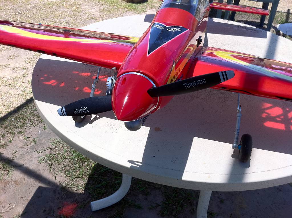

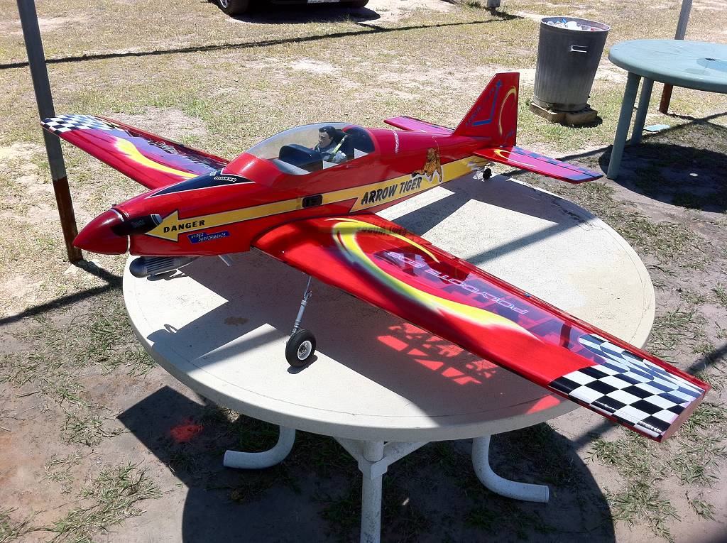

I will also say the same.
I put a Harry Higley brass "heavy hub" on a .46 powered pattern trainer for CG purposes. I hid it under a 2 3/4 " diameter spinner. Increased smoothness and reliability of the engine at idle was noticeable. I noticed no difference in throttle response. Hand starting was a snap.
Some old hands predicted dire consequences would follow. Warnings of "increased gyroscopic precession", stressing the front ball race beyond its rating.
I never noticed any issue. Engine was fine.
