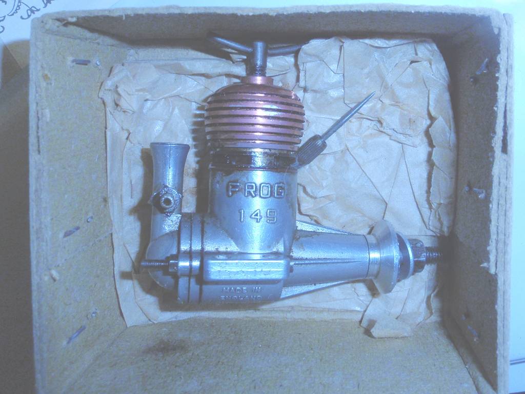

Here's my old oily one:
BTW, weren't there some India replicas of this engine?

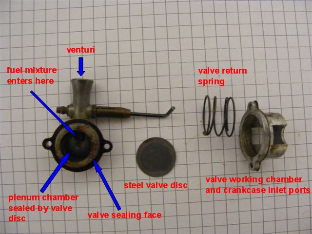

Default RE: FROG 149 Vibramatic
ORIGINAL: AMB
Well that answers a question I was going to ask its NOT the Cox setup, sounds like this setup may be the same used in some larger 2 strk ( gas) in weed wackers, chain saws etc
martin
This may well be true Martin-the pics below should give you a better idea of the internal workings of the 149 Vibramatic. As you can see-below the venturi is a sort of plenum chamber-the outlet of which is sealed by the steel valve disc-held in position by the return spring-which is itself held in a chamber with two outlet ports. As the piston ascends, crankcase depression causes the valve to move forward, slightly compressing the spring and allowing the fuel charge to pass from the plenum chamber past the spring into the crankcase, As the piston descends, the crankcase pressure plus the spring tension cause the valve to reseat. The key difference I suppose is that the steel valve does not flex or distort in the process like a reed does-it simply moves backwards and forwards against the pressure of its retaining spring. That being said, IMA (International Model Aircraft-the manufacturer of Frog engines and kits) must have had quite a challenge coming up with the spring specifications to achieve just the right tension..........

Chris quite sure they did plus of course one that would not fail from the constant flexing movement would be miminal however not having the engine have never seen the setup martin
post note your pix explains it large spring hold up just about forever miminal flexing

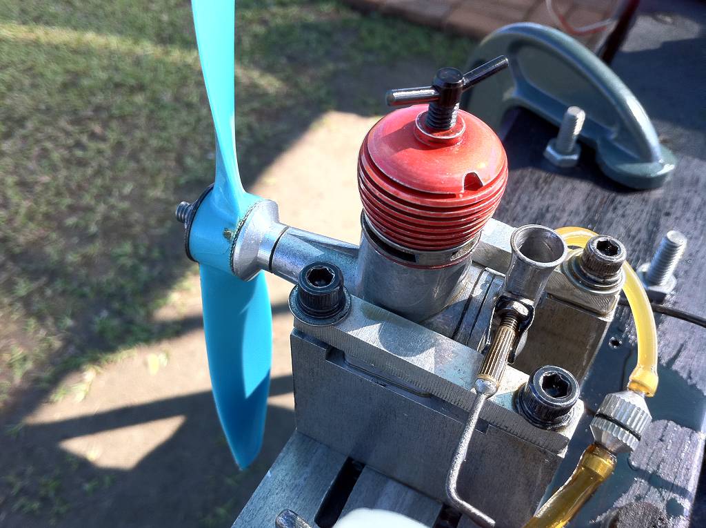

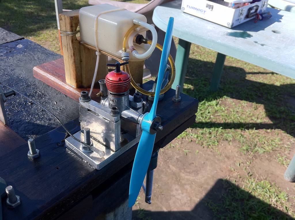

On the test stand. It starts and runs well but will not hold a steady setting.
Examination reveals it leaks fuel / air mix from worn back plate gaskets. Replacement gaskets will be made up from 1/32nd thickness gasket paper. It will then be re-tested.

FROG 149 is now healthy.
http://www.youtube.com/watch?v=8d_tq...ature=youtu.be

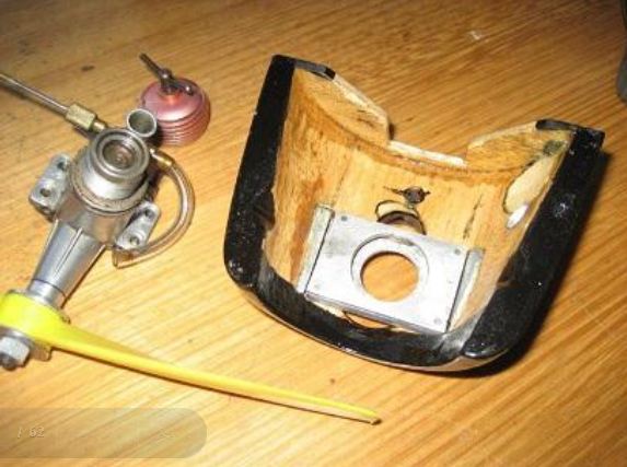

Images from and article by Chris Rowe in "Sticks and Tissue" No 57 - August 2011 edition, pages 24 to 32.
The aircraft is a F/F (restored and converted to R/C assist) 'Incubus' flown in the 1958/59 Australian National Championships. Designer is the late Ken de Bomford.
