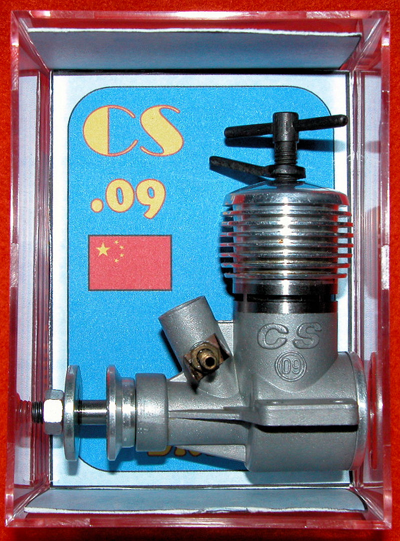

I was wondering how many different colors SS did on their 1.5cc diesels. I had gold and plum colors plus a CS with natural aluminum finish. The CS appears to be the same engine but it could be a copy.

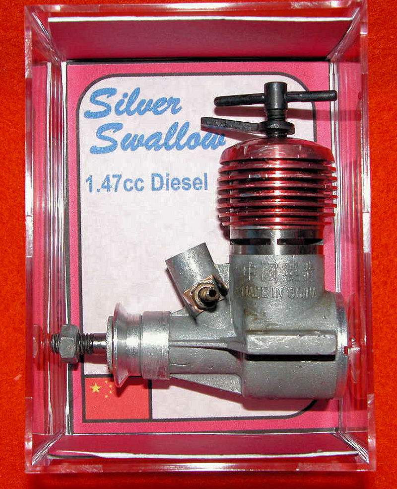

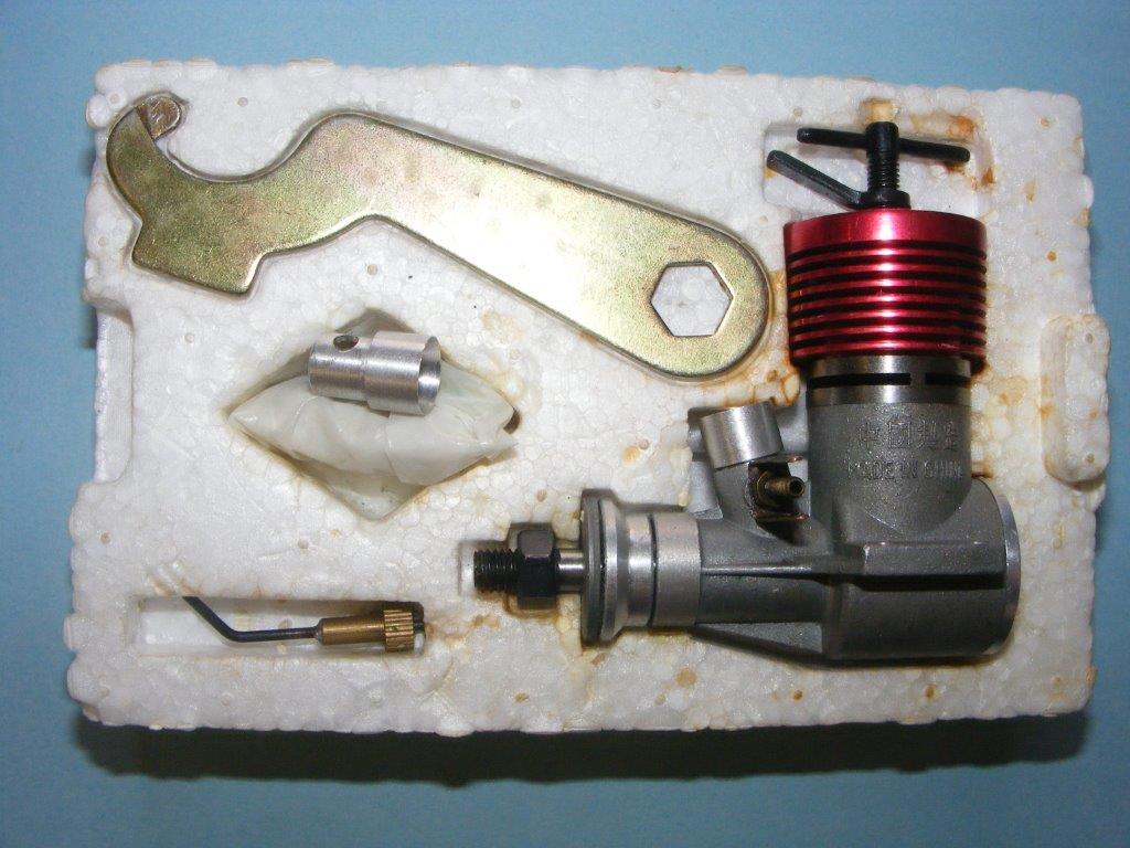

I still have two. Cooling jackets are dark blue and "violet purple" anodise. The anodising is very good. Even, deep colour, and blotch free.
Neither engine is serviceable. Each developed a soft piston/cylinder fit within a couple of hours running.
A pity. They are an attractive little engine.

For my sins I am about to acquire another 1.47. Not sure if it is a CS or Silver Swallow. It is coming with a couple of red case UK build Irvine's with DDD heads as a 'free' sweetener. Or probably because no one else is man (or masochistic) enough to buy it.
With a little mix'n'matching of working parts between it and my current examples, I may end up with a serviceable unit. Or, I may get 3rd time lucky and it could be good straight out of the box. Will report on it later.

Dan, Under no circumstances did CS improve the Silver Swallow 2.49cc or the 1.47cc diesel engines. As far as I'm concerned, CS totally screwed up
the original Yin Yan products. Hearsay reveals, that there were several Chinese firms that produced the Silver Swallow engines; before C.S. produced SS's.
Again, C.S.'s quality issues were caused by the complete lack of quality control of their engines. Although I know that Mr Gau tried, but to no avail...

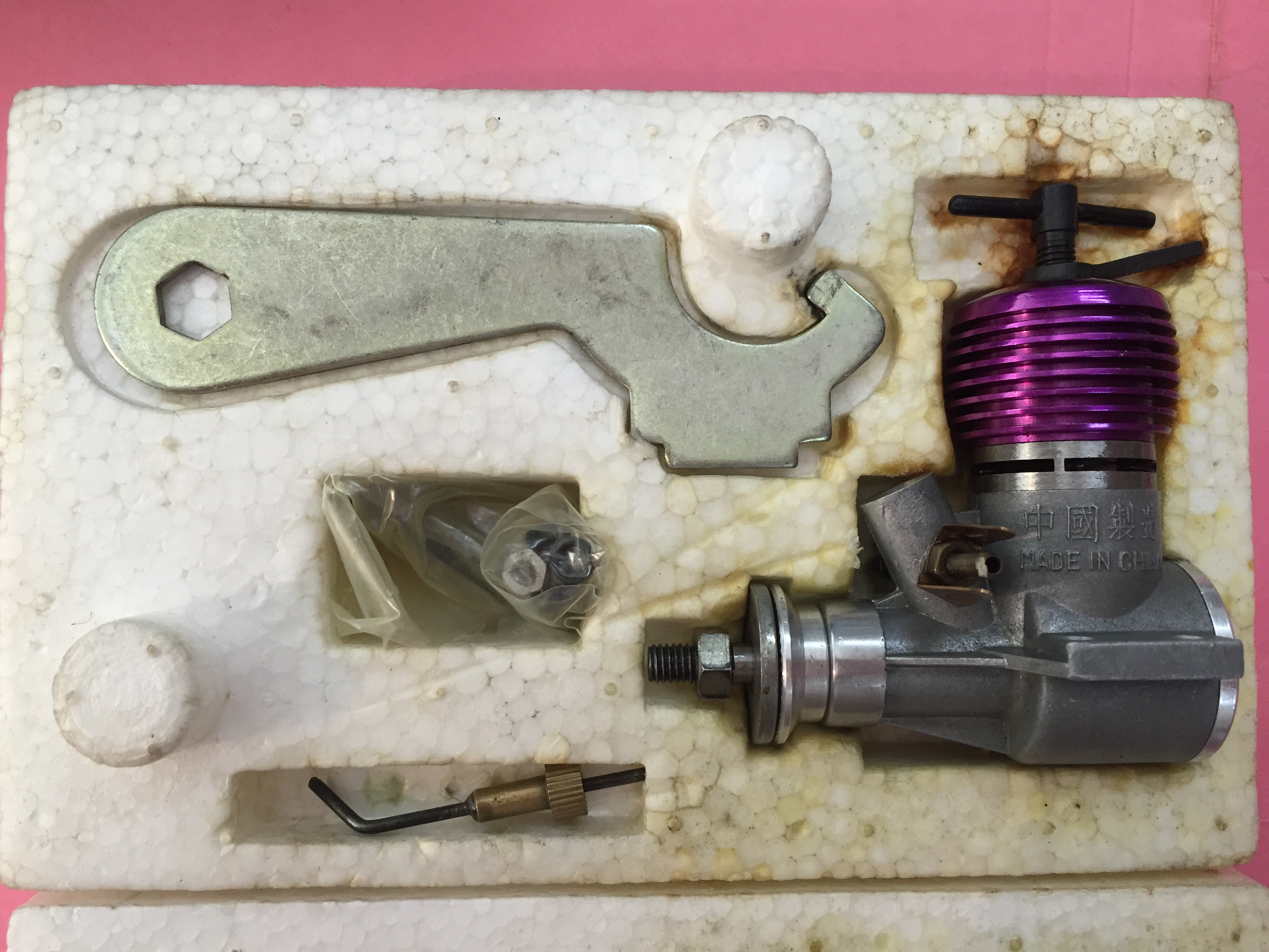

Here is my purple jacket Silver Swallow 1.47 c.c. Or is it a1.49 c.c.? The box and instruction sheet contradict each other.
Nice looking, but no compression at all. I can turn it over easily twisting the shaft extension by hand.

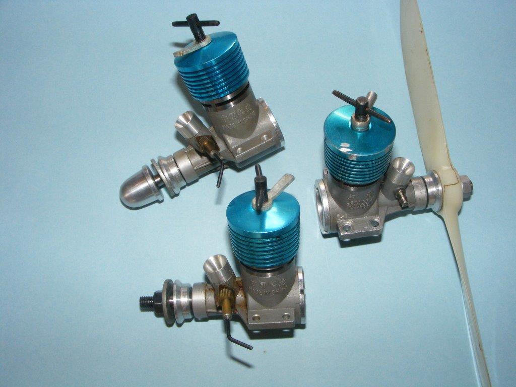

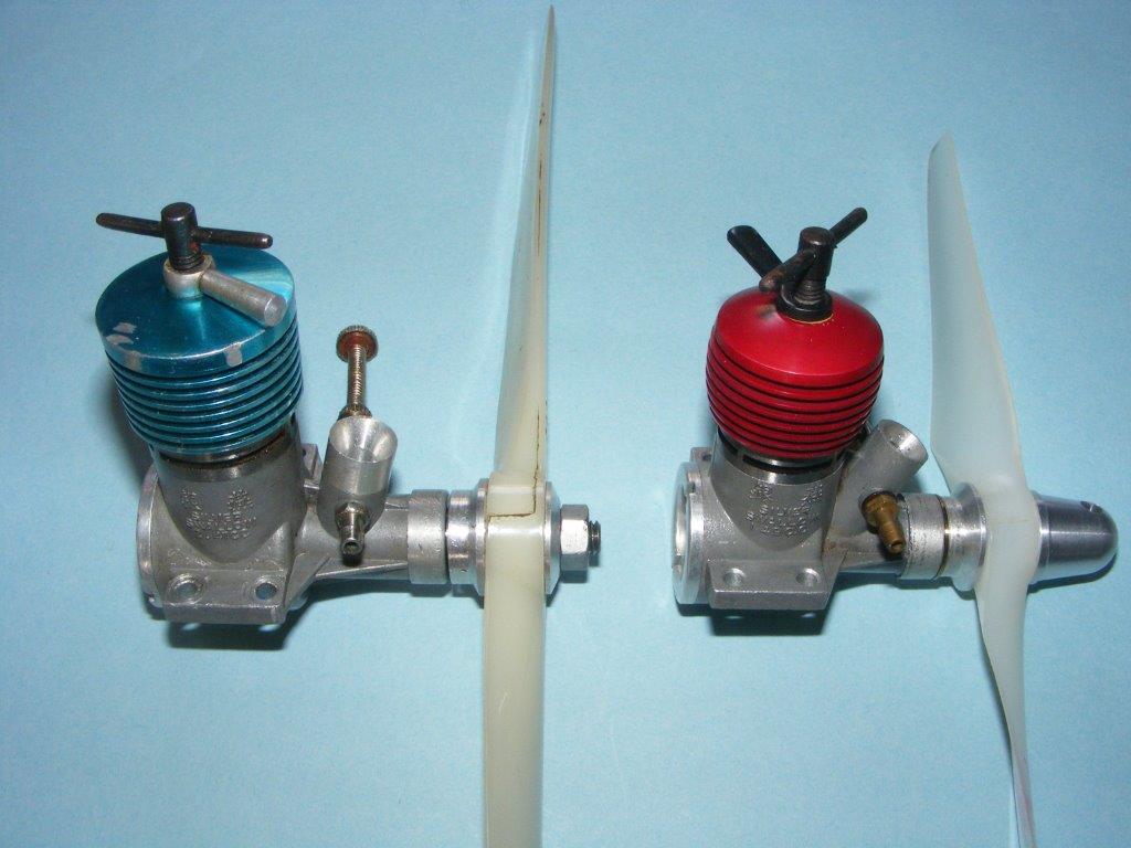

time for my 50c worth-I've had about a dozen of these engine through my hands over the years-and still have 6- 4 of the 2.47 and 2 of the 1.47. All bar one were purchased new, mail order from Hong Kong-in the early 80s through to the early 90s.[which predates CS-so all were definitely Silver Swallow rather than the subsequent models. A range of head colours has been seen-including green, gold and natural aluminium [I suspect that that was one that sneaked through assembly rather than being a colour option]- I can say-=based on a sample size of around a dozen personally-and a few more by observation over the tears-that sky blue seems to be the most common colour for the 2.47, and red for the 1.47. The engines were rdiculously cheap being about NZ $20 for the 1.47 and $30 for the 2.47 (ex HK prices)-which is why I ended up buying so many on behalf of other club members.
I can also state-based on first hand experience with at least a dozen-that NONE were easy starters from new-several required the use of the 'electric finger' for that first run-but once fired up ran extremely well-and starting continued to improve as the engines got more running in time on them. I also found the 2.47 to be a lot easier starting than the 1.47-but this may be simply scale effect at play-or may indicate that the 2.47 was better made and fitted than the 1.47

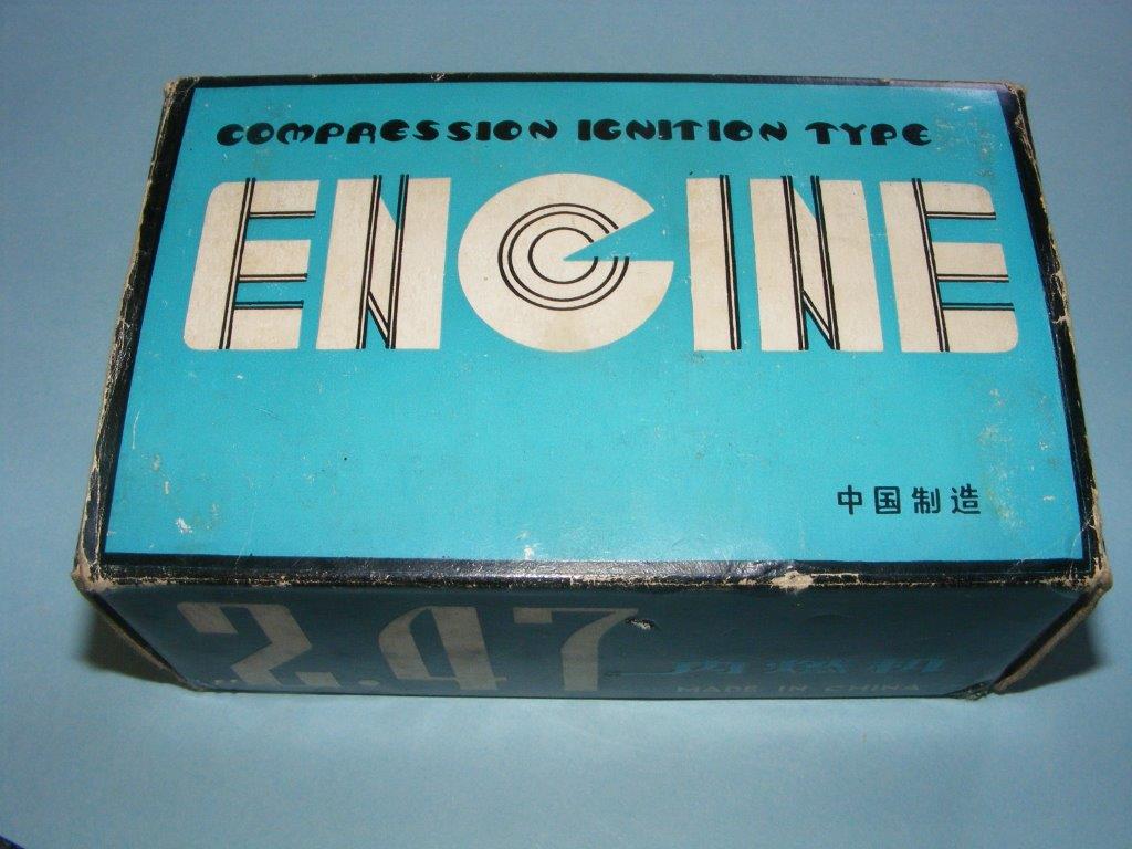

Now looking at the photos below-the 2.47 box is in the same style as fiery's orange one-and this is what I refer to as 'mid 80s packaging'-quite a large box with a moulded EP insert taking the engine, spanner, spare venturi and mounting bolts-all the engine I obtained from 'Winning Model and Hobby Supplies' in the mid to late 80s were in this style packaging-and as fiery has noted-the instructions were the same for the 1.47 as for the 2.47. BUT earlier-my first Yin Yan came from Radar Co in HK, the engine came in a flimsy carboard carton about 3" square-lavender in colour, with a picture of the engine on the lid-it still had all the accessories-spare venturi, mounting bolts and spanner. I refer to this as '70s packaging' as I would have purchased the engine new in 1980. The Ron Chernich site has details of a still earlier box-about the same size-which might be considered '60's packaging' -as the engines first appeared around 1963.
As a final point-the Yin Yan 2.47 in the photos with the prop on is a rare beast-an easy starting good running example-and more to the point, its an EARLY one-as indicated by the turned alloy compression screw locking bar-as opposed to the later ones which are stamped steel. This indicates that it dates to the 60s or 70s-rather than later, based on available information-and this is the version shown in Peter Chinn's LEN column in Aeromodeller April 68.
