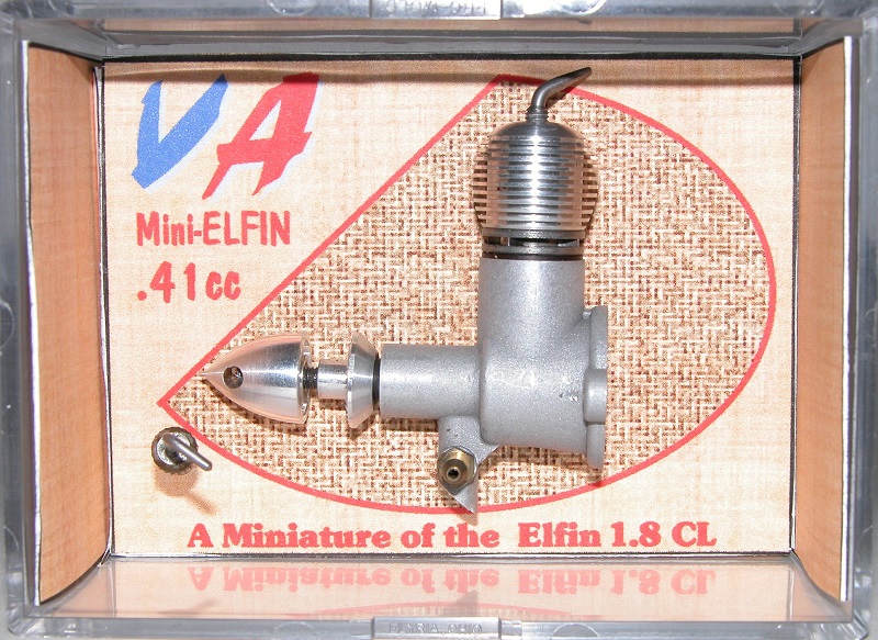

Years ago I was discussing small diesel engines on a phone call with George Aldrich and mentioned I had picked up a VA Mini-Elfin engine and the contra-piston was very tight. George said he had the same engine and used a drill press and a wooden dowel to work the fit with jewlers' rouge. Like Tony said, only fit it at the very top of the cylinder, don't go too low.
George Alfrich loved small diesels and I picked up several AH minis for him.
I still have the engine and wanted to put it on an .020 size Playboy or similar so I may dig it out and get to work.
Here's a picture of the engine. This is the .41cc version, I think they made a .020ci version too.

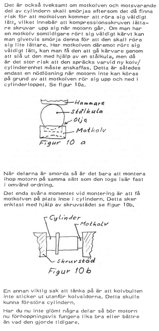

The very good engine builder I know will tell you that the contra must be pressed in from the BOTTOM, carbon crystals notwithstanding. The carbon threat is dealt with by careful cleaning.
I've been wondering how many of the respondents above recommending the contrary have ever assembled a conventional diesel.
The taper lapped into the the cylinder dictates this necessity.. The bore is wider at the ports than at the top. Inserting from the top and tapping it into place will ruin it's fit.
Tapping a tight contra from just above the ports to just below the cylinder top and back again a few times to loosen it slightly is another matter. It's acceptable practice.

Just to clarify here,and most Australian posters know to whom I refer, we had this exact talk years ago about an old well used PAW diesel that had its contra wound right down by my own stupidity and was colliding with the piston crown. And it was frozen in place.
The fix was to drive the contra right down and out the bottom of the liner (with the warning of 'this is not really preferable due to the possibilities of carbon crystals existing") and the bore and contra checked before reassembling from the bottom will much oil used.
This procedure worked, no damage was done and the engine runs like a dream.

I have dug through some old magazine to try and check if my memory has failed me regarding the CP and its removal and refitting.
In the few written instructions I have from the 70-ties there are some note on the webra record engine, from 1977. The instructions clearly state that one should push the CP upwards though the top for disassembly and push it in from the top (in a vice) upon assembly. In the event of a too sloppy fit on the CP one can try to increase the tapering of the CP by fitting a suitable steel ball from the top and gently tap it on a hard surface. This will expand the top part a little, but if done too much there is a risk of cracking the CP and hence to ruin it completely....
