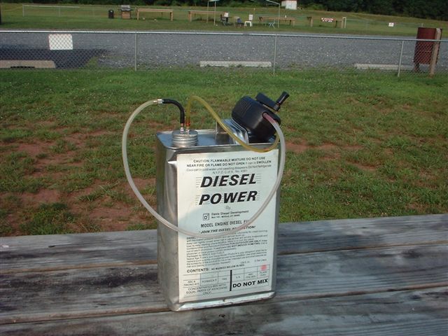

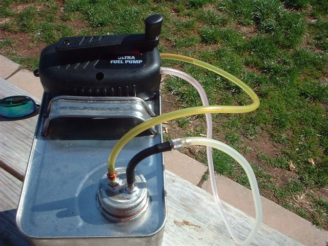

Go ahead and use an electric starter, BUT be careful. Do not prime. One or two choked flips at most. An electric starter will get you going after a second or so. You mentioned that you used a 12x8. What brand? I use a Master Airscrew Scimitar 12x8 and my Mecoa .46 will turn 9,700 to 10,000 RPM. Your OS should be the same or mabey a little better. This Mecoa was my first "large diesel" and I had the same setup problems that you did. Take your time and try to sneek up on max power from a slightly under compressed condition. Exhaust residue may be dark amber but not inky black. With the 12x8 prop my engine was over compressed on the ground, but in the air when I throttled back below 1/2 throttle it burped and missed in a way that sounds quite cool. Transition and power were there for touch and go's.
To keep ypur fuel fresh (critical) and reduce smell. I recomend this method to ALL diesel users. After my first empty Davis gallon I soldered DuBro fuel can connectors thru two holes that I drilled into the cap (using the supplied nuts for extra strength. There is a brass tube to the bottom of the (with 45% bevel on the bottom end) can that the yellow tygon tube attaches to. The black neoprene connector only goes in an inch. I disconnect the filler nipple from the black tubing and 20 cranks (6.5 oz) later I reconnect to the black tubing and fly. My fuel does not go flat! Even the last third gallon can that sat in my garage all winter. No more messing around with pouring fuel from the gallon can to a smaller container. Now when one can empties I just move the lid with tubes. I've been flying diesel for four years now; I wish some one had shared this with "ME" when I started. In the summer time I also put my gallon fuel can in a bucket with whatever "blue ice" pieces I can also fit in the sides.

Francis,
I see the neoprene and tygon tubing but the white/translucent appears to be silicone. Have you had trouble with it? I would have used only tygon or neoprene.

GCB,
I do not know what the whitish looking tubing is made of but after several months of use it shows no ill effects and Hanger 9 says that this pump is for gas/diesel. It is, however, nice and flexible.
