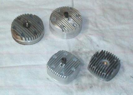

I made today, a diesel head for an MDS 1.48, and one for an ASP/OS .91 FX.
They are just awaiting the viton I O-rings (should be in Monday or Tuesday).
As usuall, made from 6061-T6, finish is a combination of glass bead blasting for the matte and as-machined for the shiny. I have a small setscrew and brass insert to hold the contra adjustment screw.
Tried my new slitting saw out today,its coarser and cuts much better in aluminum without clogging like my old one.
These were made for two of the regulars here.. Hope you guys like em' and they work out. Should be able to ship as soon as the O rings get here and I will include a few spares as I had to buy a 10 pack.
AJC

Well done AJ, they look beautiful, now it's like waiting for Christmas again.

Max - What do you do with castings, when you havent any drawings (unless you also have them for the HP, I assumed not)? Make up your own design I suppose? I think there are enough guys here that are into machining engine parts or complete engines to have some sort of forum, but its also fine for me to have it within forums I allready post in too.
I tell you, the idea of a 1 and a half cubic inch model diesel is pretty awesome... I wish I could be there when you run it up HObbsy! What prop are you going to use?

The new head arrived today and is every bit as beautiful as Andrew's pics indicate. While I was waiting for the head I replaced the sleeve and piston in the 1.48, the ring was rusty as was the rear bearing. It appears the original owner used all synthetic. So, now that I have the old head back I can braek in the new cylinder and piston. The new head fits perfectly and looks good on the engine. As an interesting aside the new cylinder is perfectly smooth inside, no crosshatch and holds compression like a properly broken in engine when rotated by the prop driver. Excellent job Andrew.
