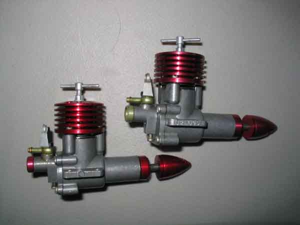

My 2 Mk17's came with 3.5mm and 5mm venturies.
Stewart
Jens,

I have a third Mk-17 that is installed in a CL Flying Clown. It currently has the small venturi installed, just because the plane is small and I did not need the extra power.
Perhaps the larger venturi would be good if you were using a small prop and needed higher power at higher RPM. Perhaps the small venturi would be needed if using a larger prop where the lower RPM would not produce less velocity in the venturi. These are only speculations, that's why I started with "perhaps."
I had no trouble bench running them with either venturi, but only the one is in a plane. Fortunately, so far none of mine are wet nosed.
I remember reading in a review that Ed Carlson included in his catalog, that the BB's are instrument grade. Not necessary, but a nice touch.

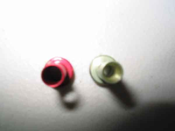

An MK-17 has been lent to me to look at. It is in great shape. It's only problem is that starting and setting a clean run is difficult. The intake cross section is too large. I have to 'finger choke' it to start.
http://www.youtube.com/watch?v=v_DAU-cMQ5s
I wish to remove the "big bore" red anodised venturi insert, and put in the alternative "narrow bore" beige anodised insert.
WIth the NVA removed, the red insert will not budge. I am thinking of using heat and if that fails solvents.
Has anyone changed the venturi insert? If so, how is this most easily accomplished?

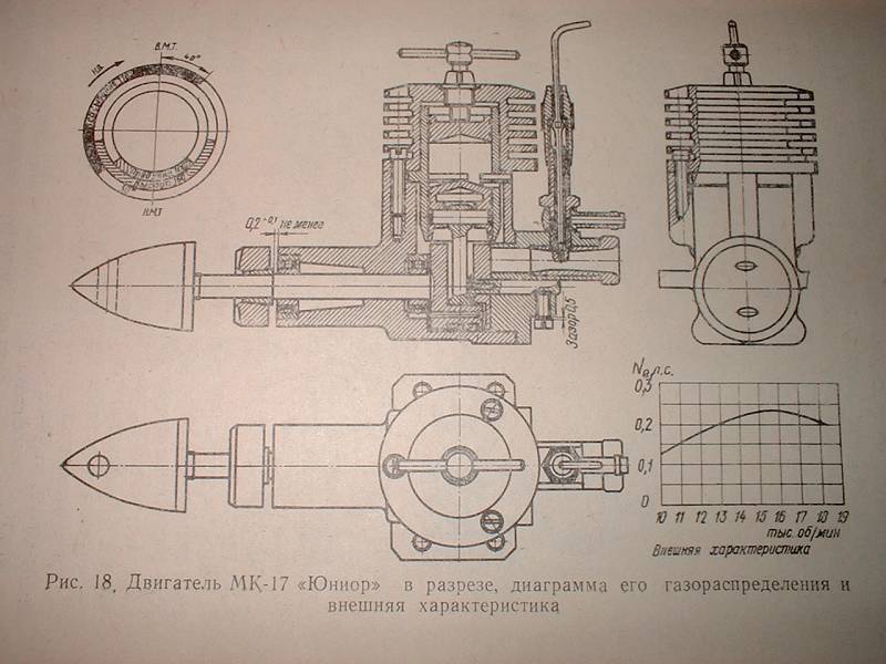

Haven't run mine yet, but the cutaway drawing indicates that the venturi is held in place by the needle valve assembly. Perhaps a little heat will help relax the fit?
If it were mine, I'd simply plug some of the venturi area with a hardwood insert, or reduce the bore diameter with a sleeve, and try it that way.

I froze the back plate, but the insert still won't budge.
The NVA screws into a boss on the top of the intake. the NVA jet enters the venturi through a hole in the insert, which secures what is otherwise an interference fit.
Using compression (such as soft jaw pliers) on the end buttress of the insert will probably result in the insert being forced out-of-round, compounding the problem.
The intake disc valve rotor is pinned to the back plate. Fortunately the pin is easily removable courtesy of a small pin locking screw which can be loosened.
I will remove the disc valve rotor and try to drive the venturi insert out using a suitably sized dowel, after applying a little heat to the exterior of the intake tube. I will need to firmly support the back plate for this procedure. A peice of hard wood with a drilled hole deep enough to allow for insert to back out should be suitable.
Small props or large, this engine is not happy on the large venturi insert. It "wanders" RPM's and will not hold a steady run at maximum setting. I'd wager it would not run steadily for stunt work.
I have made an intermediate sized venturi insert which I am keen to try.
