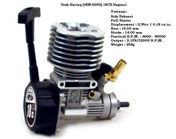

Andy heres a pic of an .18 car engine I bought to convert to aircraft use- my son likes em fast :0, I think it may only spin a toothpick prop up to its stated max RPM's, I may look at dropping the liner to tame the timeing ?

Short stroke, rated to run up to 40K. Kind of the opposite of traditional diesel design. However, that's not to say it wouldn't make a great diesel. Long strokes have longer dwell time at TDC. Does this make them better diesels? Does it matter? How DOES dwell time affect engine performance?
The engine makers have engineers doing what they do best. I suppose what we see on the market is optimized for the purpose. Still, what if, and all that.
No question that Davis is a genius of sorts. A tad energetic though, but that may be just his phone personality. I know that if I'm feeling pressured for time in a conversation, I tend to blurt and overstate my case. Don't know but do know that he comes across too often rather abrasively. Ob1n certainly got put off. I kind of thought that our efforts here, and input, and general interaction would have been appreciated. What if MORE folks got into diesel BECAUSE they could make their own fuel. Wouldn't that mean more engines and heads sold? None of US are making any money off of our efforts to help and inform and promote the cause.
Are races lost due to blown plugs? Might a diesel car engine have a significant advantage? Car guys aren't afraid to tinker to win races. Why not mix your own fuel?
There seems to be far too much mystique around diesel, and that drives people away. It did for me, for a very long time.

What brand of .18 are you working with? Can you post a picture?
The Associated Mini MGT 3.0 is what I am working with......seen here.
http://teamassociated.com/ae/mmgt/mmgt_home.htm
I have the original MGT.....but want to go with a small one because of my track that I have is smaller. I, too, have a problem getting Nitro fuel because of my location and that is my interest in diesel power. According to Mr. Davis in our phone call.....the engine in this truck is, " most likely Thunder Tiger......made in Tiawan. Which, of course, means it is junk". Then he tried to tell me that Associated had been bought out by a foreign company. Last I knew they were still in California. I do not know the facts....but that doesn't seem right with me. Especially after the OS engine story he gave me. He also kept telling me that, " we do not make, nor will we ever, make a .12 diesel conversion". I kept saying," Great.....cause the engine in this truck is a .18 size". He still kept telling me he couldn't help me with my, " .12 sized engine". ???!!!!
