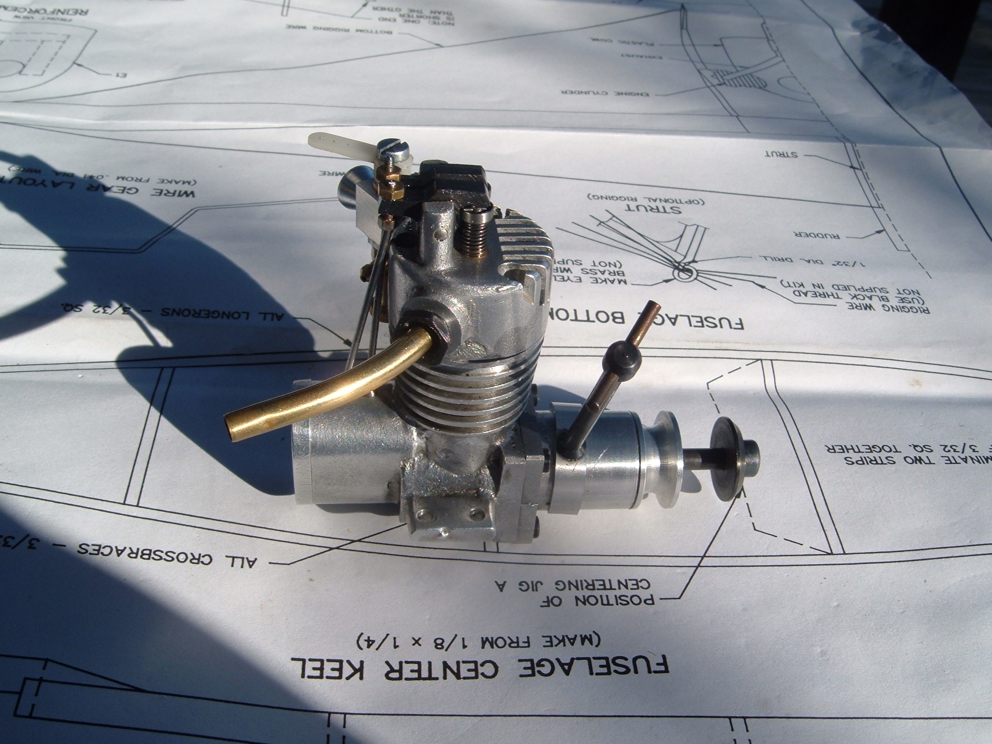

I am happy to report that my new Armin Devries VT-1D 1cc 4-stroke diesel is a winner.
After some running-in, I drove over to show chevy43, RocketRob, and Scallywag my new toy.
This engine is so different from my other diesels and my glow 4 strokes, I am still learning how to start it without taking half an hour!
It runs so well once started that I think the problem is just me. []
If I recall correctly, the rpm were as follows: (using Clutton Olde English fuel)
on an MAS 7x3 prop: 9000 high, 3400 idle (which sounds much lower, being a 4 stroke)
on an MAS 8x3 prop: 8300 high, 2900 idle (or there abouts)
I will be flying this engine before too long, and will post photos when it happens. Meanwhile, here are a few shots of the engine.

I saw DeVries site a couple of years ago when he had the .09 version of the 4 stroke OHV diesel ready for sale. I'm really impressed with his work. I love the variable compression by raising and lowering the crankshaft. Just like on my Telco C02 motor.

That arm on the front bearing... May I presume that's the compression adjustment? Eccentric bearing to raise and lower the shaft, hence rod and piston, for adjustment?
Cute little gem!

Lou Crane; Yes, that is exactly what the lever does! The running position is in the middle of it's range of movement. It's nice because you always know exactly where the adjustment is at a glance.
I ran the engine again today and can proudly say that I can now start it within seconds. Now it is time to mount it and get this gem into the sky!
