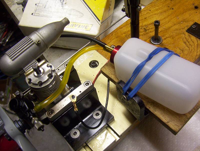

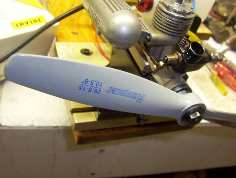

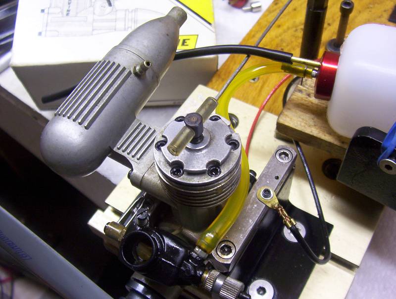

I received a Diesel head for my Irvine .20 in the mail today from Fiery, he had a couple of them. I have it on the engine already, it was missing the grub screw that tensions the compression screw but it is a standar 4mm grub screw and I had one. I will run it tomorrow. Here are a couple of pics. I nade up the 6 oz tank especially for the .20 and will try the Graupner 10.5x6 first, I also have a 10.5x5 and a 10x5.5, my Saito .30 turns the 10.5x5 at 10,400 rpm so I think the .20 should be there also.

Your advice on using a 4 mm grub screw for head tensioning is something I will remember. Make sure you locktite it once you are happy with tension. I have lost more than one of them in flight [:@] because I forgot to do that. You would have noticed the brass stopper in the recess which prevents the bottom of the grub screw from burring the threads on the contra-piston adjusting screw.
In operation you will see a little oil leakage past the contra, not a lot, but a couple of drops per run. No viton rings on these. I have never experienced the contra falling out of the head, thank goodness.

Thanks Derek, the mail lady laughed when she handed the package to me, she said, "all the way from Australia huh, see we're good aren't we", who could argue with that. The brass insert is in place under the tension screw. My Irvine .40D has the reducer in the muffler that you mentioned, I don't think it is needed on the .20. If so I can whip one up in nothing flat. Let me know what JE says about the liner and piston. Thanks again, I'll enjoy it. I have a 20 sized TeleMaster somewhere that begs for that engine.

I ran mine with a 9x6 MA black ... nothin' fancy for the wee workhorse, and it worked well.
It seemed to love to rev, and made a wicked burble on the overrun when you throttled back quickly from max revs ...
