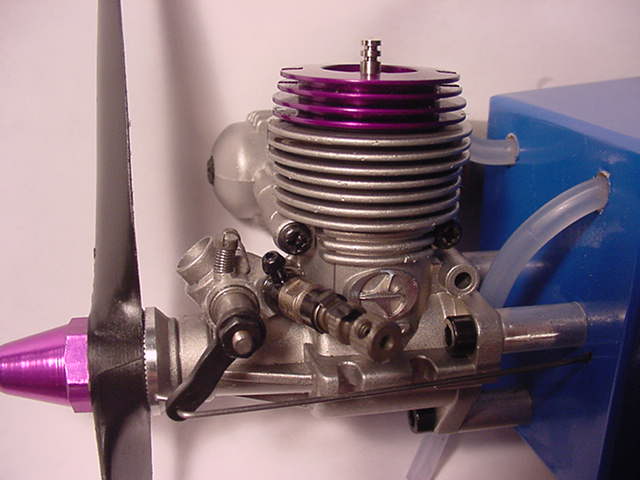

I have ordered the new GP 07 after looking at the parts listing,, they show a head and a combustion chamber thus 2 parts I would guess a combustion chamber is the glow insert for the plug. As soon as I get it its going to Davis he thinks a diesel insert can be done with the thumb screw and spring ala the OS 10 and should be inexpensive $20 ?? this engine has both beam and radial mount
features nice for small stuff, no engine mount beams, just bolt to the firewall and its only 3 oz martin
WARNING this the the new one GP 07 do not buy the old one if you are thinking about this , I will report back if this all cones together
test run and let you guys know how it does

Nice to see some more people having a "go" at this engine.
I've seen reports on the newer version and the performance is not better than the "old" one...
The only visible changes are cosmetic to the case, the rest looks the same.
The glow version is weak but quite easy to bring up proper power, the head is a two piece (as said above) and it is therby quite easy to remake the combustion part as there are no threads to make.
Places to get more power from on the older glow versison:
- make a head that takes turbo plugs
- enlarge the throttle barrel
- enlarge exhaust outlet
- remake the case so that the ports in the case and liner are matching
These changes will take the power right up to pair with the Norvel .074, i.e. around 16700 rpm on APC 7x3.

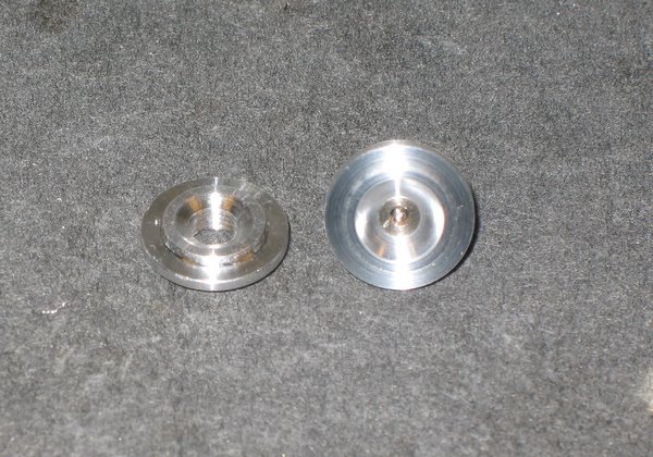

Just thought I would throw in a picture of the head part that one would remake. The left one is the stock one for a regular plug, and the right hand one is the one that I've made for turbo plugs.

AMB asked after the cylinder head with contrapiston inside instead the cylinder head with glowplug to run as diesel engine.
I has the Thunder Tiger 07 GP converted as diesel engine

The older TT 07 GP engine has bronze bushed bearing with purple anodized head. But the fit between crankshaft and bronze bushing are a bit loose fit as new engine.. Do not affect leakage since the engine get enough oil to seal between crankshaft and bronze bushing.
My engine has cylinder head in steel with contrapiston in steel with O-ring. The purple head are a ring retainer for the cylinder head.
The engine are running well as a diesel engine, much better than running as a glowplug engine.

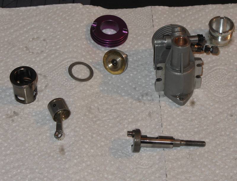

I almost forgot what I wanted to say here (please stop me if I ramling). I took my engine appart tonight and the connecting rod looks much better than I remembered. It is not bushed but it looks strong and has a lubrication hole (see pict below).
I cannot find anything wrong with the bearing surfaces of neither crank or case. Both parts look shiny and well mated, it is possible that the mating prosses is what I have felt and misstaken for a large wear, but still I cannot believe that it is meant to be this sloppy. I can clearly wiggle the crank in the radial direction. [:'(]
Fitting the crank in a new case gives exaclty the same sloppiness, I find it hard to believe that it would be the crank that has been worn rather the bronz bearing though. Guess I will just have to run it some more and see what happens...

The only thing do I have an issue with is the sloppy crank, there is a clear radial play straight out of the box...
