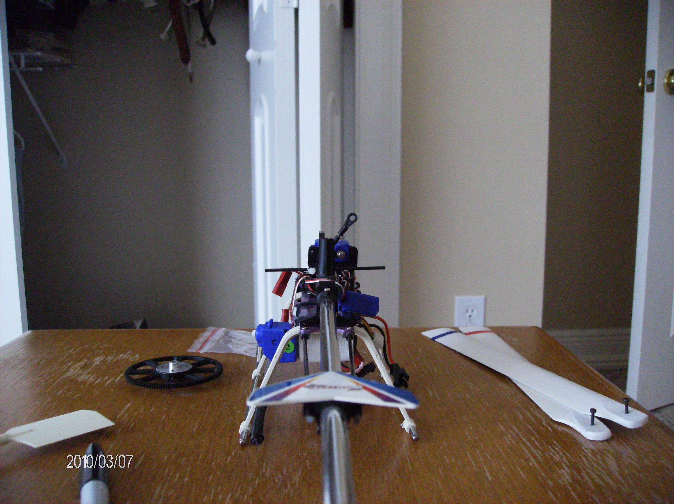

Ok, I just looked at it right now. Spun it up and checked the blade tracking (which was fine), but notieced that the entire rotor mast (the large gear, main shaft, and linkages are all tilted to the right of the heli when looking from the back). Now I'm going to attempt to remove the shaft like you said, which is to remove the linkages from the swash plate, and remove the allen screw (Jesus Bolt?)from under themain gear. Then will see if I can straighten it out. Thanks.

Ok Andy, just got the rotor head out. Can you help me getting the shaft isolated so I can roll it down that piece of glass.
Also, my other concern (if it's not the shaft) would be the main shaft mount (the thing that sticks up from the heli frame). If this is tilted to the right, is that bad, or do the helicopters come like that to compensate for torque when at high throttle and high blade pitch. As a pilot, I know that most helicopters have this tilt of the mast. Thanks for the help!!!!!!!

do u see any cracks on the main frame at the main shaft? The main frame is the part you rarely have problems unless you crash it so hard and damaged badly. if your main shaft is bent you can not straight it out unless you have the machine to do it.
