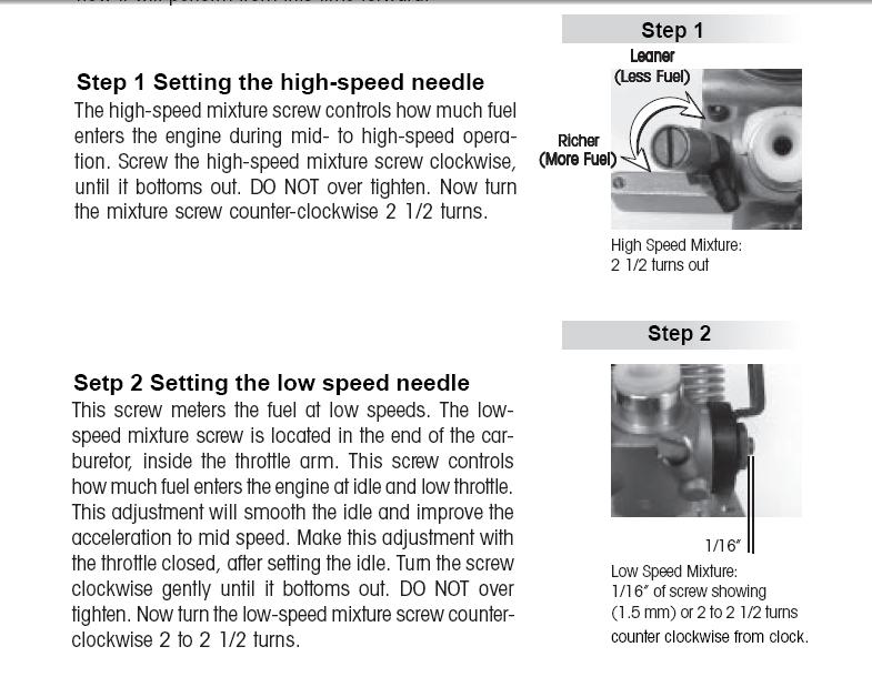

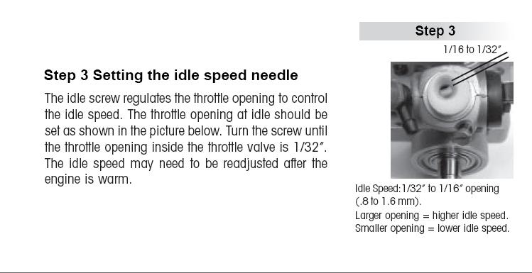

And here are some pics of carb settings. But also keep in mind you have to tune your own engine, each engine is tuned different from motor to motor, the temp outside has a big effect on how it runs the colder the richer the hotter the leaner[sm=tongue_smile.gif] I think thats how it is. Someone please correct me if im wrong.

Carburetor Settings
