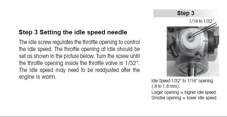

Make sure your carb settng/ the idle screw looks like this.

does the small black screw in front of the carb control that idle or do you just use the trim on the remote? Also do you have to prime yours by putting fuel in the carb to get it to crank every time?

The small screw in the front is how you set your idle, and if there is no fuel in the line you do prime it.
It will take a few cranks before it starts, because its cold.
