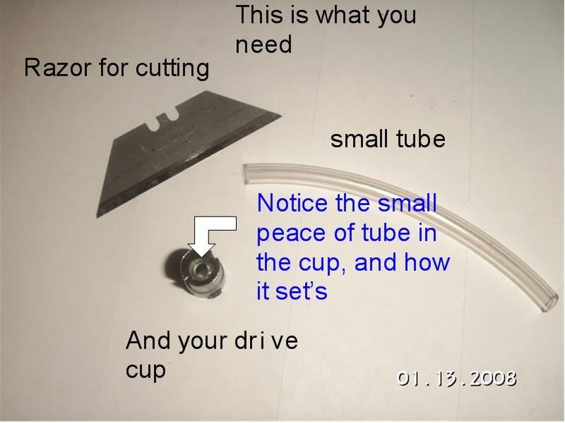

In the cup that your dogbone set's in, look in there.....ok seee there is a little round rubber O ring, That is a O ring.
Plus you can not I repeat can NOT go by the parts book they gave you, I ran into the same thing and what they was calling for was way longer then what I needed, what I would do is go to the redcat forums and tell them what your looking for, and they will get you what you need. http://www.rcuniverse.com/forum/foru...smode_1/tt.htm

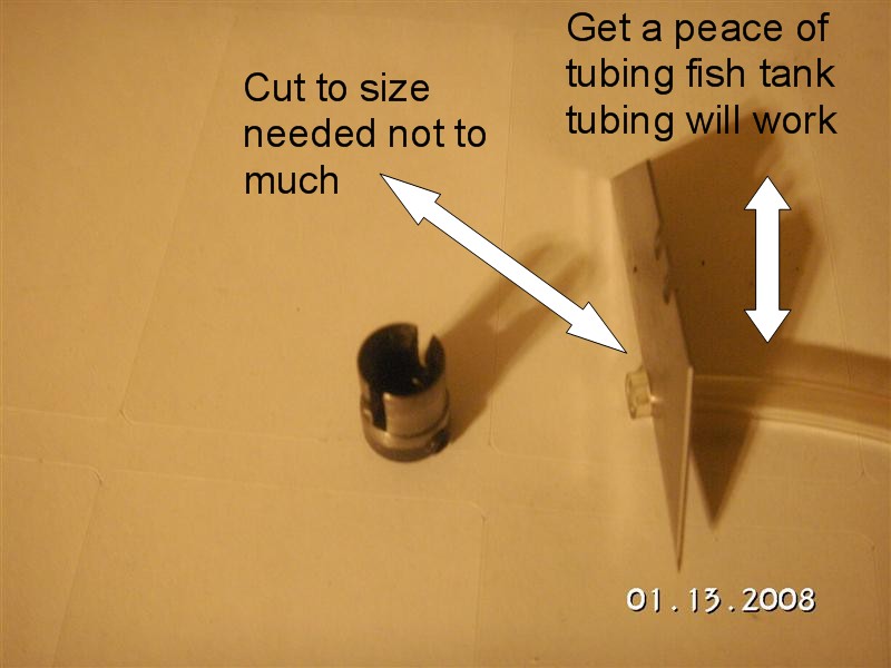

Then what you need to do is add some O rings and that will take up the slack give me a minute and ill post a picture of what im talking about

Ok here you go if you dont understand just ask.

Ok put a piece of tubing in both sides where axle goes?

Yeah but make sure it isnt to tight when you put it back together
