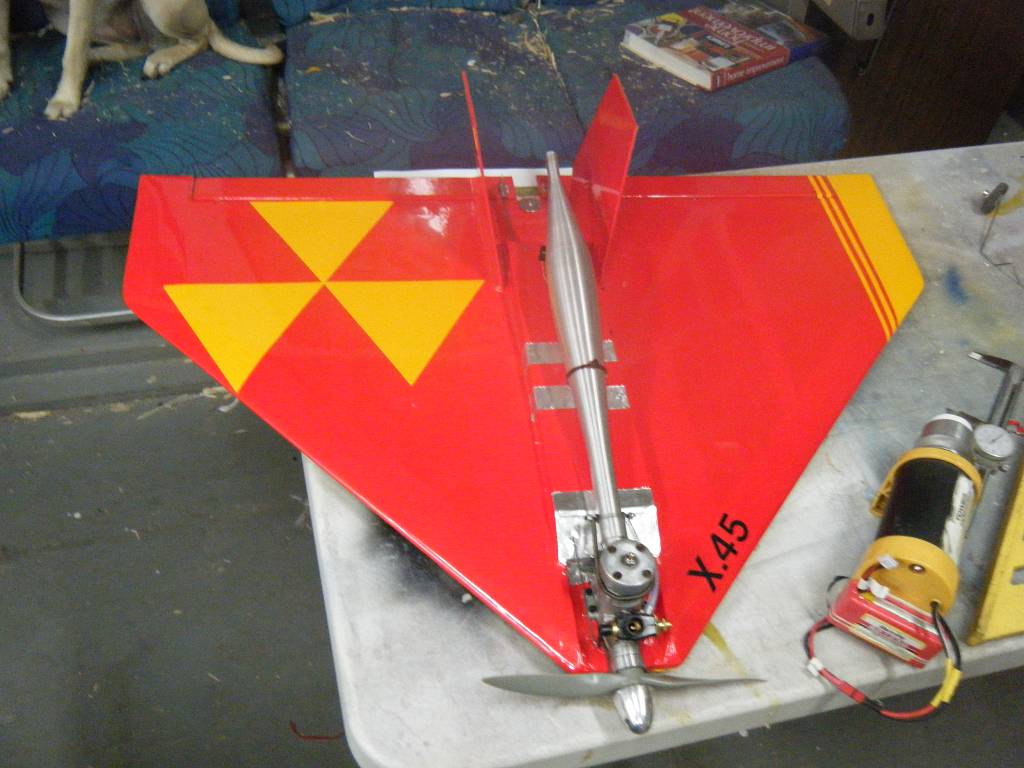

Yup another Demon is ready to fly
Here are the specs:
Engine: Super Tigre X45 with factory tuned pipe 9x8 @19k
Servo: HS 225 MG
Battery: 6V 2000mah
Cover: Ultrakote
AUW: 2lb 13oz

Well that Demon didn't last long. Flew it for the first time yesterday and it was the last. It launched great, and a few clicks of trim was all that was needed. The ST X45 ran like it should. A couple of passes later the engine went to full idle and she rolled right then into the ground. Not sure what the deal was yet. I know my dx7 lost its link because the throttle at idle was the position the stick was in when I binded it. And the right roll is where it was when the bind locked in before I trimed it. The battery showed plenty of juice I had a very nice HD switch. All I can see is that the satellite rx was dissconected but the rx and the satellite were in the same placed the were mounted. Could I lost signal if the satilite thing became unplugged????

The engine is fine. Maybe I put the satellite to far away putting some tenchion on the plug. Oh well SH** happens. Already mounting the X45 into a Weston Magnum R. Having to make a new canopy section to cowl in the pipe for the rear exhaust ST x45. The Demon was very fast had 2 full throttle passes. It was passing a electric s400 like it was standing still and that plane has been clocked at 142. The 2.4 stuff is still a better system them my 72 was at our field. Whould the satellite coming unplugged cause the loss of signal??

Losing the satellite receiver connection after the receiver is turned on and bound will not lose your bind. If the satellite is not connected, you cannot get a bind when you first turn the receiver on.
Old 04-25-2011 | 12:02 PM
Joined: Jul 2006
Posts: 927
From: townsend, GA
Default RE: Another Demon ready to fly AND CRASHED
Okay would it reduce the range?

Was main reciever blinking? Indication of brown out, (or failsafe activation, I think)

ORIGINAL: airbusdrvr
Not true, or rather it may not bind without the satellite, but it will power up fine and work okay without it. This means bind with the satellite, then dis-connect it.
I've flown one of my planes without a satellite hooked up at all (new build, left it at home). Had no problems with the plane, flew it about 10 times that day.

I have a JR 9503 and you will lose signal if the satelite is unplugged. At least one satelite receiver must be plugged in on most 2.4 rx's, that use them.

I was using a JR 9303, satellite not connected, flew fine.
