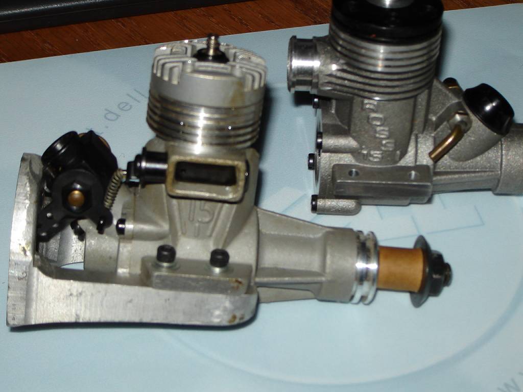

The Nelson .15 FIRE was at the top of the heap at the end of QM15. Here are some others that also had their day in the sun.

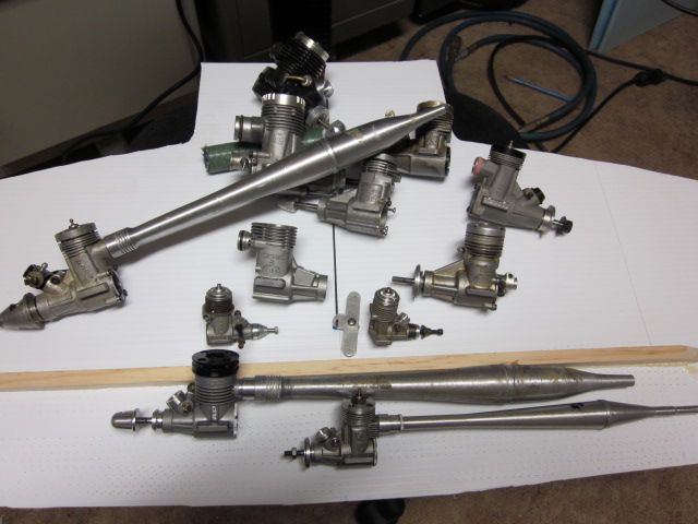

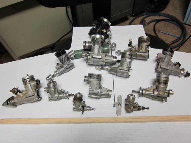

Couple of Supertiger RR RE, and some other various rear exh. smaller stuff. CS .049, Uktam (MDS).15, AP .15 I have played with lately. K&B .29 RR RI. A little trouble with pics. I'll keep playing.

I think I got a Rossi, Stels, AMEand a Cox Conquest in there too. If you want a fast motor, I think a front intake is faster. That is likely why they don't make them any more. The team race diesels use them because of the tighter base compression giving better mileage, but I think the friction frome the rotor slows the little ones down too much. The smallest RR I could find is the K&B .21 from Mecoa @$200. There may be some little diesels I amnot aware of. Any front intake better quality european motor would likely matchthem for perf. and maybeprice. Novarossi, Picco, Profi, Fora.

The K&B is a .29. The Rossi's and Cox Conquests were faster than the Supertiger X .15 back in the 1970's. They have come a long way since then. We were going 160 mph then, now they are over 200mph in FAI Speed (F2A) They use FI for all of it now. I would have to say they are overengineered now, for anyone that is not serious. They sure sound wild though. I saw a Rossi ducted fan motor in the rc canada website for $300. it is a .65 cu in. It is a rear rotor rear ex. probably.
