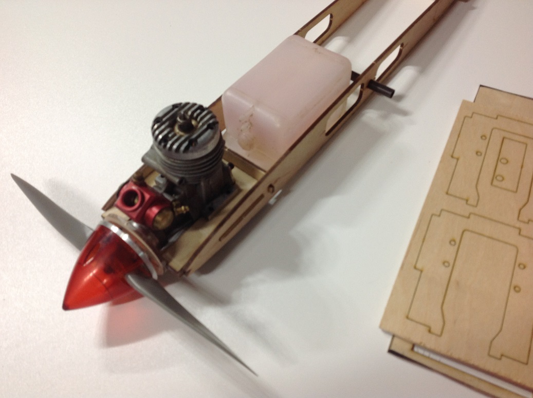

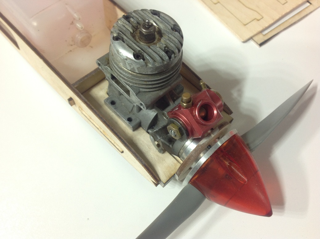

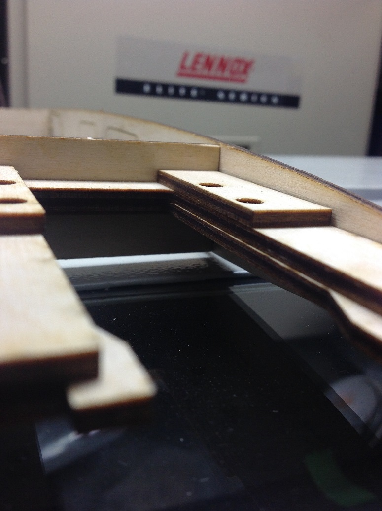

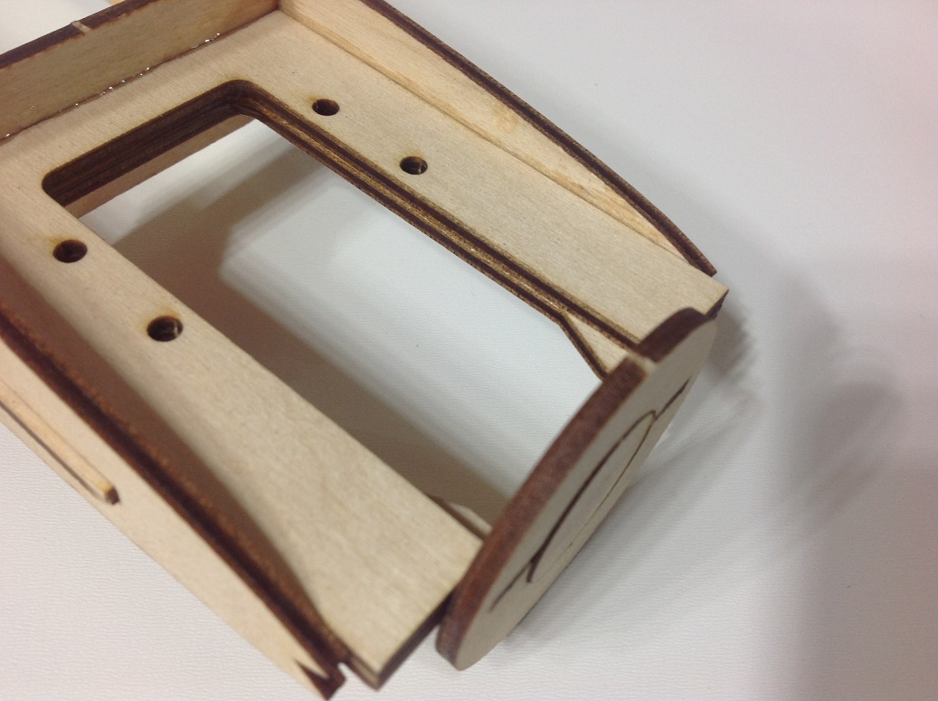

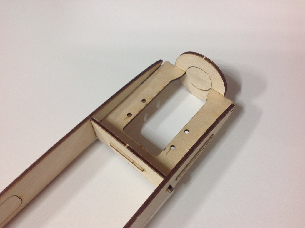

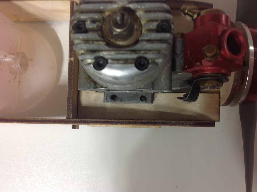

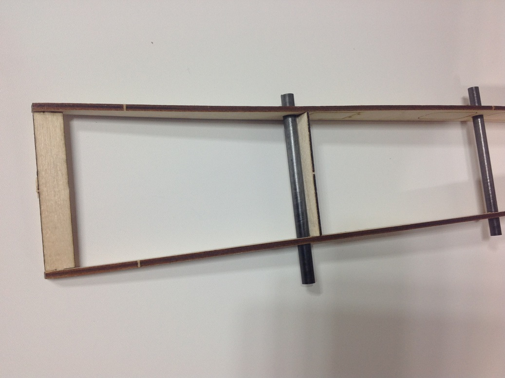

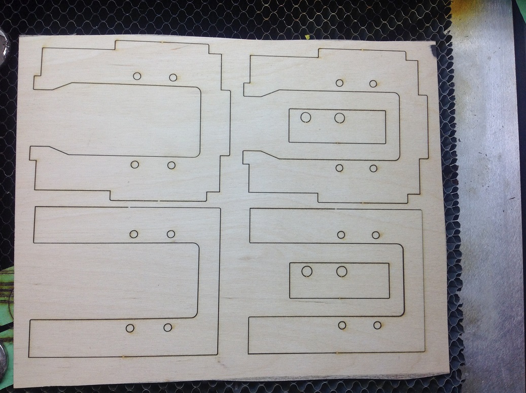

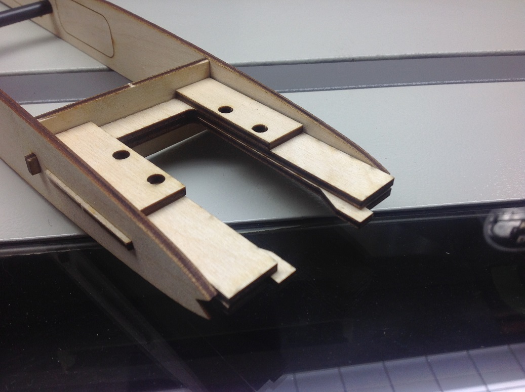

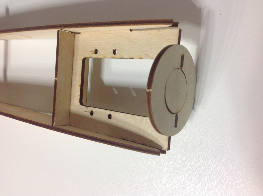

Progress report for this evening: cut all new motor mount plates and doublers. This is the OS46 bolt pattern set.. Perfect fit, I found some old engine that had the same bolt pattern to test, check it out:
Get this.. the entire center assembly, with the spar stubs (3g each) is 85 grams. That's everything in the last pics except the hardware of course, with the whole thing generously CA'ed together. All plywood.
So I weighed a Hayes AS-40 engine mount to compare - 51g! I like it.
Next on the list.. OS .32, and I'll see if the NovaRossi site has the mounting info. If not.. I could use that.

BTW - that is a GP 10 ounce tank.. lots of room.

I cut four sets of OS32 bolt pattern mounts last night, and set the prop driver 0.1" ahead of the nose ring. Bonified WN - the ASP should fit this bolt pattern, see below.
Running a big block requires a bit of improvisation, I don't have a CAD designed mounting scheme yet. In truth it is best to wait for a modified version for this format engine - a bit more wing, tank on CG etc. I have been sketching ideas, they will come.
This is handy info below - and the OS site has bolt patterns as well. At the Novarossi site, you can download corporate logos in various formats, and buy hats and T-shirts, but you can't get &#^%#$@ dimensional specs for the engines, only very badly translated instructions.
Here are the OS46 and OS32 bolt patterns btw. For other engine mounts I need:
A,B,C and E. I need E to locate the engine fore-aft.
Editing and cutting the plates is easy for these onesie twosies right now. For future, I will mount plate sets separate from the other parts so they can be a la carte.
