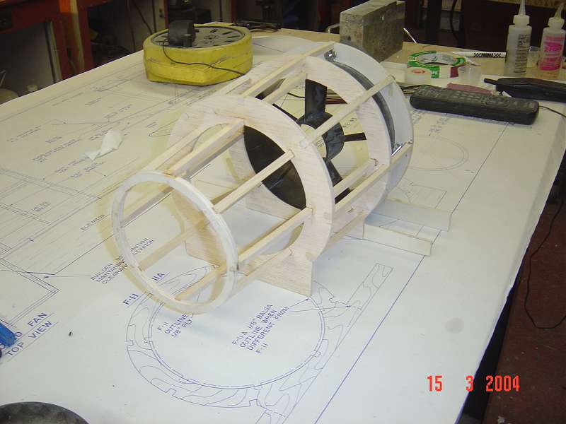

My Enforcer is coming along nicely. Fuselage is 90% complete and wing is about 50% complete. Hopefully it will be ready to fly within two weeks at the most. I'll post some pics when it's ready. I am really impressed so far.
BTW for those that don't like the canopy, I have not trimmed the front ply decking fully and left an overhang in the cockpit area. This means that I can cut the canopy shorter. It's looks a lot more streamlined.
Just to expand on my elevon setup. I am planning to use four servos and split the elevator in half. This may sound like overkill but I am using the model as a test bed for my Kangaroo. I want to test the radio programming before I put it on my jet.

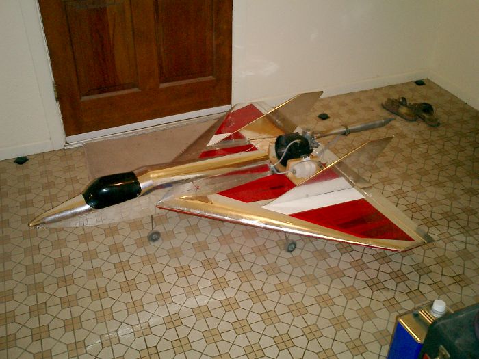

Another fab looking delta....or canard in this case.
I assume its been moded BIG time?
Im amazed at the width of the prop gap on these things.

The plane pictured above is what they call a Cranked Arrow Canard. Nobody makes a kit of it, but the plans are available from RC modeler. The Name is Crusader II.
It is a 40 size plane which I used a Webra 50 on, retracts, and the canard wing is full articulating, in other word the whole thing moves. The Cranked Arrow term comes for two angle leading edge of the wing.
The interesting thing is it's a lifting body design, sim to the space shuttle, It likes to land with somewhere around 25 degress nose up.

OK...before you look at these pictures, please keep in mind I'm not one of the greatest fabricators [sm=rolleyes.gif].
This is my Enforcer - modified with a Dynamax fan and an OS 91 DF. I see now why so many people use the Byron fan with these planes....the Dynamax puts the motor further back on the plane. It took quite a bit of weight in the nose to balance...which makes the plane a little heavy.
The conversion from prop engine to DF would have been easier to do during the building stage. My conversion was quick, ugly, and easily converted back to propeller power if I so decide. The header tank is a little on the big side, but the 2 ounce tank I had before had a mishap with the rotating fan...It's a learning experience [sm=rolleyes.gif]
Flight performance is much the same as it was with the Tower 75 and pusher prop the plane flew with before...lands a little hotter, I'm sure because of the added weight needed to achieve correct balance.
The best part of all this...I have virtually no money in this plane. The motor and fan were left over from an old YA A-4 experiment (which was originally picked up in a trade for an old laptop I didn't use), and the plane was given to me by a gentleman in trade for some building time. Only thing I did before flying was to upgrade the standard servos to Hitec 625 MG's, and install a receiver. Servos are sitting in the wing near the surfaces to eliminate the nyrods. The ailerons and now functioning as elevons...and it will have working rudders as soon as I get the time. The throttle servo will be moved to inside the wing...as I said, quick and ugly. If I get really motivated, I have a set of Rhom-air retracts that would clean things up in the air.
The fuselage contains 2 tanks (16 ounce and 14 ounce) since the narrow shape prohibits a normal sized tank from being installed.
Now if I can find a reasonably priced turbine to put on here...

First time I've seen a tractor fan on an Enforce, most are pushers. Go a few post up and there are three pictures of a nacelle (Fan Housing) for the enforcer I'm building. this is for a pusher fan arrangement.
Your extra nose weight came more than likly from the pipe and support, that a looooong moment arm hanging out the back, and the further the weight is from the CofG the more weight it is going to take to balance it.
the ideal placement when doing a regular enging to DF conversion like this is for the engine to basically end up in the same place, I would say your engine fan assembly could come quite a bit forward. but hell, if it works fly it

I thought about moving it forward, but I worried abnout having the thrust line somewhere else on the plane. The fan is in the same location as the prop that it replaced. Did not know if that made a difference...
Knowing what I know now, I would have looked around for a Byron fan unit...but I already had this, and made it work.
These things sure are noisy!!! I like it!!
