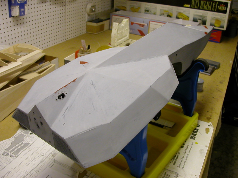

Here's some shots of my bashed stealth Enforcer. It's about 10 years old and just in for a repaint. Nearly 100 flights, Supertiger 90 pusher, spring air retracts. Flies great and gets a good deal of attention at the field.
Enjoy,
Chuck

interestingly nice!

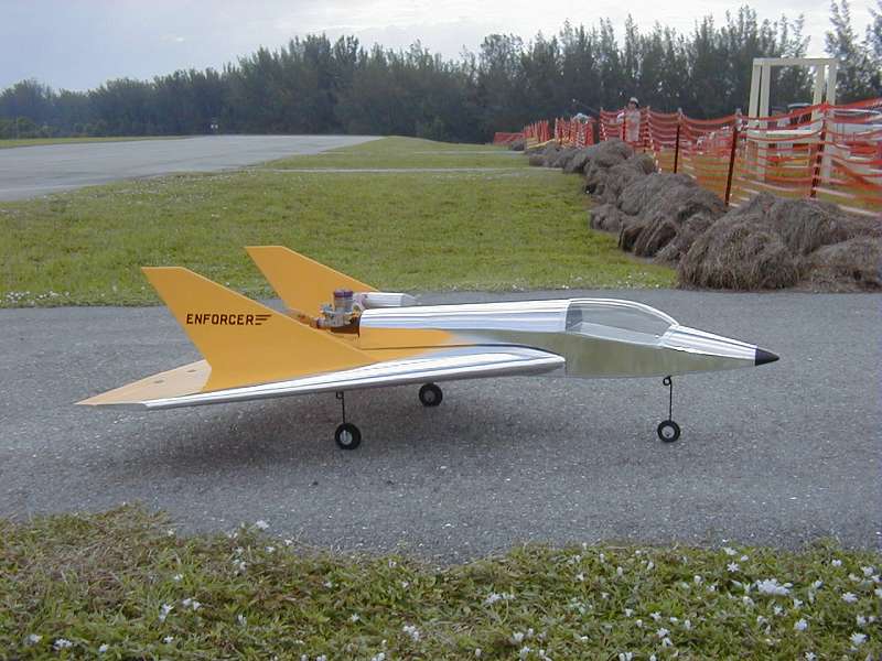

Hi Rototrack,
The Enforcer is a kitty-cat. I started with the recommended throws and increased them after a few flights.
I had a lot of problems with taking off. I used retracts and the nose gear needed to be bent backward (caster) before I wasn't flipping it over on the runway.
I have the Tower .75 with the 11x7 apc. Great combo.
Have fun & good luck.
Bill
PS Don't forget that there is no rudder when landing. I forgot an did quite a bit of damage the first time. After the rebuild I mixed rudder into the aileron channel - just in case.

Hi Fred,
It does land slow and it is stable. Now that I crashed the first time I doubt if I'll forget that I have no rudder but I like having the rudder mixed into the ailerons. Mine sits nose down a bit so it takes a bit of runway for the rotation... then straight up (if I want).
The Jett .90 would be great...I had one but sold it. You probably know how loud they are... but very powerful.
The Tower .75 turns the 11x7 APC at 14, 700 rpm on 15% CP. Just at 15K on 30%. For $100 bucks it's great for me.
Bill
