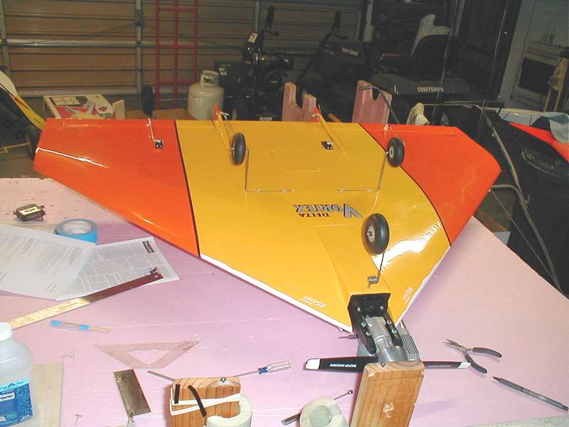

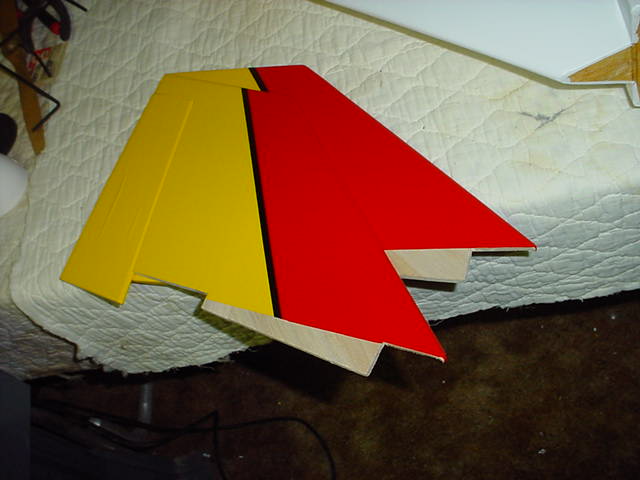

My first delta...too big to be fast, but cool anyway. I just started putting it
together. Not much to it....engine, tank, wheels, two elevons, and two
rudders. I don't know what to put in it, it calls for a 90 two stroke, or a
90 fourstroke. The instructions say over and over not to overpower it.
Who....me ?
FBD.

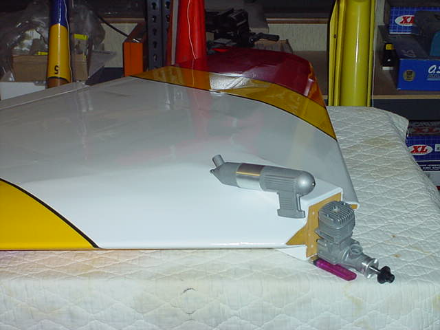

I haven't seen one fly either....I was going to put the 1.08 in it, but might
go with an ASP .91 ringless ABC. The 1.08 weighs a ton.
The plane is big....the .91 looks like a pip-squeak. [X(]

I have a slug of .90's, but the ASP sems to be the tamest of the bunch. The
wing is really fat....the instructions show the S.T. .90 in the nose !
I don't have the G-90, but the ASP fits real nice, and should be a trouble free
power plant. The muffler on the 1.08 is a clump. I do have a YS .91FZ indabox.
That might work....it uses an upright engine anyway. I'll size it up tomorrow
and report.

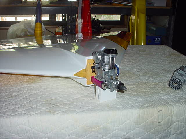

Rudeboy....the thing is 4" thick, but only weighs 2 lb 14 oz !! That is the
barebones airframe....it should be "King of the Floaters" if I don't get it
too heavy. The YS .91 FZ looks great in it, but it has way too much power.
Dave.

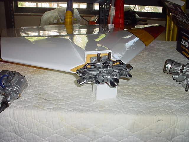

Thanks Mike....I think you're right. With just about the fattest wing in r/c
modeling....nothing would drag that monster much past 90 on a good day.
This Saito 90 flat twin is cute, but probably not much for performance....
might be better for a Cub or something.
I'm still digging in the engine closet.
Dave.

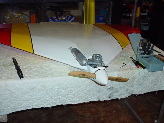

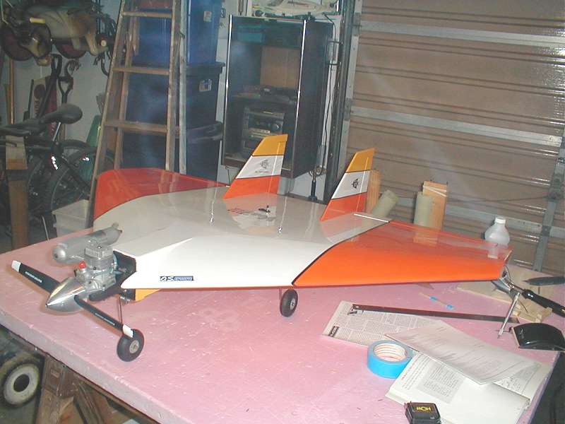

Yep....the ASP won out, it fits perfectly, and looks much better when mounted
in position. I'm using the clear "practice" cowling for fitting everything up. The
cowling comes right to the edge of the carb, and all the hot parts of the engine
are sticking up in the airflow. I'll weight it and see how heavy it is....I suspect it will
be a tad lighter than the Super Tiger.
I checked the firewall, and it has triangle stock on the sides only. I'll fix that, and
put a light coat of epoxy all over the tank compartment.
FBD.

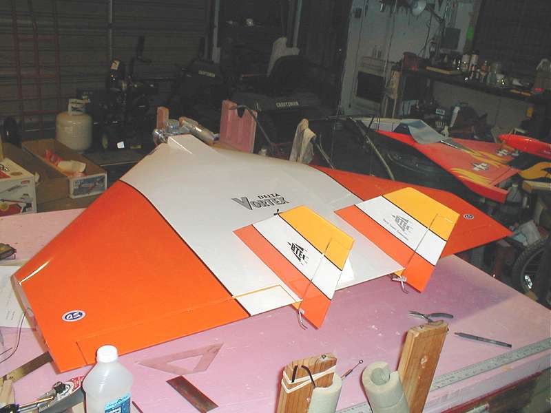

Strykaas....this one is an ARF. It was the last one Cermark had. I can see
why the deltas are so popular, there's not much to them, and they fly so
well. Maybe only the ARF's came with the clear cowling.
The backplate on the spinner is black, the prop looks small but it's a 13-7.
I got the mount, the engine, the tank in, and the cowling cut yesterday, as
well as the throttle and nose wheel rods. All I have left is the elevons, rudders,
servos, radio and wheels....and it's done. I'll use the airbrakes just for kicks,
especially if it needs weight in the back. I might put a brace in between both
rudders too.
Off to the hobby room.
Dave.

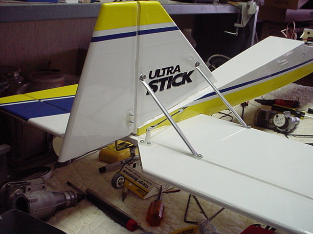

Dave... how are you going to use the rudders for airbrakes with a brace between them...?
Old 07-22-2005 | 10:51 PM
Flyboy Dave's Avatar
My Feedback: (21)
Posts: 13,864
Received 10 Likes on 10 Posts
From: Pinon Hills, CA
Default RE: Delta Vortex
....the rudders deflect "out". I was going to use a brace like these, just one
on each inside vertical stabilizer....to shore up the fins. They will get a lot of
stress if used as airbrakes.
Even with these on the Ultra Stick....the rudder could deflect 90 degrees, if
nothing was in the way.
The fins just glue into a slot, they could easily be bumped and damaged in
transport.
Dave.
