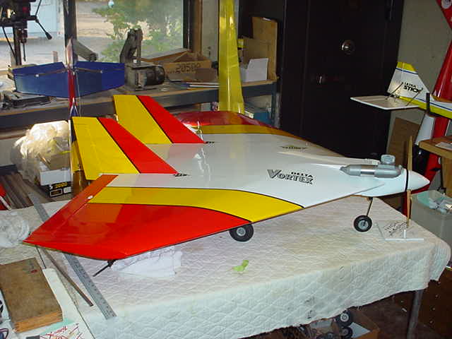

Well, I got 'er done....might try to run the engine tomorrow. The weather has been
crummy, and the field is closed again....the dry lake is wet again. []
FBD.

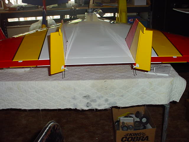

The rear fins don't need bracing....they are solid wood, and fit down deep
into the wing. When they are solidly epoxyed into place they are very strong.
The air-brakes are kinda just for show, I think....and if I used a 90 degree
deflection in the rudder, it left too big of a gap in the hinge line. The rudders
are too small to any serious braking on that big a plane.
Dave.

Nice job on the plane. It looks like it might do a little help on final or in slow flight configs. Every bit of drags helps from time to time.
Thanks for the good pix!!!

Yes....it might be fun to hit the brakes to slow it down a bit, but certainly
no fancy airbrake coming straight down. The plane came in at 7lbs 10oz.
Dave.

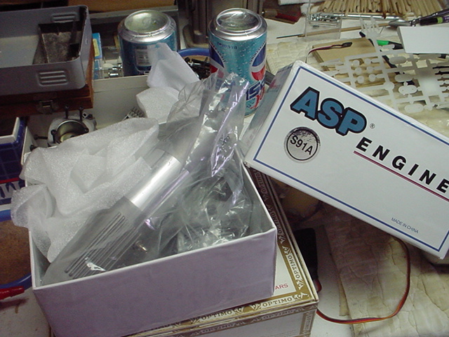

Hi, James.....I'm digging in the MA box now.
I had trouble with the engine....my first ASP. It banged like heck on the 15%. It
didn't like it at all, and it blew a new Miracle plug on the first run. I got a fresh
can of 5% PM and added 3 ozs of castor to it....that was better, but it was
still knocking. I put a K&B 1L in it (med/warm plug) and it was a little better. I
had 20% oil....almost half castor.
Then I put in a #4 cold Rossi plug,and it was pretty happy. I still had to richen
the low end a tad to keep it from knocking coming up off idle. It was a subtle
noise, but it was there....you know my ear is keen for the engines.
I might just get another head gasket and de-compress the engine a tad, that
was rediculous. It doesn't seem like I hurt the motor....good thing it was nice
and tight to withstand all that detonation. It would probably run just fine on
0% nitro. Basically it runs like the Rossi .45's....low nitro and cold plugs.
FBD.

It has one of those extended mufflers, like the Magnum .91's. I didn't check
for a baffle....it's not all that quiet.
It's only turnin' 10,800 [X(]
Dave.

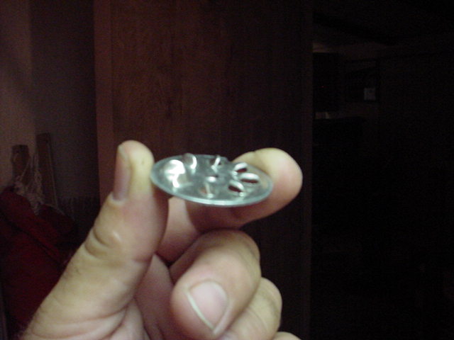

I think I found the problem....a defective ASP Miracle Power Disc.
....some one had cleverly consealed it in the muffler. [sm=stupid.gif]

Well, I got two maiden flights in today on the delta....it was a kick. [sm=thumbup.gif]
The delta really loses altitude in the turns because of lack of fuselage (I guess)
and it was a bit "different" in flight....the landings were perfect. The thing glides
in and slows perfectly, touching on the mains nose high. I didn't try the air brakes,
I think they are cool....but that's about it. The nose wheel was coming loose and
changing adjustment....I have to grind a flat on the shaft. Other than that, no worries.
I'm going to prop it down a notch too....the engine isn't completely happy yet
and it doesn't need all the speed it has on tap. All in all, the plane is a success
and a worthwhile dive into the World of Delta's.
FBD.

ORIGINAL: Strykaas
Dave,,
have you tried the speedbrakes ?
No, Strykass....the flying wing slows down nicely being so thick. I flipped them on
after I had touched down on the second flight, but the wind was picking up, and
I couldn't tell much about how the plane slowed with the air brakes on.
The engine is still not happy for some reason. I has a 13-7 Zinger on it. The
manual only calls for a 12-6....yes that is correct, a 12-6. [X(]
That's a .60 engine prop....and it's only turning 10,800 on the 13-7.
So much for "90 size power in a .60 size case". [:-] I put a 12-7 Zinger on it.
My .60 size OS RF turns the 12-8 Zinger at 11,400....giving about the same
power as the .91 ASP. The OS, of course, is a long stroke....and runs on 15%
nitro. I'll give the 12-7 a try, it looks small on the plane.
You can tell the ASP is just not "on song" in flight. I think it has too much
compression....you should have heard it detonating on 15% fuel. [X(]
Any thoughts on that Strykass ?
Dave.

Mmmmmhh have you tried other glow plugs ? Did you try the std OS 8 ? IMHO a good starting point ... then move on to Rossis if not good... Try less nitro perhaps too...
The point is to find the good plug/nitro %age, as you probably know.
I've never heard about engine gurus using head shims on ASP .90s ...
If nothing works, then why not put the baffle back in place, I know this is stupid, it shall not solve your problems, but... one never knows...

Dave- Could have had a worse maiden flight so that seems like a minor problem- It sure looks sharp! I really like the "K" prop. on there, it does look scale... (What engine is in the Cessna again?)
You remember that Rossi-60 that was "Augered", it will turn a 12x7 APC @ 13.4K on 5%, that'd be interesting on your Zagi, err, I mean Delta Vortex!
Seriously when should we have another El Mirage Matsre Airscrew fly-in? I know you fly there with some buddies pretty regularly (when its dry-) but it'd be fun to plan a little wing-dinger and invite any local revvers out---
