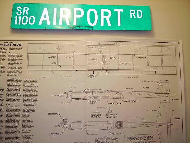

As promised, I am starting a build thread for the a Lanier Dominator 200. I plan to power it with something hot, and I plan on it being a ton of fun. I placed the order with Tower I think last Thursday, and hope to see it soon. I'm starting the build thread early because I also have to build the work shop! (well, sort of) I am a student at Auburn University and I'm a little cramped for space, so I plan to transform half of my closet into a work shop for this project. Fortunately, I have a walk in closet, and this is going to be a small plane. So wish me luck, and enjoy the next several posts as I go from shoe space to hangar! Below are pictures of my closet before I begin renovation.

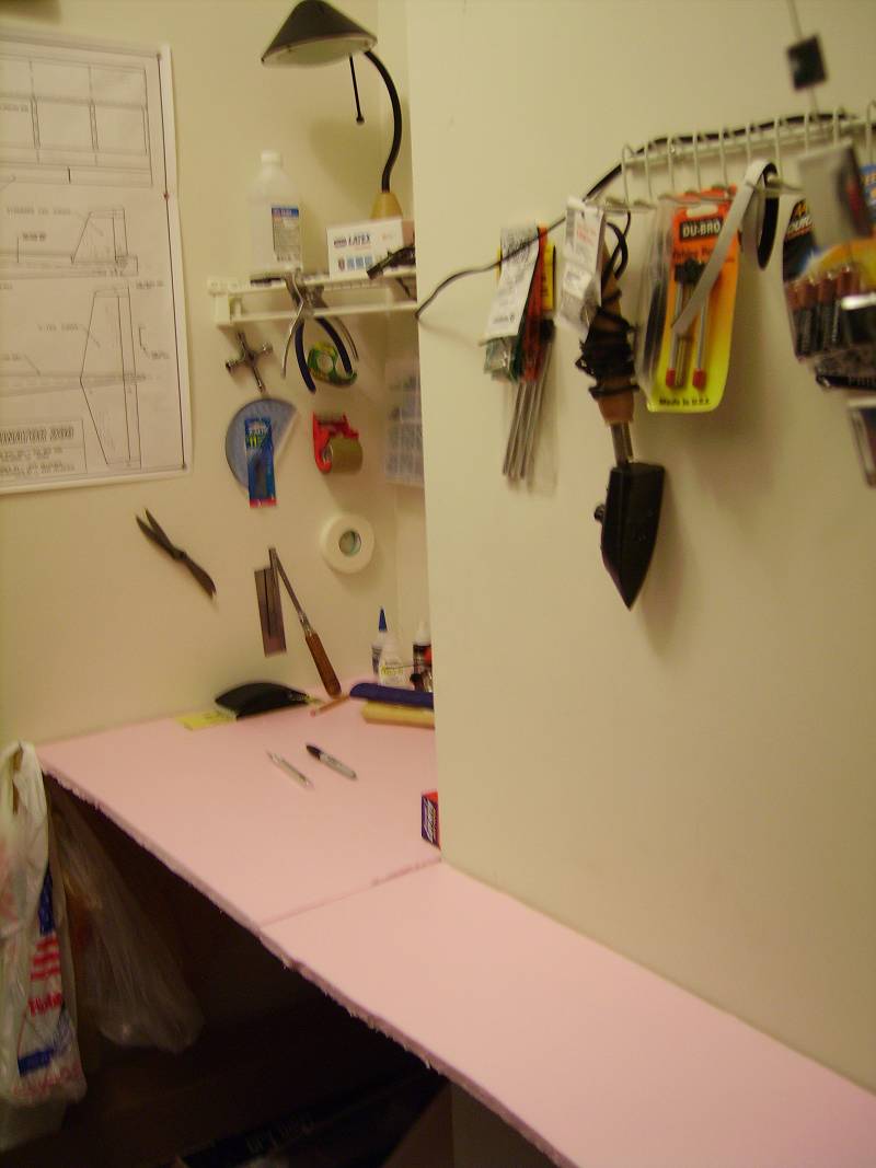

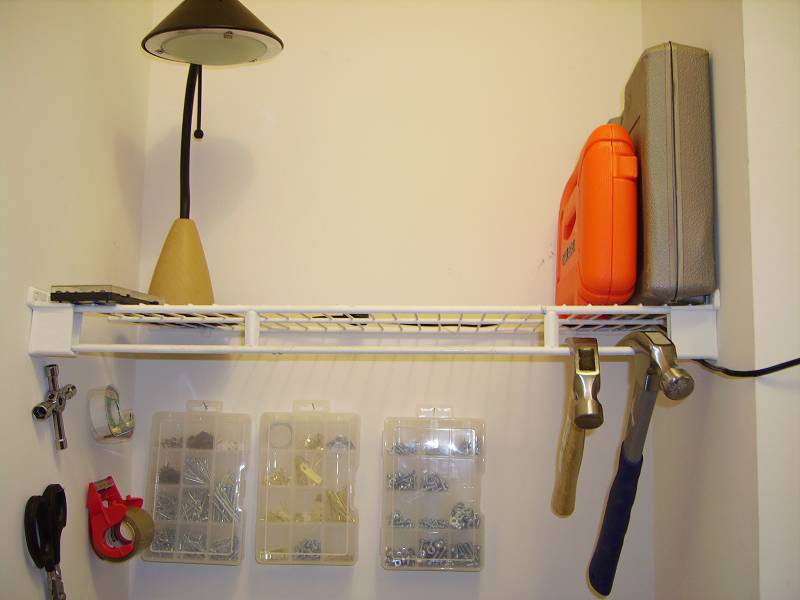

Two hours later and I have a workshop! Now if I just had my kit to put on the table...
I'm sure my landlord is going to appreciate all these holes in the drywall when I move out.

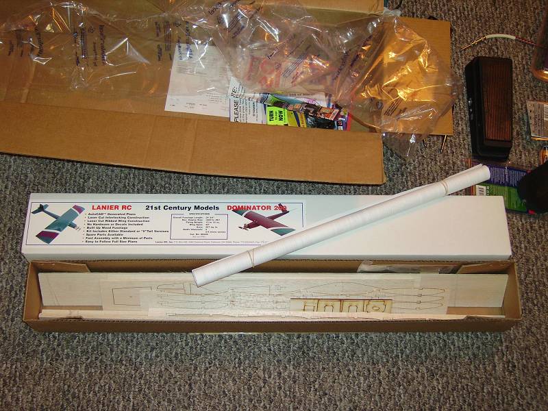

Speak of the Devil! Appearantly the UPS guy reads this thread, too. No sooner had I uploaded the last pictures than he kindly knocks on my door to deliver my kit. Not much wood in here. Just means I'll have it in the air quicker I guess.
Construction begins tommorrow!!!

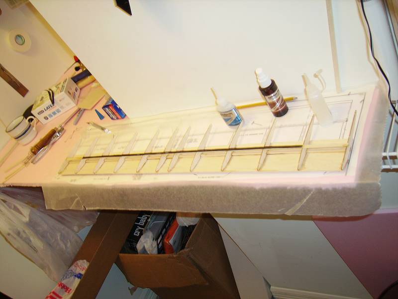

Finally had time after my classes today to start construction. A trip to the Home Depot got me a pink foam insulation chunk to use as a building board.

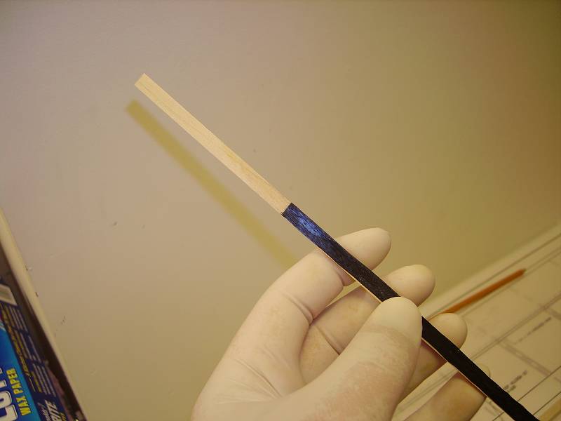

As stated earlier, one of my many mods is carbon fibre on the spars. I had also said earlier that there was no plywood in the wing, the spars are hardwood (basswood, I think) and the rest is balsa. The CF really improved the strength of the spar. Stock, it is VERY flimsey, and only 1/4" x 1/8".

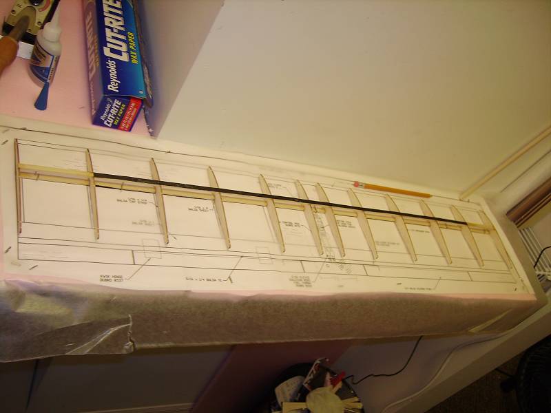

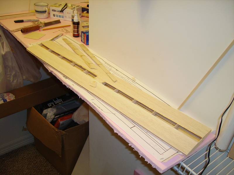

Wing here in the bones. Builds right on the plans, very straight forward constuction. Kudos to Lanier on such a fine job with their laser cutting. Second picture is wing inverted, begining LE sheeting.

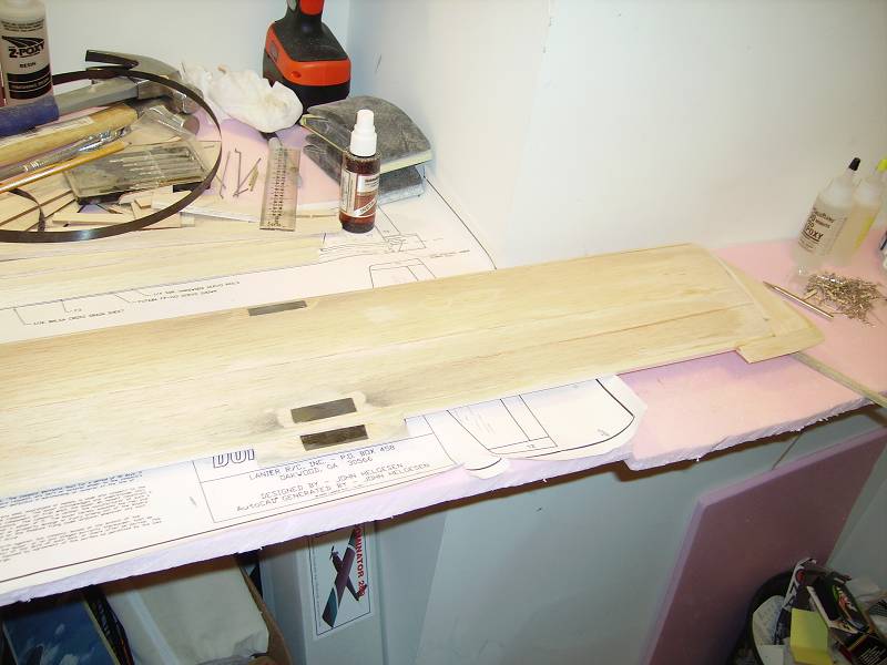

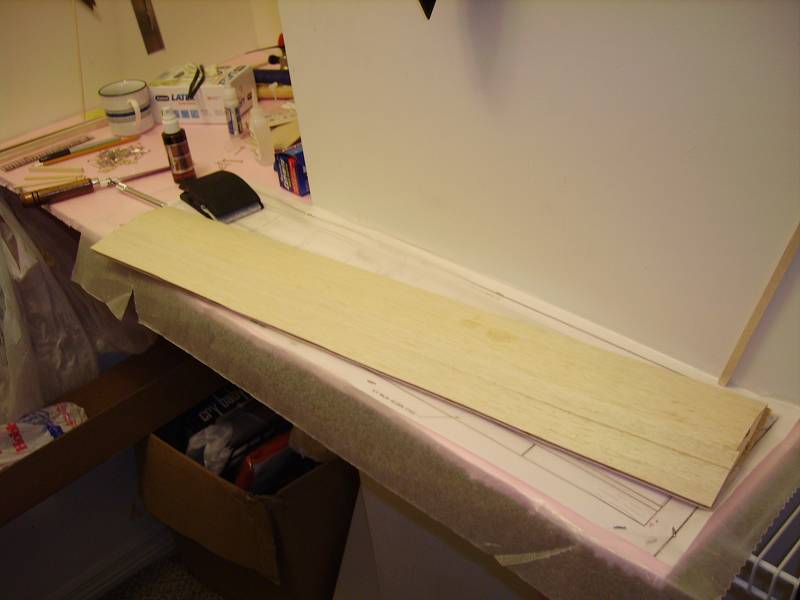

The second of my mods is visible here- a fully sheeted wing. I thought maybe I could add some more strength as well as smooth out the airflow and lose some drag, too. The second picture is right after I realized i had forgotten to put in shear webs! I hated to do it to such a smooth sanding job, but I pried up a strip anyways and installed those webs.

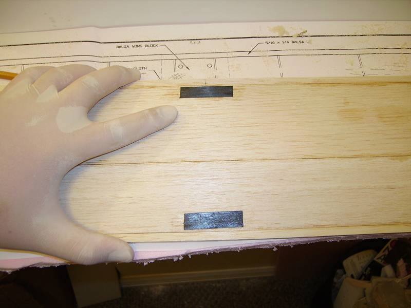

More mods- Carbon fibre around where the bolt holes will be drilled. Also an end view. Very thin airfoil- going to be quick!

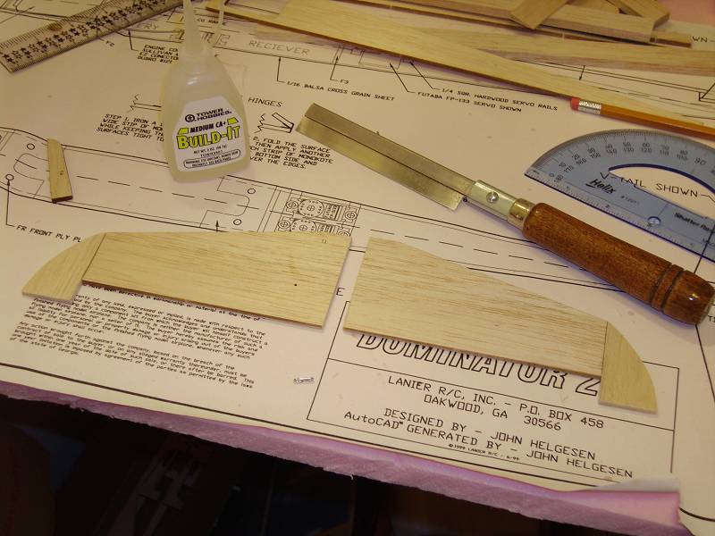

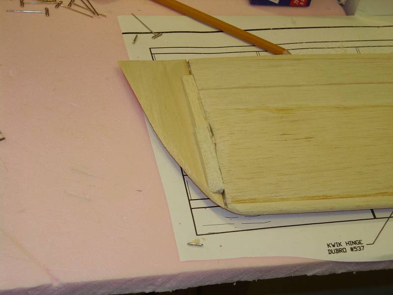

Mod #4 here for ya. I didn't like the idea of a draggy flat wing tip, so I changed it up a little bit. I have to fibreglass the center of the wing, and will probably do the same to the tips, since they are so delicate, I'm thinking about glassing the whole wing and painting it- maybe even the whole plane. What say ye? Good news! I found a Dave Brown .10-.15 engine mount that will just barely accomodate the .15 CV-A, and is small enough to fit on the miniscule firewall.

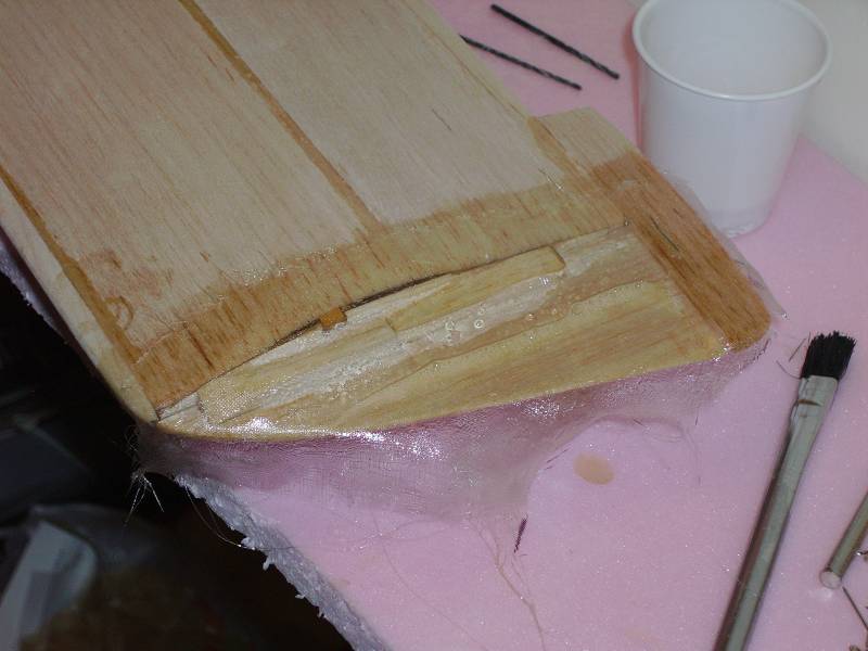

I started with the tips, because they will be the hardest and take the longest to get the least done. I'm guessing two days for the tips (a full night to allow the resin to set up, done one side at a time) and an additional two days for the wing glassing before sanding begins. I'll do the ailerons seperately and then hinge them conventionally, unless I can figure out how to do a seamless hinge line. I read something about that recently, but don't recall what or where. If anyone could lend a hand in pointing me to that info I would greatly appreciate it.

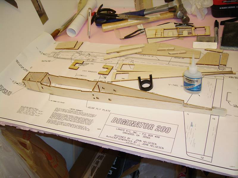

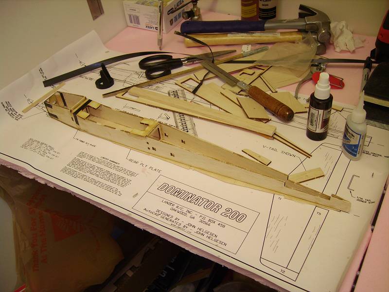

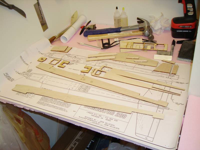

The fuselage construction is self aligning and straight foreward. You just tape the rear together, pop in the formers, rubber-band together the front end while the epoxy dries around the firewall, and start drilling the holes for the mount. As you can see from the pictures, the mount I got to hang onto the engine leaves no extra space on the firewall, but with a little shoe-horning I think I can make it happen.
