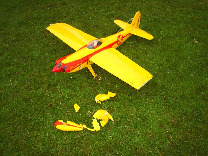

well guys i changed the prop on it and got it clocked again this time it was 123.5mph. I then had a little bit of bad luck and clipped a wing tip on the ground while it was being clocked at 101.3mph the surprising thing is it didnt destroy the airplane all it did was clip both wing tips. i will post pics of it later. THIS IS ONE TOUGH AIRPLANE!!!

the .91 is lighter then the G90 thats the only major difference that i know of. I was using a 13x7 apc prop when it was clocked at 123.5 when it was clocked at 109 it was a 12x8apc.
here is a picture after i hit the ground at a clocked speed of 101.3mph this thing is strong!!!
