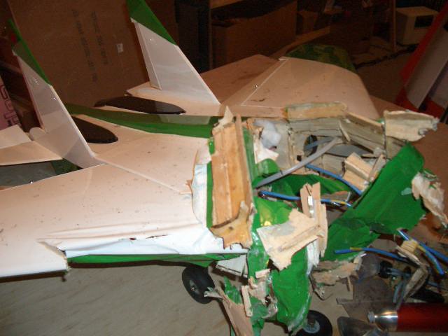

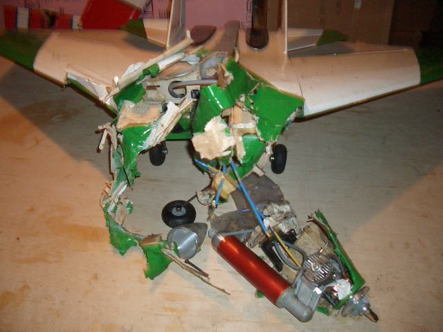

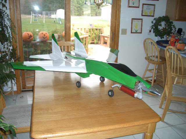

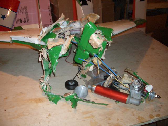

Heres the before and after, no real explanation of what happen it rolled inverted and went into an uncontrollable dive now what to put the 90L in.

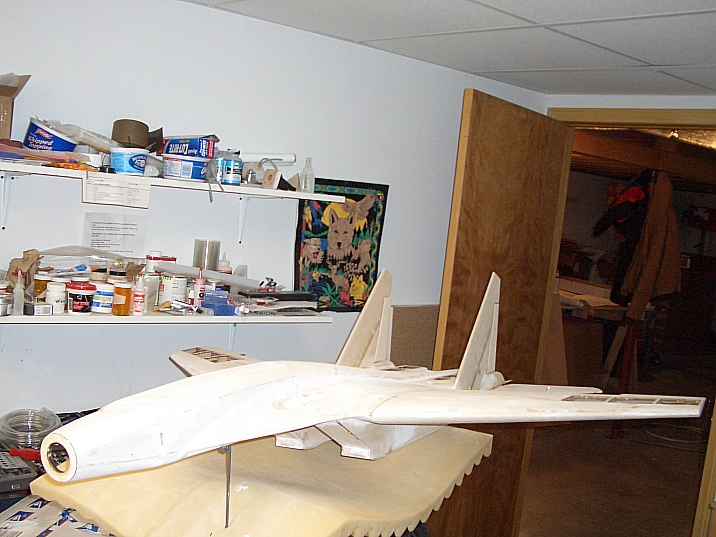

sorry here is the before picture

I actually have thought about building a classic pattern ship but that will have to wait until winter, summer is too short up here to waste in the shop. Other than the loss of the airframe everything else appears to be fine the ground was soft so the jett looks too have survived just fine and all the radio gear being in the back came through OK also.

You may want to replace the prop stud on your 90. just in case there is a slight bend you can't see.
Also check your Rx and Xtal, Use an engraving tool, put the tip on the case to vibrate it and see if you get any glitches.

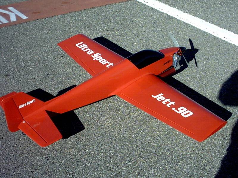

Well, "I FEEL YOUR PAIN.". But sometimes a better setup can come of it. I stuffed this F20 on its maiden flight due to flutter on the elevator. After trimming it, I went way out their and throttled it up and there I was, balls to the walls at a 45 degree angle and never came out of it.
I took the engine out and what was left and found and old ultra sport a guy did not want and rebuilt it and recovered it and has been one sweet combo for a couple years now
