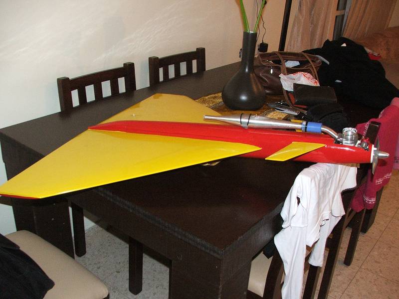

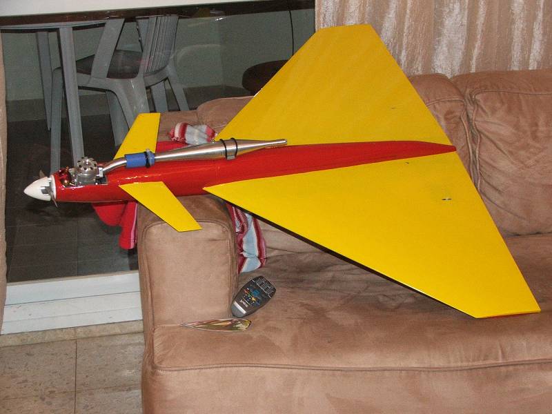

Well , after a lot of searching, and international phone calls i managed to get my hands on this beaut
it set a speed record of 180+ MPH in Great Britian, and was clocked at 234MPH during test runs
i built this kit and its almost ready to go

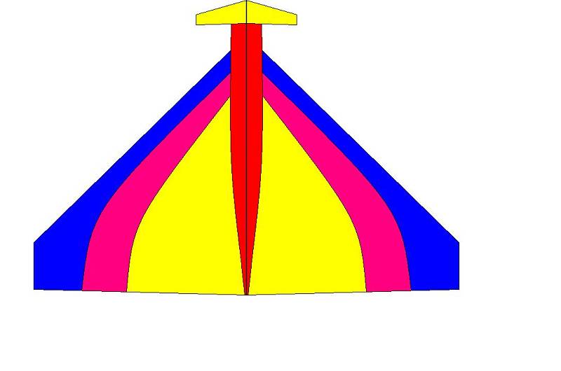

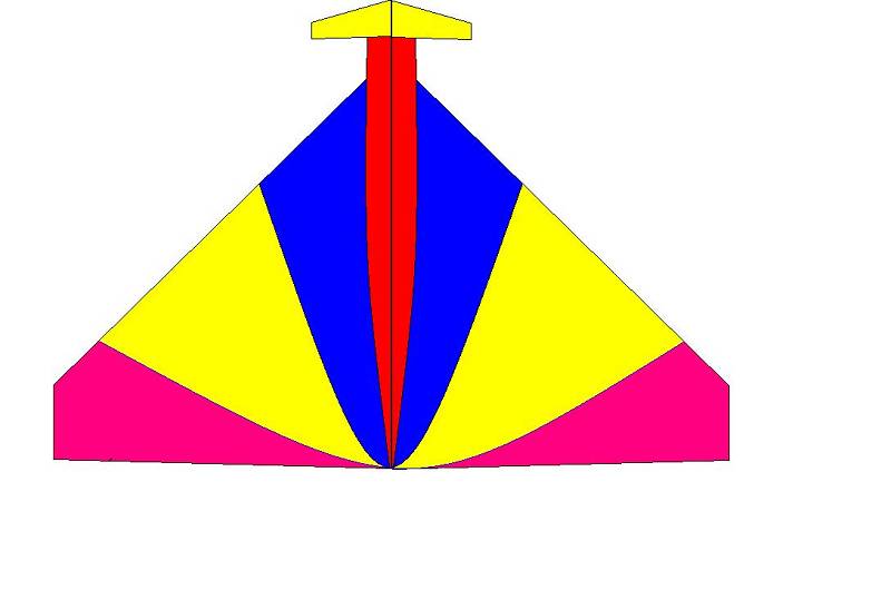

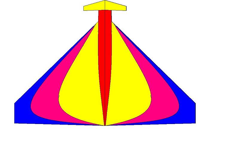

just got the 2 elevons to cover and 2 fins , and want to add trim to the wing
here is what it looks like so far and the trim i want to add, just cant decide which trim for now
if all goes well, test flight will happen on Saturday

THAT IS WHAT I AM TALKING ABOUT!
Nice--- Is that a Jett-60FIRE?

Sure would like to see that plane fly, but without the plastic spinner.

WICKED! How does she balance? Shoot some video!!!

I'm curious to know how well it flies without vertical fins? It seems like it would be very nose heavy, I'm also curious about that.

DOWN BOYS DOWN
i am not sure about a video, but i will try and get one for the day of the test flight

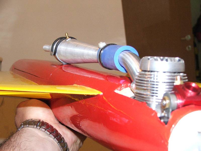

regarding engine - it is a tuned engine by Dub for high rev Jett 50 - he sent me the props as well as tuned the engine - rpm close to 22000 from what i remember , but will let you know
i am using a cut down 8.8 x 9.0 apc prop
obviously it has vertical fins - i wrote in the original posts that i have to cover them still
regarding the cg, it looks like it is pretty close on, the battery is right at the back of the wing , and the servos ( hard to see, are set inside the wings )
the feul tank is on the CG , and i was advised i might need a perry pump to get the flow from the wing to the carb
the only thing i am now trying to find a solution for ( without breaking the nice curves ) is a place to fit the remote needle valve - i am open for suggestions

go for the second trim scheme.

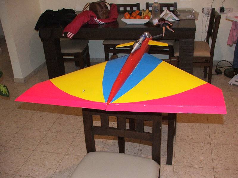

bad weather , postponed the test flight to next week
heres a pic before the fins were added
wing span is 37 "
profile is at its highest less than 1 "
the diamond dust is 1,5" at its highest point
total weight ready to fly is 1,5kg ( which is aprox 3 pounds)
