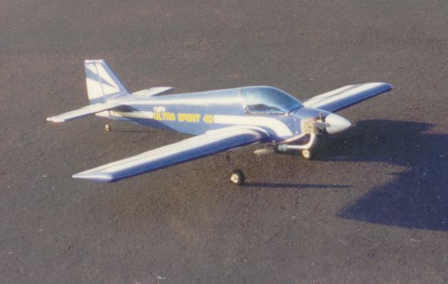

i need your guys help i have a sig kobra with a 32sx with tuned pipe and i am in desprite need to know what is the best size prop
to use to get max mph
thanks

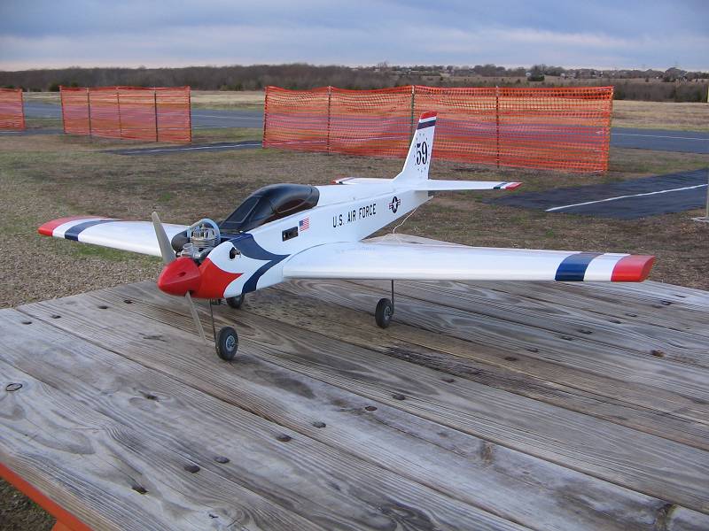

i used a OS32 (with a heli pipe) on a US40 and achieved max speed with an APC 9x7, took allot of runway to get airborne but top speed was clocked with a hand held at 104mph.
